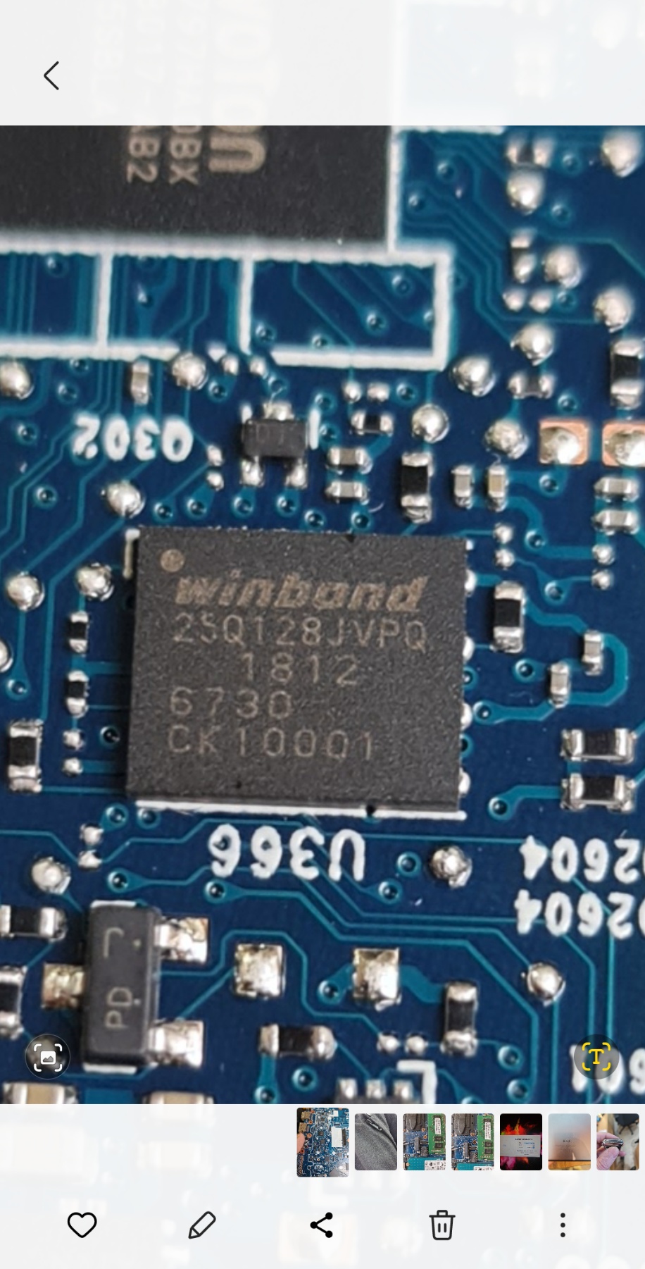

    Originally posted by Vesko356
    There's second (16MB) bios chip, upload the dump from this chip. Or use RCUnlocker to do it yourself.
    Is this the chip that I need to dump?

      Re: HP Elitebook 830 G5 Admin Bios Unlock
      Yes, that's it.
        Done with RCunlocker, thnx all
