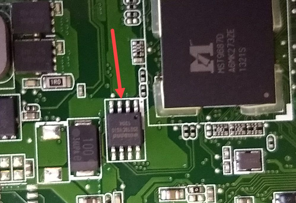

    Believe the FLASH memory device for this logic board Rev 1.3 is @ MEU1.

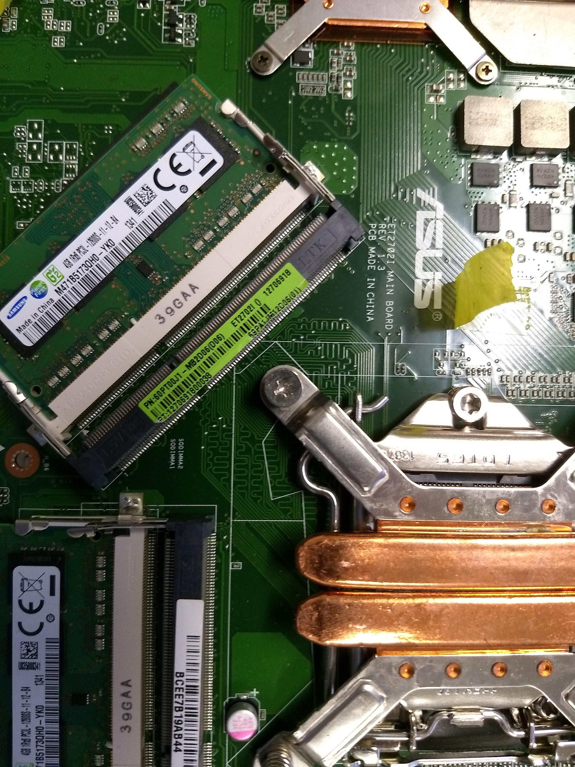

    Post the bios backup, and a picture of any white/green stickers on the ram slot with a barcode on .

      Re: Asus ET2702I Bios Rev 1.3 BIOS request
      Thanks. Here you go.

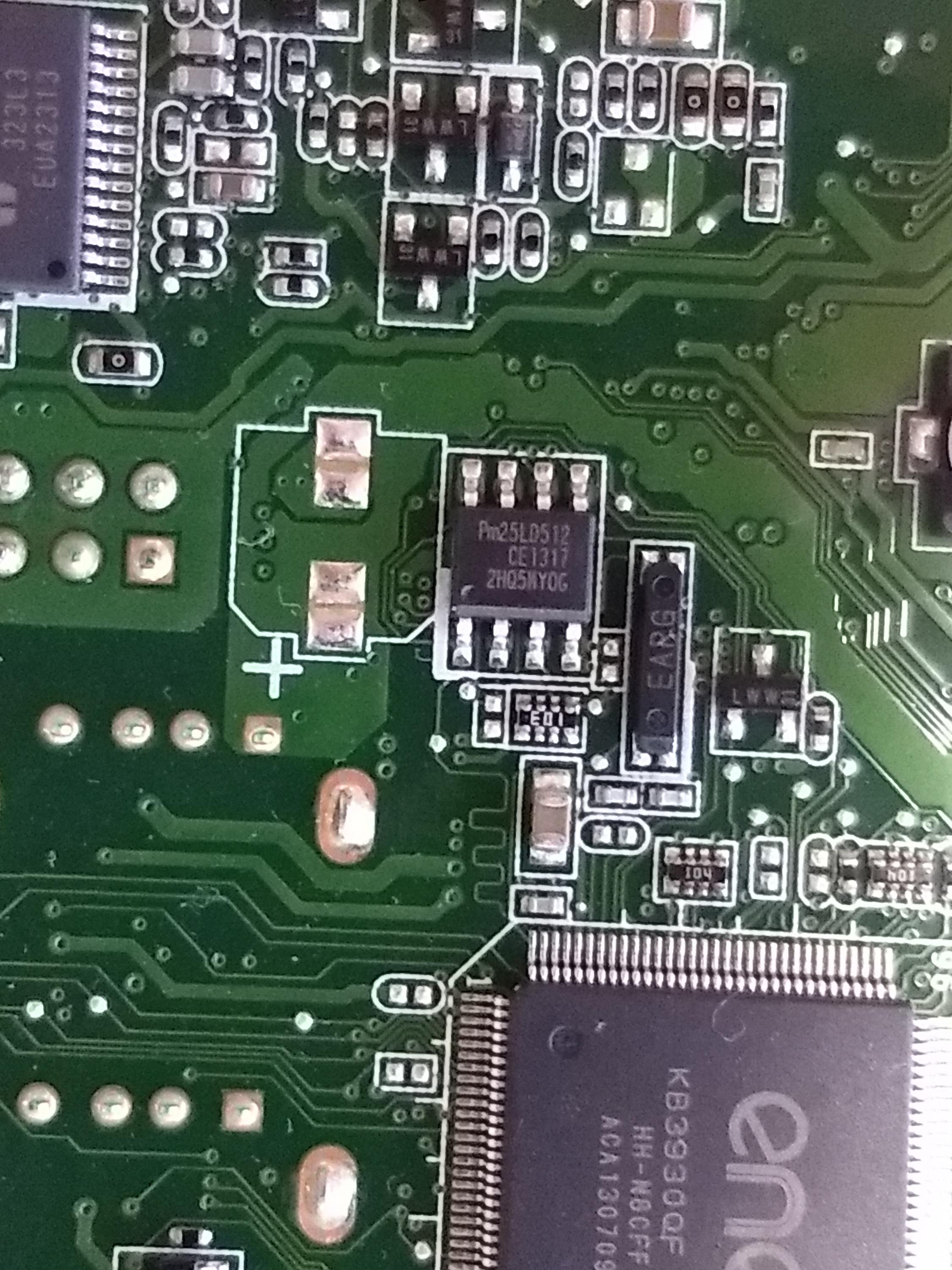

      Given that the GATE of mosfet PQ8907 has no signal with the ON / OFF button being pressed - would it be logical to reflash the multiple devices onboard to repair this logic board ?
      Found all 3 of the flash devices.

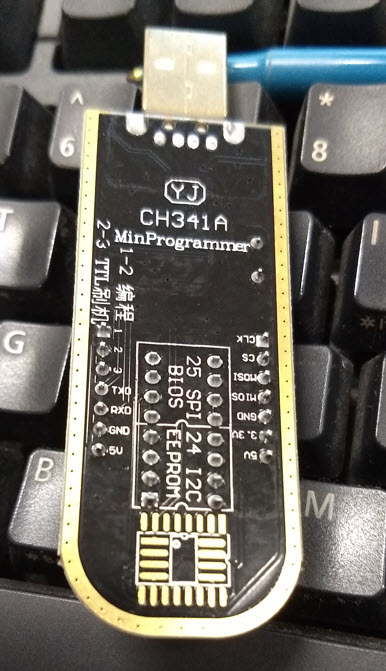

          Thanks SMDFlea. Need to locate my programmer - actually have not yet used the one we purchased (CH341A based). Will do this on Monday. Many thanks.

              Hi @SMDFlea. Found my programmer
              Is it ok to use the BOTTOM side SMD pads to dump / program the orginal SOIC device(s) ?

                I don`t know as i don`t have the CH341A black PCB versio,mine are the older ones, green and blue,the pads are on the top but i always use adapters. Just check that the pins are going to the spi 25
                Voltage mod -https://www.chucknemeth.com/usb-devices/ch341a/3v-ch341a-mod

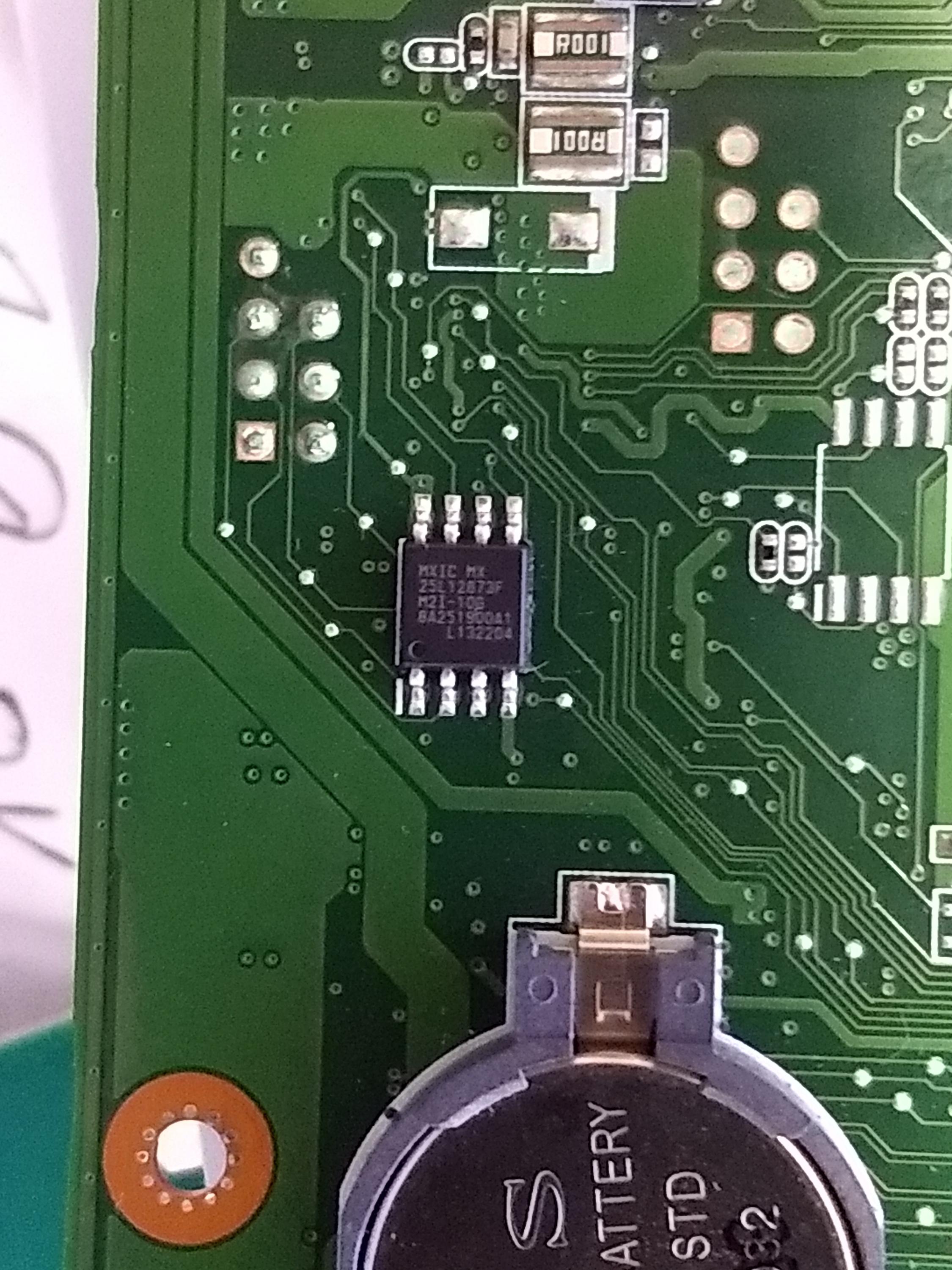

                  Thanks. Finally was able to dump it. Had to modify this BLACK PCB to support +3v3 flash devices. As a default, it is 5V only and can fry the device. Google is my friend
                  Dump of the MACRONIX MX25L12873F
                  Welcome your feedback.

                    Here you go

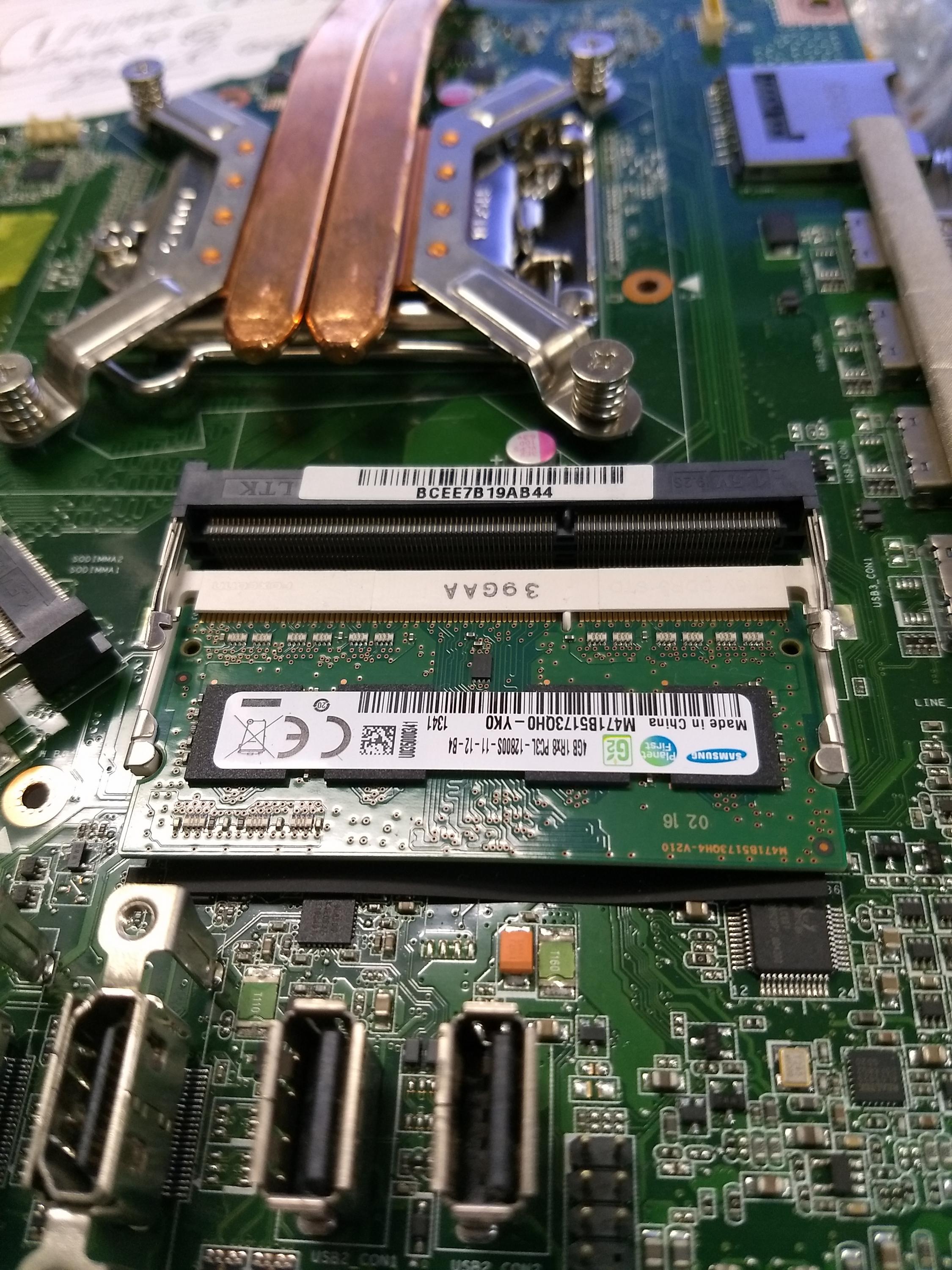

                      Hi everybody and especially hello SMDFlea,
                      my ET2702I (Board Rev. 1.4, not like this 1.3, 16MB flash chip is a 25Q128FV) suffers from the same problem. Is it enough to replace the "PT1270691800" and "BCEE7B19AB44" with my respective identifiers in the cleaned 16MB file and flash it onto my system or is there more to edit?
