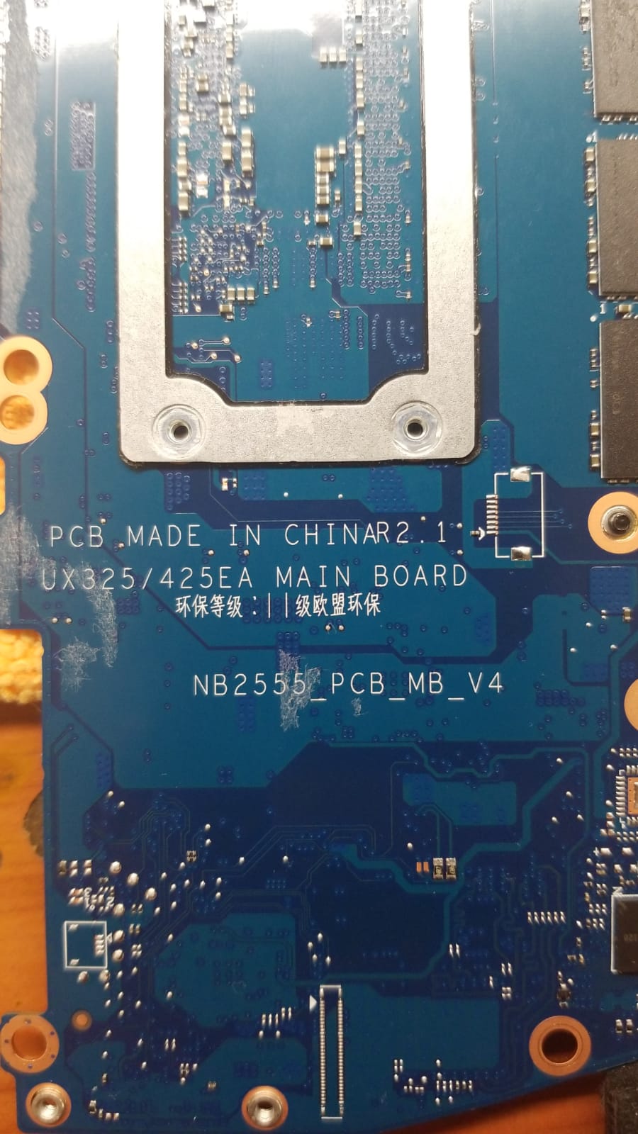

    Hello every body
    need help : when laptop make a BIOS update it shutdown suddenly then after turn it on blank screen .
    this details of M.B. :
    PCB MADE IN CHINAR2.1
    UX325/425EA MAIN BOARD
    NB2555_PCB_MB_V4
    • 21577
    Re: Asus ux425e bios
    Originally posted by huss584
    Hello every body
    NB2555_PCB_MB_V4
    Post your backup and a good clear picture of the white sticker on the motherboard,it wil have either a barcode or QR code on it .
    • huss584
      Hussein
      • Apr 2020
      • 229
      • Palestine
      I Don't have backup file for the original
      attached Picture

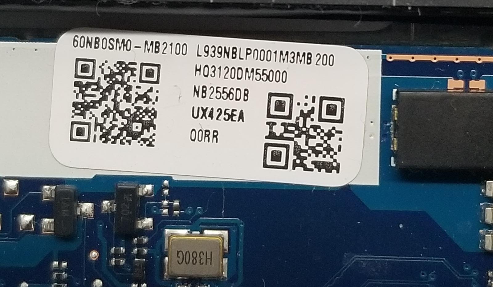

        Is there a sticker with a barcode or QR code on it
        • huss584
          Hussein
          • Apr 2020
          • 229
          • Palestine
          Attached Picture
