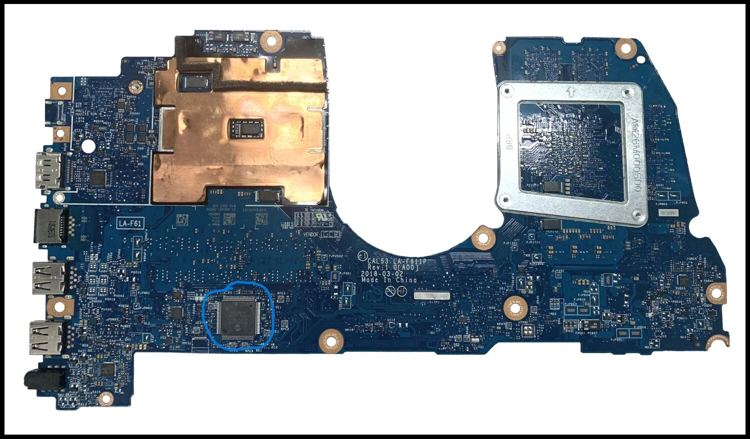

      Do you have EC CHIP backup??
      • Kaasis
        • Feb 2021
        • 18
        • Latvia
        I only see EC Controller, no EC Chip.
        if I'm not mistaken, the circled part is the EC Controller
        Click image for larger version  Name:	High-quality-CAL53-LA-F611P-For-Dell-G3-3579-Laptop-Motherboard-I7-8750H-GTX1050TI-4GB-DDR4.jpg Views:	0 Size:	295.3 KB ID:	3328573
