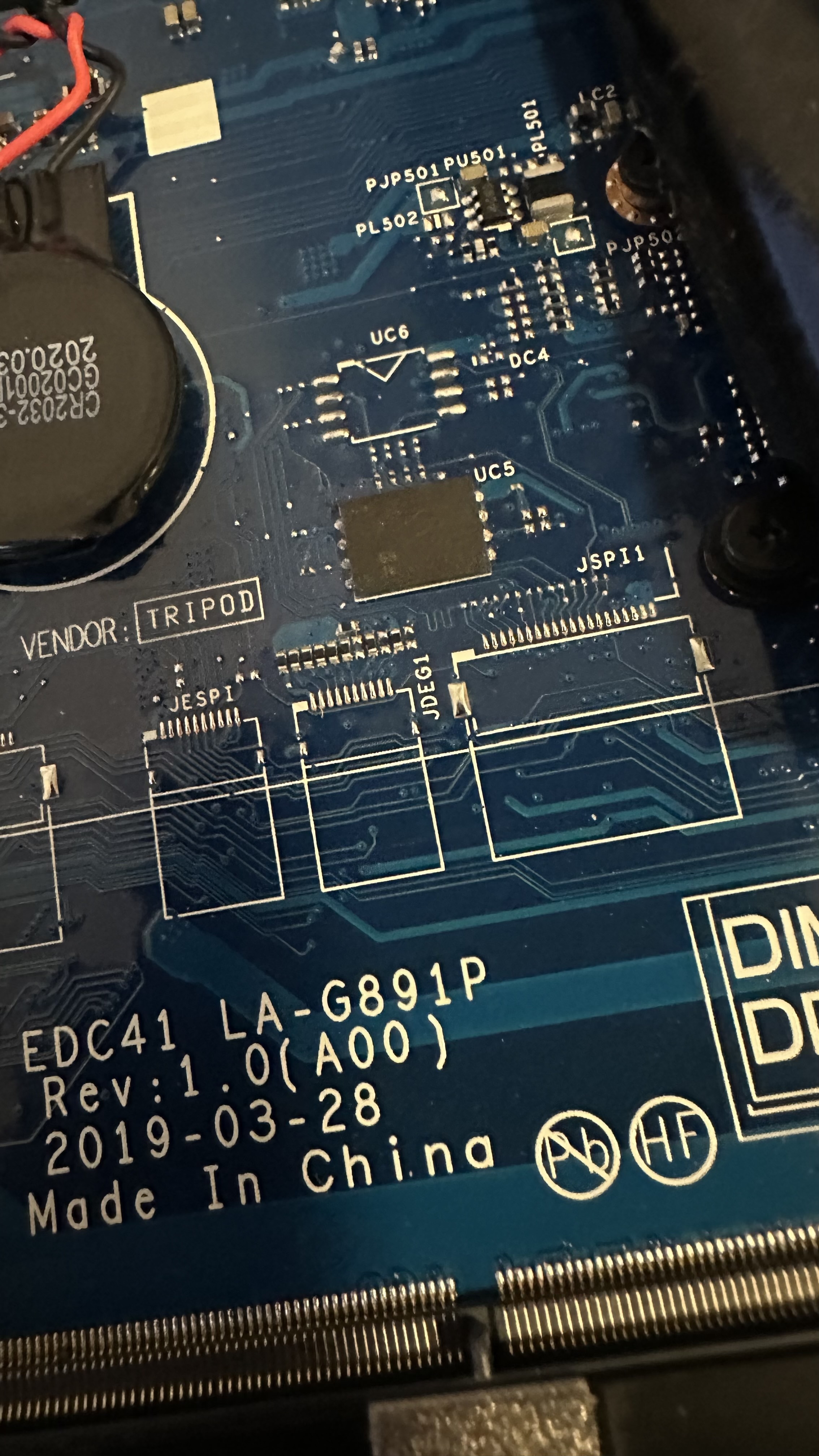

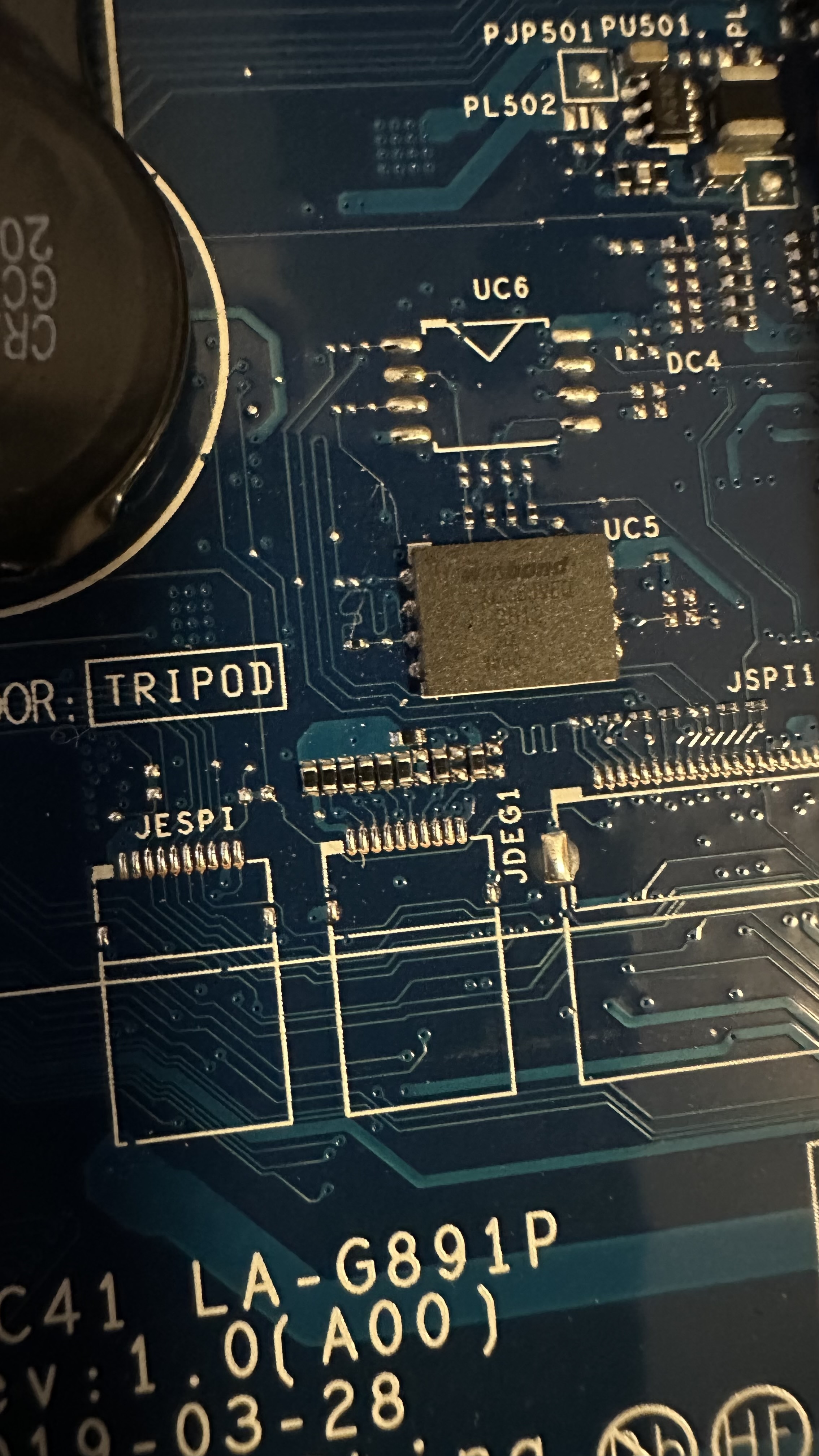

                              I tried to remove the BIOS password on my Dell Latitude 5400 using the patcher.
                              Got a the bios dump with the programmer
                              And unlocked it with the patcher
                              But now whether I upload the initial dump or the unlocked dump, when I connect the power, the front led is white, the power button and the keyboard lights up for 1-2 seconds, the fan also starts for 1-2 seconds and it keeps repeating.
                              Please help.
                              Service Tag: J9XQ433
                              Board: LA-G891P
                              Thank you very much!

                                You copied the bios with errors.
                                The bios chip must be unsoldered from the board before writing or reading..
                                do not use the clip, you may have errors..if you do not have anything to unsolder it with,
                                solder wires between the programmer and the bios chip..
                                .here is a video for example..https://www.youtube.com/watch?v=DWWi...nnel=ThisIsHow

                                  I understand, but since I copied the original BIOS with errors, after I unsolder it, what BIOS I should write on it?
                                  Can you help me with a suggestion?

                                      I wrote the BIOS on the chip using the WSON8 probe, verified it twice but still the same behavior.
                                      I don't have knowledge of soldering to try and unsolder it, but I suspect that I might have damaged the chip connections to the motherboard with the probe, hence I will try with a local service to have it checked.
                                      I'm attaching two pics of the BIOS chip for your opinion.
                                      Thank you very much for all the help.

                                        Hello you can try this new build bios from your corrupt original bios good luck ....
