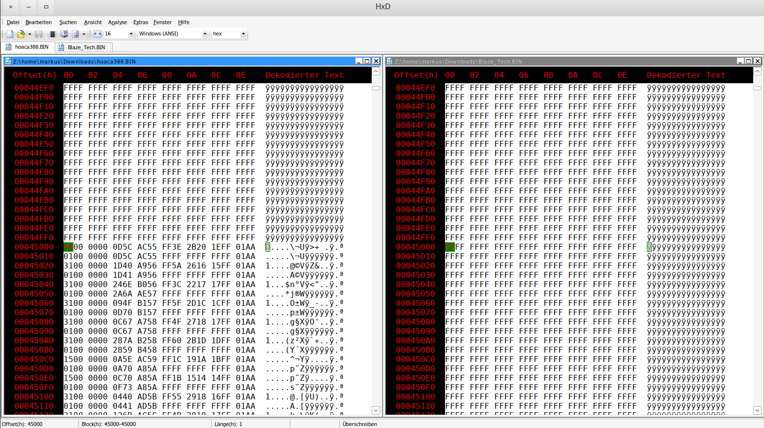

                    Hi everyone. I have same problem, bios locked. Two laptops. Tried to clear ME region and clear 45000 region. password is still there. Anyone can explain what to do? thanks. actually 2 locked dumps attached.
                      • 22141
                      #611
                      Read the rules in the sticky thread and post the service tags ! https://www.badcaps.net/forum/troubl...before-posting. Clearing the 45000 region does not always work.Compare a locked/unlocked bios with a hex editor and you might be able to work it out
                      • lxrepairs
                        • Dec 2016
                        • 12
                        #612
                        Thanks for your help. Anyway somehow clearing 4000 bytes starting from 45000 address worked. I was doing it a bit wrong. youtube video if someone needs. https://www.youtube.com/watch?v=UAxdl59j7u0

                                    #619
                                    I followed the instructions in a youtube video to edit the hex code and it worked!
                                    Here is the youtube video:
                                    https://www.youtube.com/watch?v=B2a2sjVBxx8
                                    Here is the equipment I had to purchase from amazon to read and write to the BIOS chip:
                                    https://a.co/d/clgLK95
                                    https://a.co/d/8W5zZsg
                                    Good luck future knowledge seekers!
