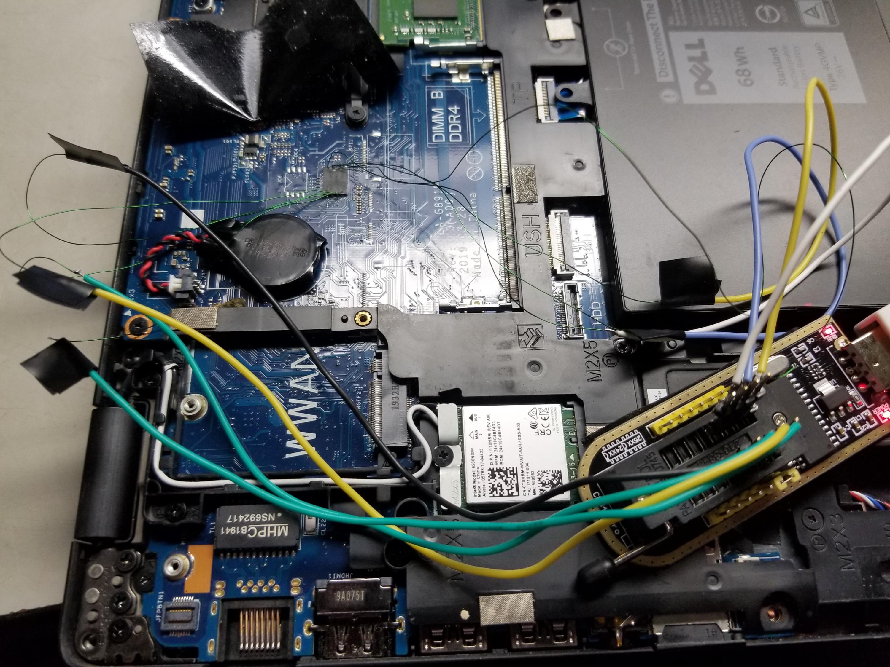

          hi,i have a pickle here. i did many bios dump of 5400 lats and used the methods here to unlock them but this one i have will not allow me to dump. it has a 25b256DYIG smd bios
          and it halts every programmer i put it to. the ground seems to be the culprit or pin 4.
          i use direct wire soldered to the solder blobs then wire to the programmer.
          its a LA-G891P rev1.0 board with the 23VPXY2-8FC8
          is my bios chip fucked? it still turns on and allows me to get to setup.

            Hello, what programmer are you using?

              so far i used the common ch341 and the blue one v1.7 with voltage select. both freeze the neoprogrammer and the ch341 the moment i connect to usb. used the clip side then the headers. i disconnect the ground wire it unfreezes but then i cant read the chip.

                Did you desolder the chip from the board or are you reading it soldered? If so, you must remove it from the motherboard and read it out.

                    i reinstalled the wires for a 4th time for some reason to see if i could try something diffrent and the ch431 acted normal and i was able to dump the firmware!
                    no idea what i did diffrent i suspect a witches spell for that day but thanks everyone.
