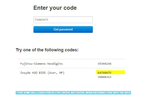

    Does flashing the bios of Acer ES1-132 removes the password? Unit has bios password so there is no way to do a reset on it's OS. Windows 10 has password too, resetting by doing Alt+F10 requires more space since it's just 32 emmc storage. I already done disconnecting the cmos battery and the battery itself for an hour but no go. It provides a password code after 3 hits but it does help either. Any thoughts?
    I have RT809F flasher.
    Thank you.

    try the acer 10 digit unlocker https://www.badcaps.net/forum/showthread.php?t=84084
    Edit: if that doesn`t work post your bios backup

      Thank you sir. I tried to calculate the code 71802473 and the result is:
      f2fc129a0a428dbc
      But seems the character is limited in this model.
      I will back up the bios. Thank you for your help.

        HI SMDFlea,
        This site code calculator looks great. My code works here and I was now able to access the bios.
        https://bios-pw.org/
        Thank you.

          Check the code 71802473, does it remain the same? Try the passwords below;
          Brand: Acer
          Code#: 71802473
          Unlock password (old): 64760475
          Unlock password (new): 38452015
          Unlock password (new): 38452016
          Type the unlock password and press <Enter>.

            Thanks sir, I already unlock using the site above.
