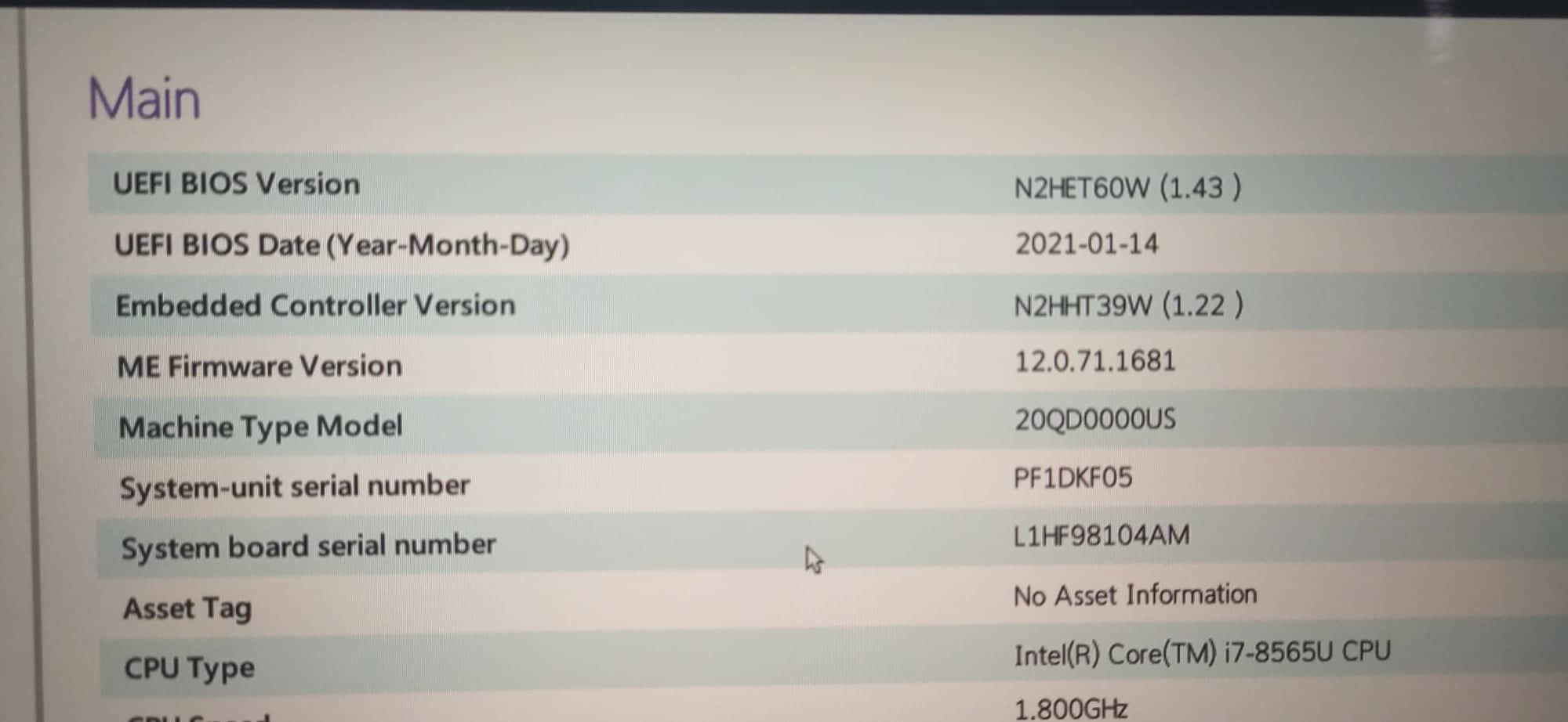

    Hello
    my old motherboard was Yoga 4th Mainboard i5 8th 8bg. not working.
    I boght a new motherboard , Lenovo X1 Carbon 7th Genw Intel i7-8565U, 16GB- 01YU368
    it is working good but shows a message on starting
    2203 system configuration is invalid
    press ESC to continue.
    i tried to update bios with the new version 1.45 but the message still
    please help
