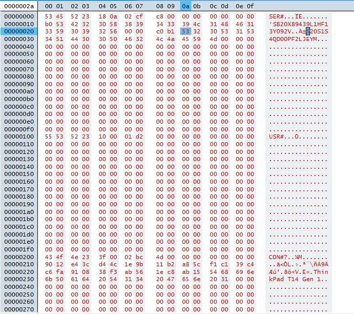

    I get "System configuration is invalid" on every boot.
    I updated Bios and EC, even updated mec with svod4 with dump from lenovo and afterwards initialized eeprom with U1 and entered new serial. All DMI data are correct in Bios. But still message on every boot.

    Here the dumps:
    POST SERIAL NUMBER/SERVICE TAG:-
      x16 check your information it matches
      ThinkPad T14 Gen 1
      SB20X89439L1HF13Y092V
      S20S1S4QD00PF2LJEYM
      ProductIdentify.efi
      2200 machine type and serial invalid
      2202 product name is invalid
      2203 system configuration is invalid ?? (I don't know what it corresponds to exactly)
      2204 system configuration data is invalid

        Unfortunately I don't have an original 256kb fulldump of EC, because all dumps with 256kb are empty. I tried 20 times, but only got dump with 00. Only the 2kb dump from eeprom worked. Original file is here.
        And yes i deleted line 300 till 350 because this is the area where password ist stored. Isn't it?

          have you tried a full init eeprom ?? and rewrite the information? same problem?
          can you try otherwise at the uuid level: delete and recreate another
          can you post picture of setup information (serial number and other)
          for password unlock just delete 300 to 34F, do not touch after 350
          test mod 0x350 if possible
