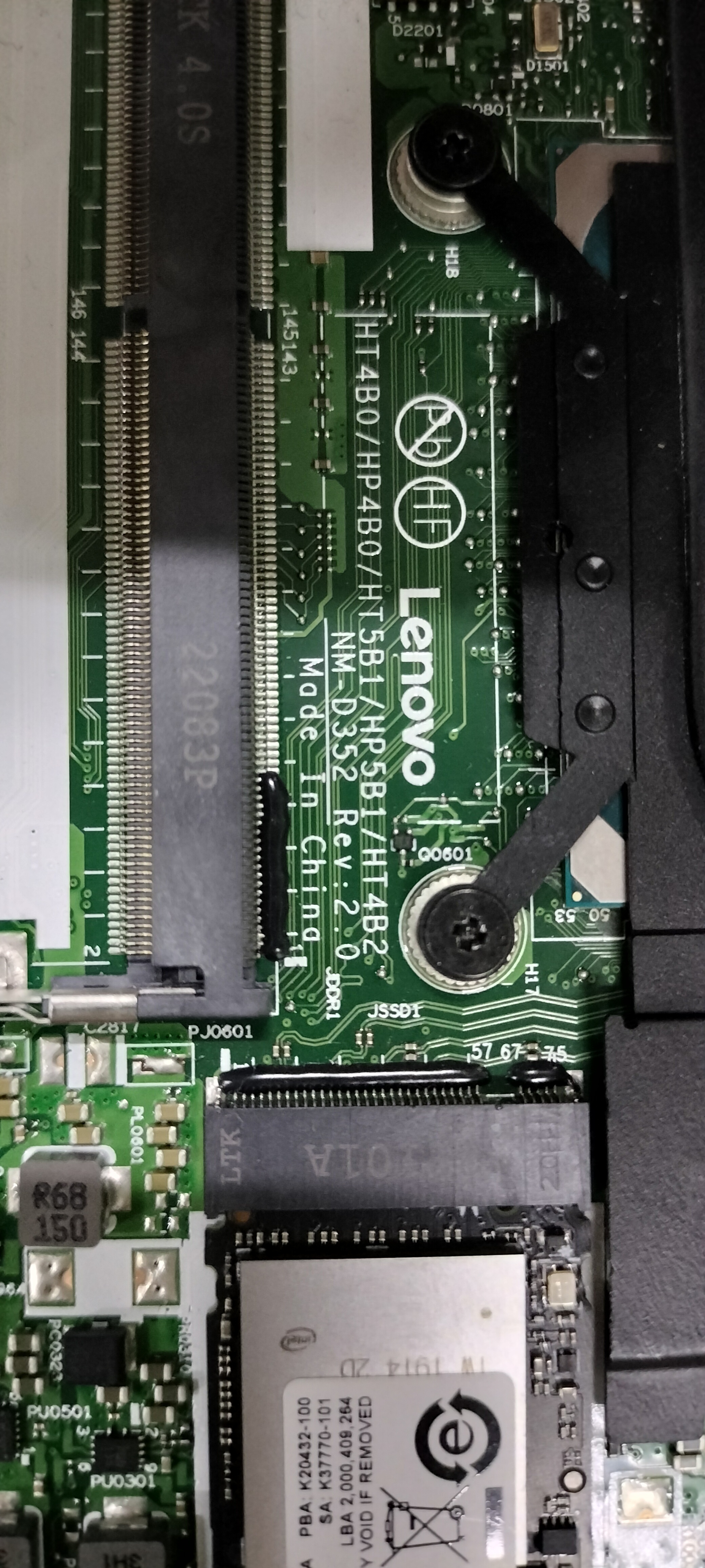

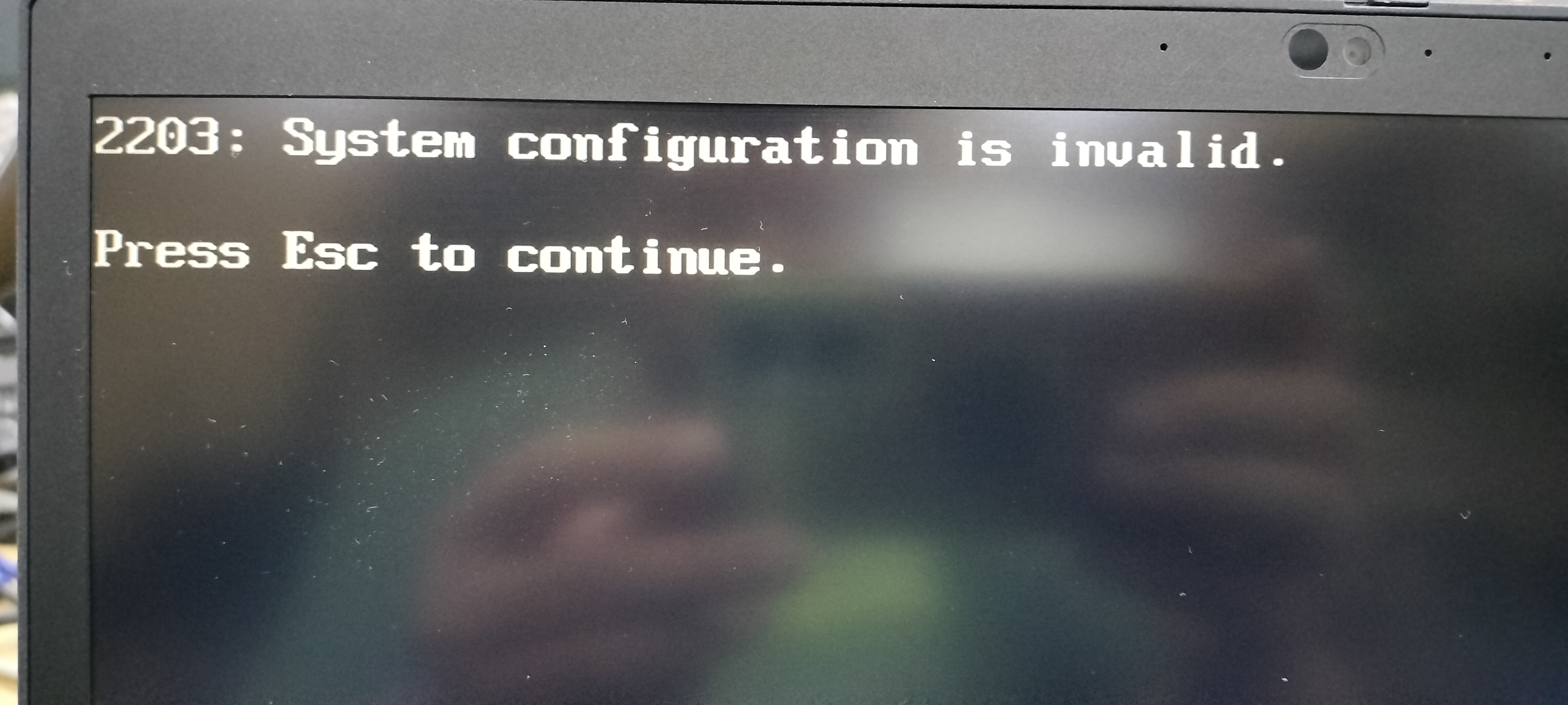

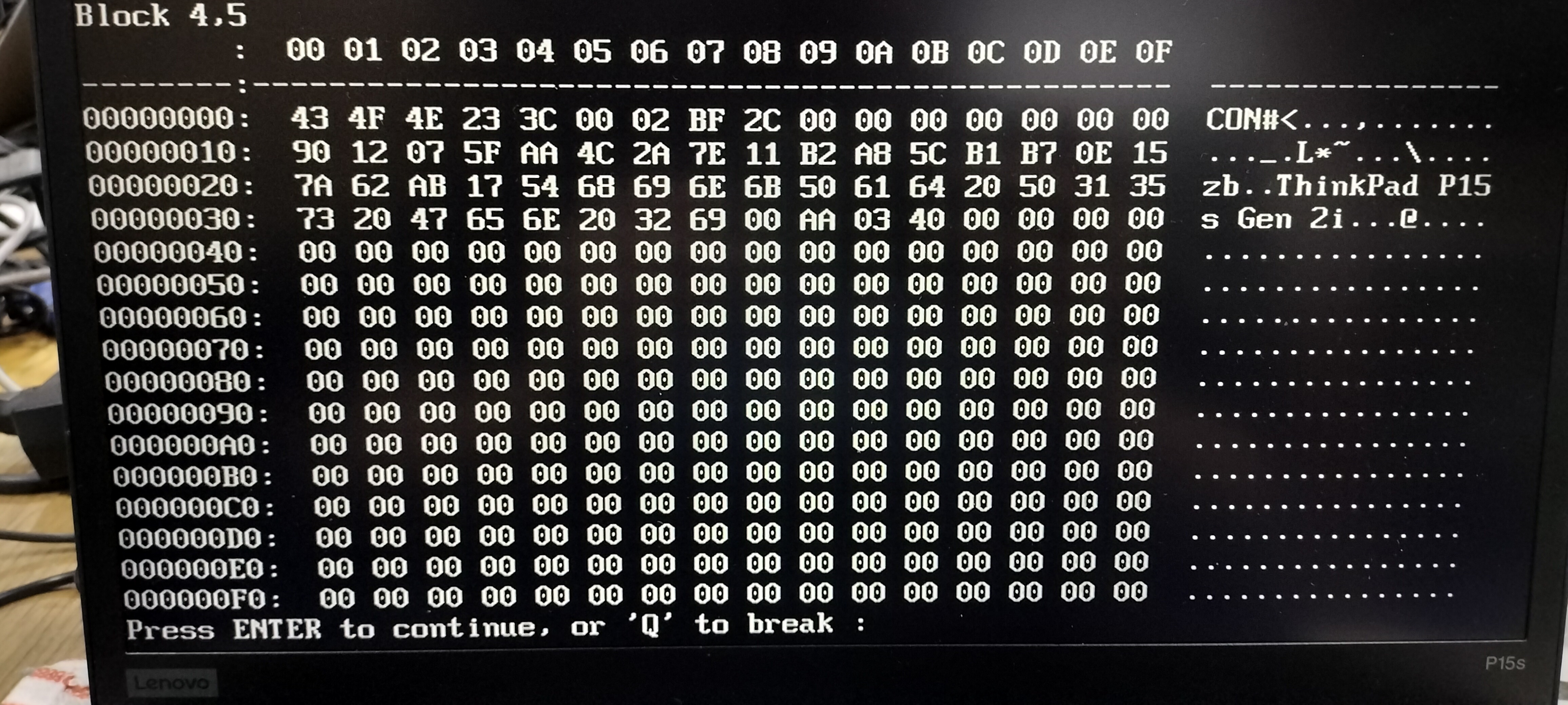

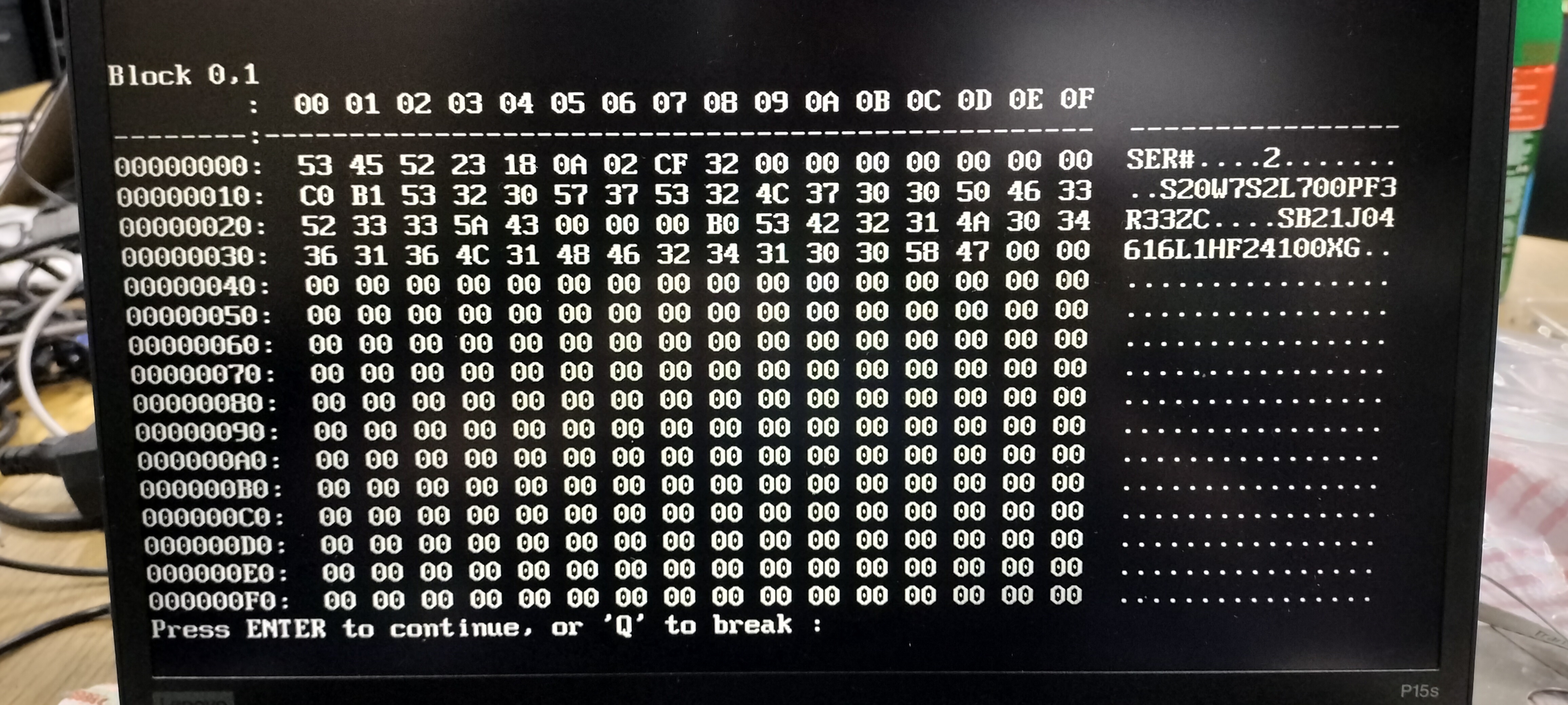

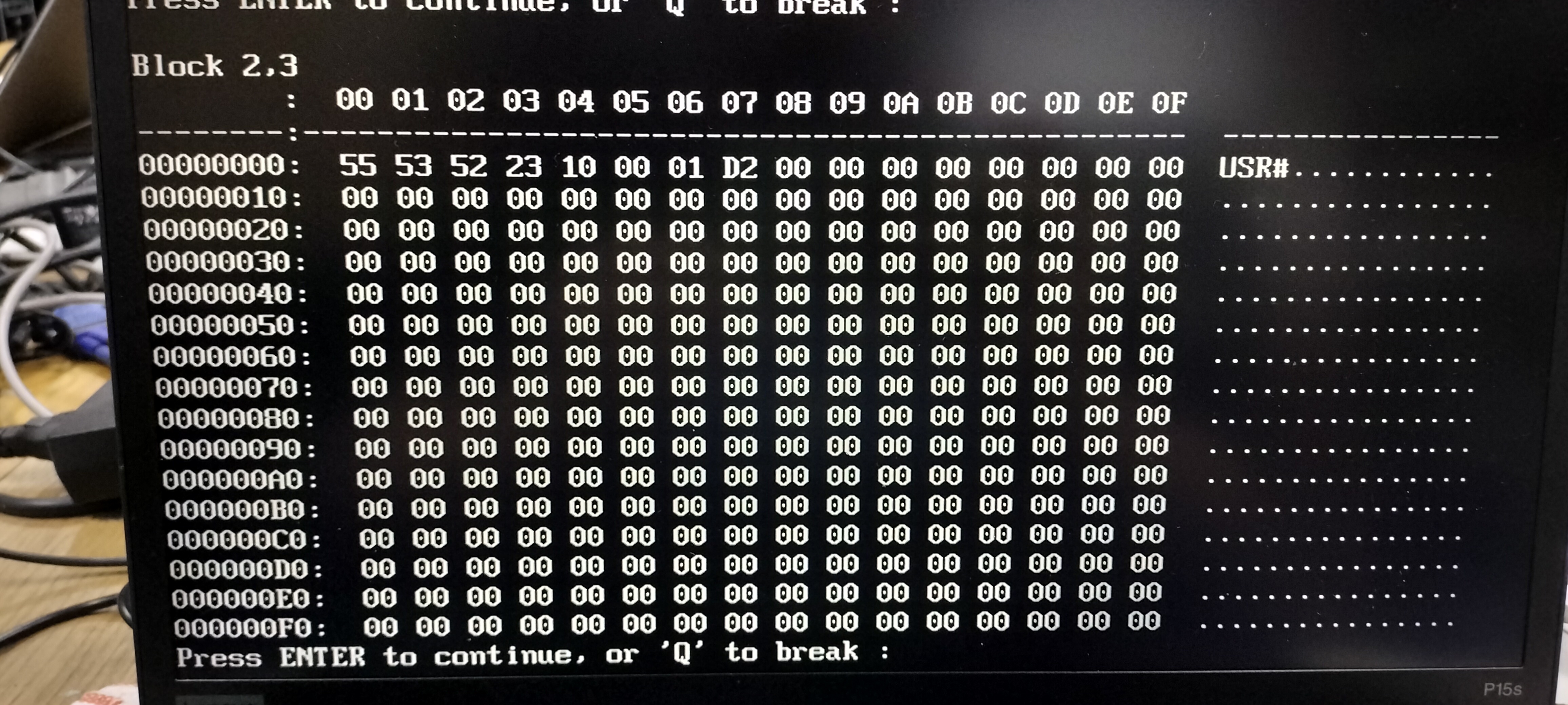

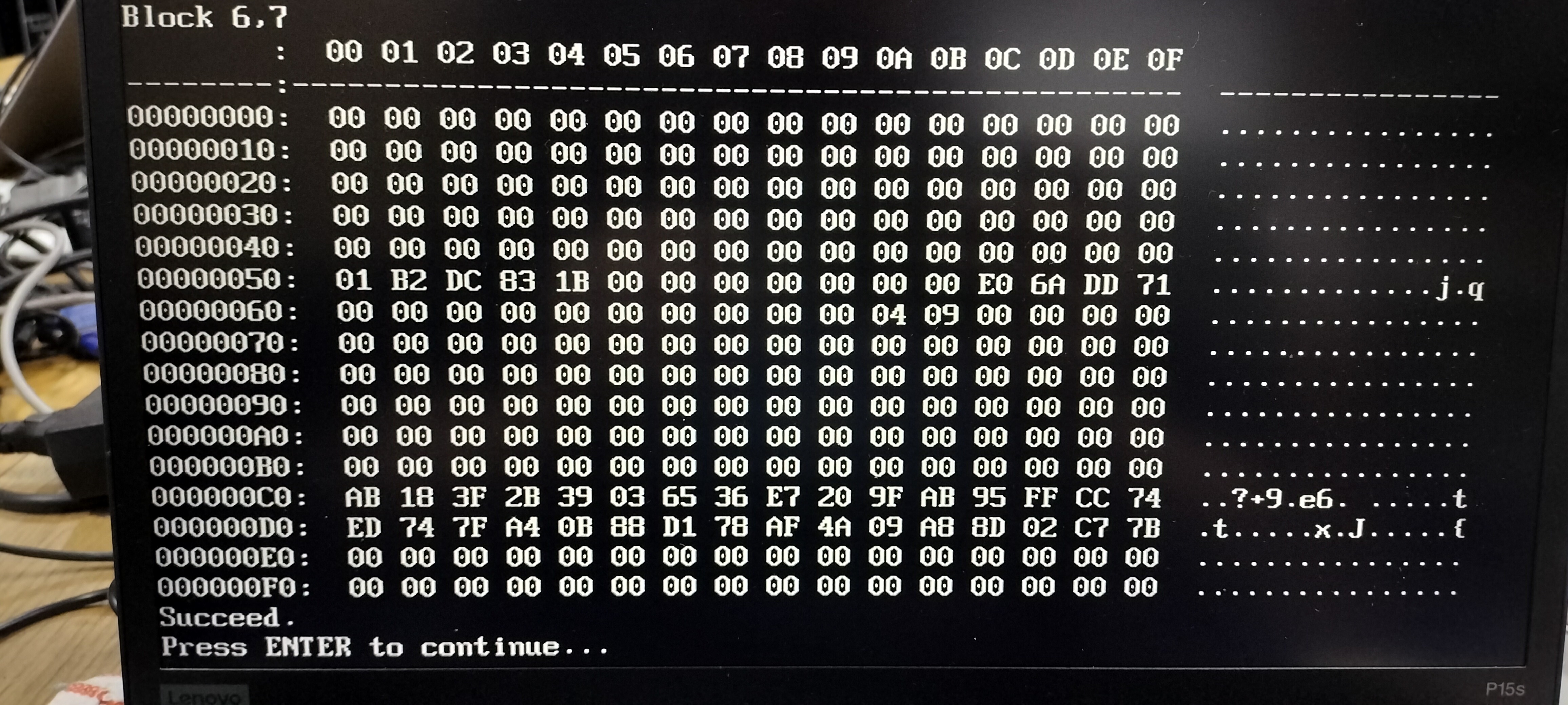

    I have an Lenovo ThinkPad P15s gen2 that keeps giving me this error 2203

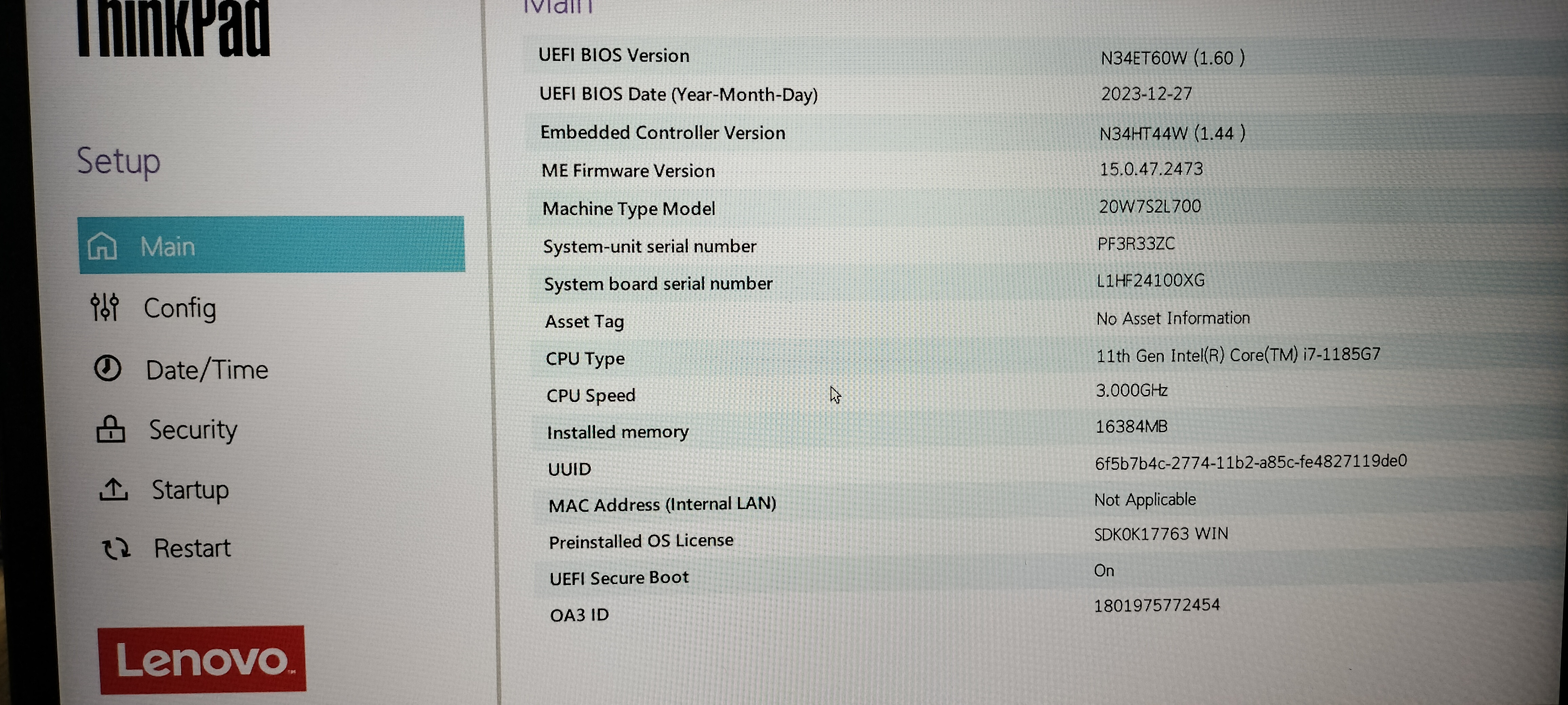

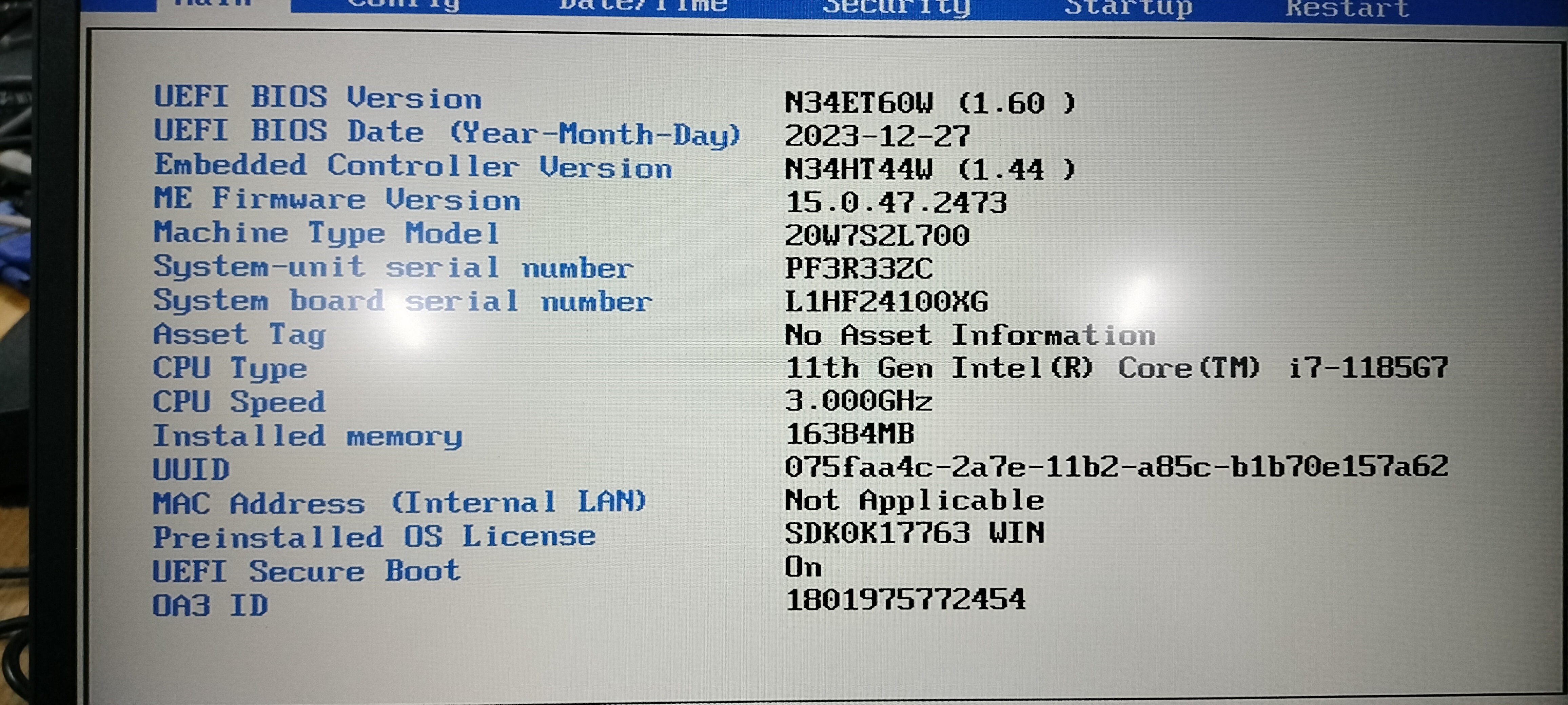

    I have used the Lenovo Gold Key U1 Tool erased the eeprom and enter all the configs again but I still receive this error
    I believe it to be an BIOS problem
    I will Attach bios dump and some screen shots

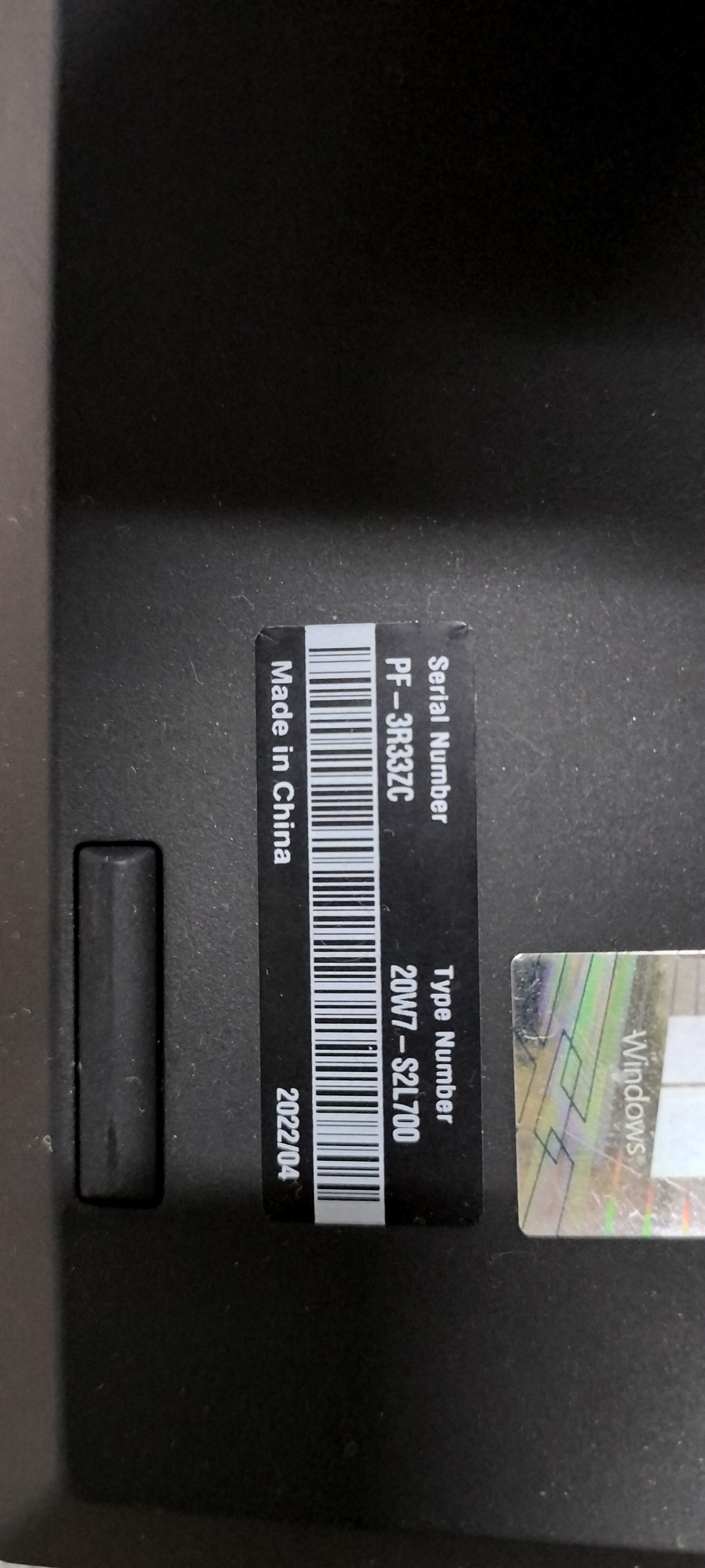

    Board number: HT4B0 /HP4B0 /HT5B1 /HT4B2 NM-D352 Rev 2.0
    SN: PF-3R33ZC
    Type Number: 20W7-S2L700

      Originally posted by SMDFlea
      I have tried that solution in post #1
      I change Brand Name I get error 2202: Product Name is invalid and error 2203: System configuration is invalid
      The only error I get now is 2203: System configuration is invalid
      There no info on error 2203
