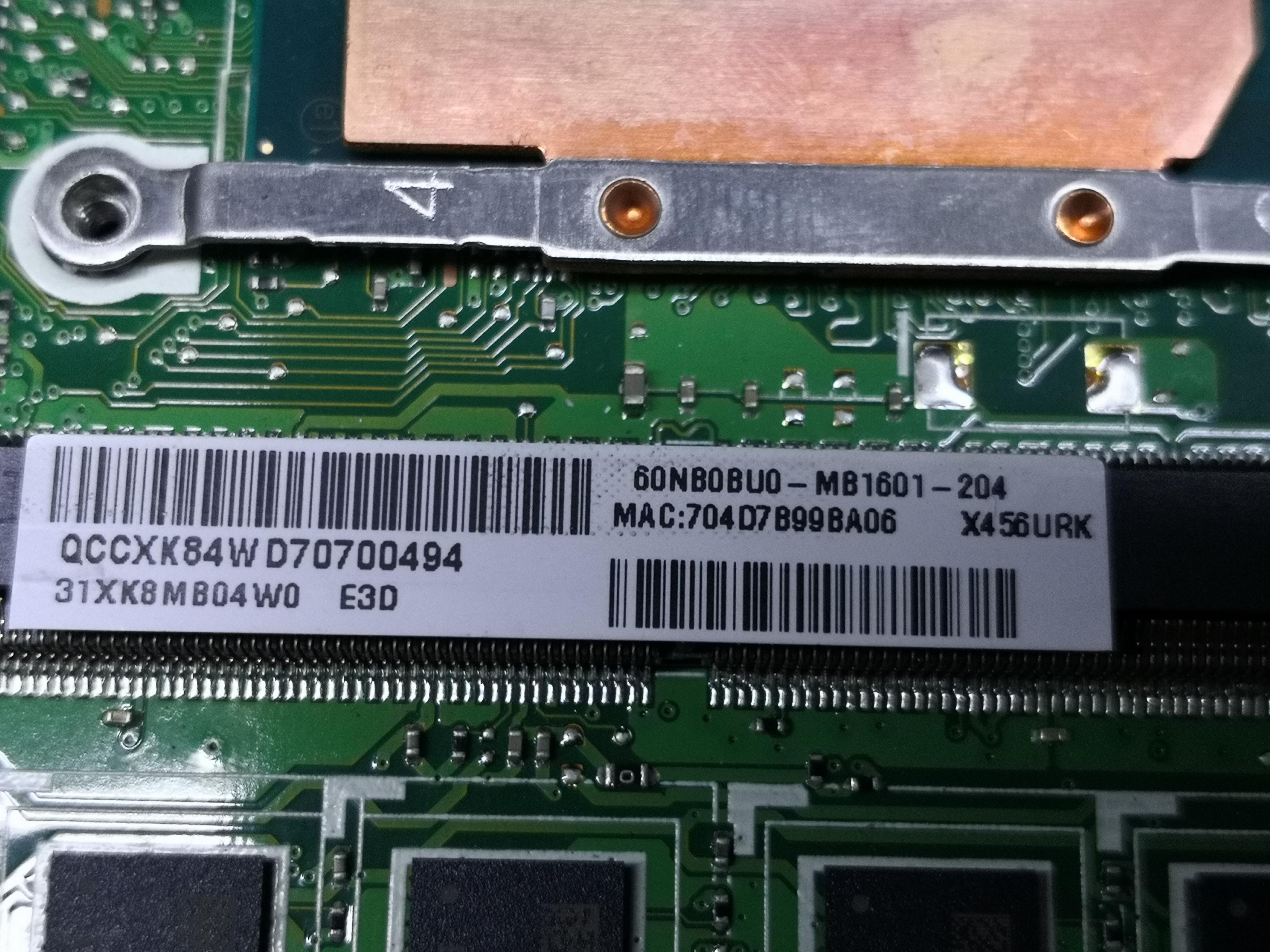

    Need bios for this asus board x456UQK rev.2. laptop cannot detect hdd.

    Post a good clear picture of the white/green sticker on the motherboard with the Barcode/QR code on it .Its usually near the ram slot

      Is it this

        Re: Asus a456u-rfa132t bios
        Try this one and report.
        Built with FIT, clean ME Region and Bios Region from Asus update. I am learning how to do this and really hope I did it right. The info in the picture helped confirm it is the correct bios.
          Hi Mazorca,
          The bios not working, power keep on/off and no display.

            Try this one .
              Originally posted by SMDFlea
              Try this one .
              Now can boot, but still cannot detect hdds. Guess it's not the bios problem...
