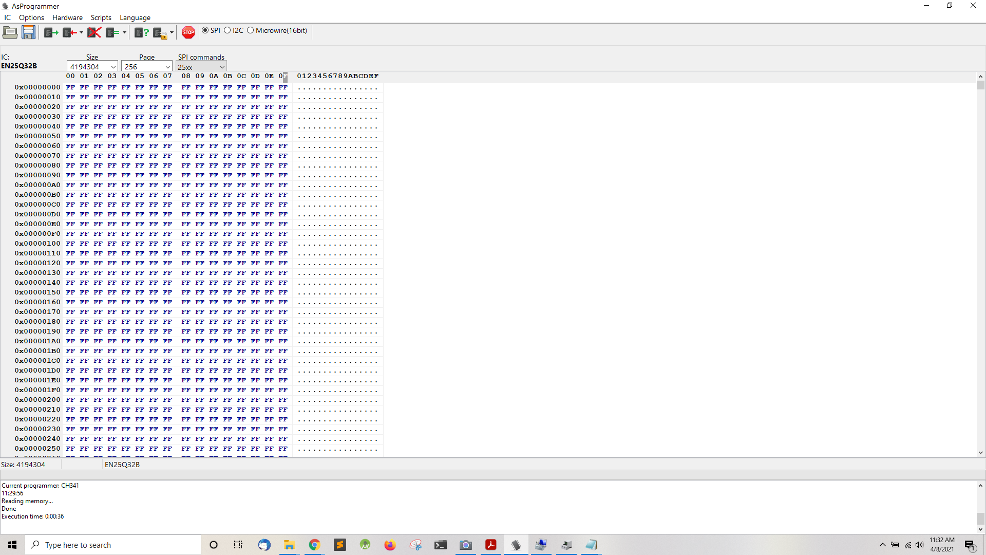

      A BIOS chip that has all "FF" means it's either erased or the programmer is not detecting the chip properly. The default memory buffer is all "FF" as well so it's not always easy to tell which it is. The error message you are getting might be telling you that the chip selection is not right. Double check or try the "Detect my chip" option.

          Re: Unable to Read BIOS Chip on Motherboard
          I have "verify ic" button? is that the one you're talking about?
          I click on that button and it seems to be reading the ic and then it gives me all F's
            I tried "read ic" button the one with "?" mark and it is not detecting... this is what I get
            Code:
            Current programmer: CH341
            ID(9F): FFFFFF(Unknown)
            ID(90): FFFF(Unknown)
            ID(AB): FF(Unknown)
            ID(15): FFFF(Unknown)
            if I select the chip model EN25Q32B and then I select "read ic" the one with an arrow -> then the button progress bar seems to be reading the ic, and I get all F's

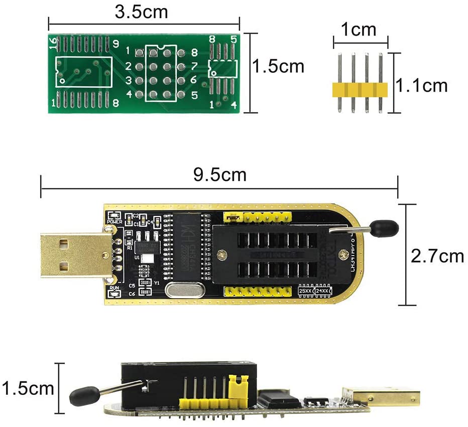

              Did you use the programmer before. Did you put the jumper at the right place.?
              You can use this programma also Colibri and Neoprogrammer.
              Can you sent picture of your programmer how you set it up and you must use auto detect the chip.
              Good luck
              Best regards
              Steve
                I watched a few videos on youtube that addressed the jumper issue and I believe is on the right place... I will attached pic
                I will give those a try next
                I don't see an auto detect button on AsProgrammer

                                Did you checked the continuity between your board and the CH431A socket too? It can happen that there is a bad connection at this point. Try not to push it completely into the socket so it can fit properly when you close it.
                                Good luck.
