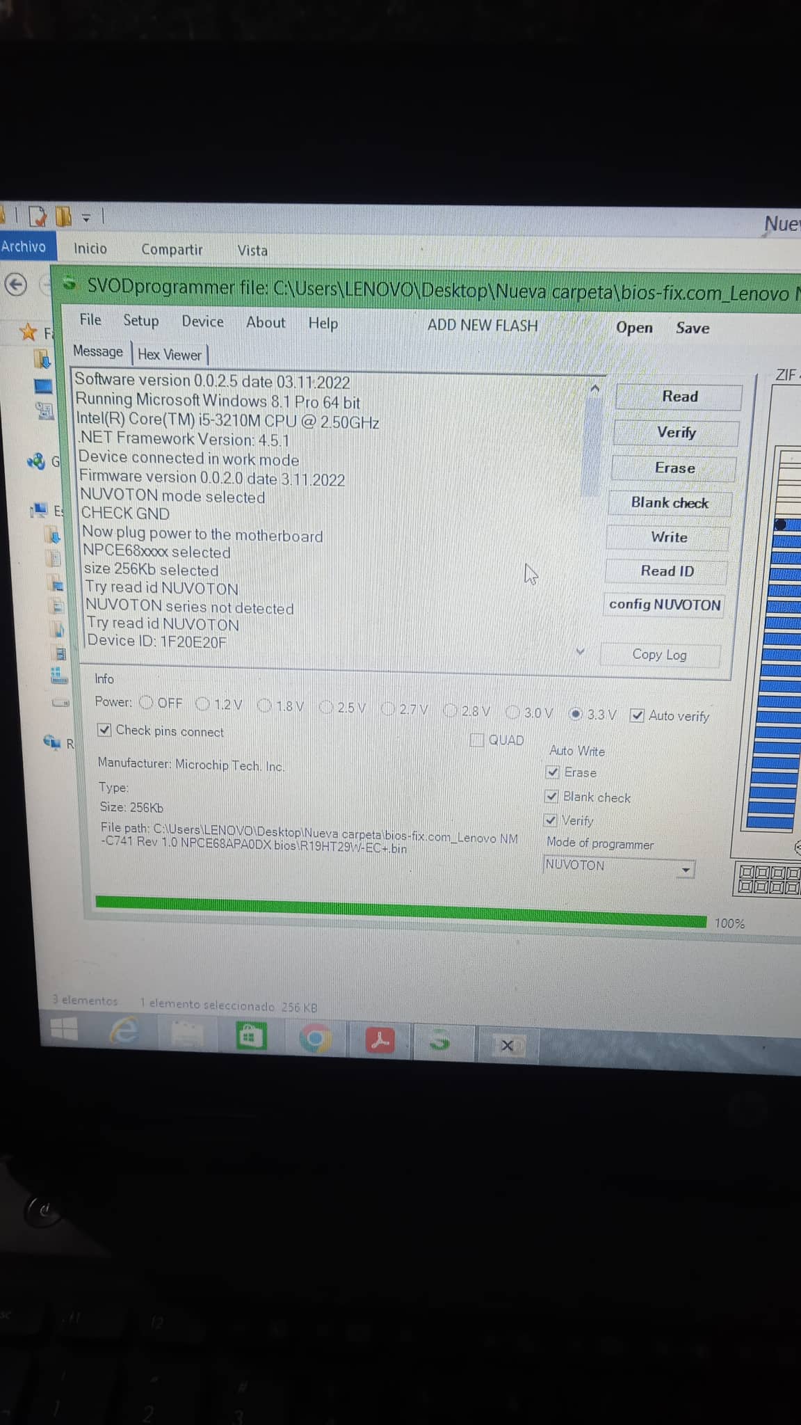

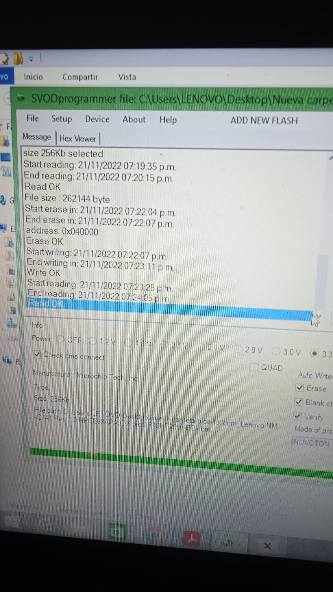

              yes, with svod4, you have to update to be able to read that ec, it is also 256 not 128. in the end I was able to do it.

                yes i update it and i read it its 256mb bro

                  It's not 256mb, it's 256kb that npce68ala0dx has. the key is stored there.

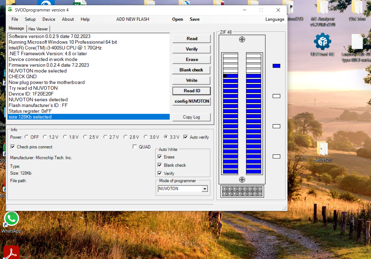

                            Hello sir can you upload video or picturs how to read the i/o on this model using
                            svod4 please

                              you said that the file is 256 kb but you upload 128kb file size

                                  i have the latest update qs you can see in the picture and i upload the file that i got after reading the io

                                    I don`t own this programmer but maybe you can select the size in "config NUVOTON"

                                      i did this it's the same empty file

                                        So did anyone had any luck using SVOD4 or vertynov?
                                        From SVOD i keep getting empty reading and cant write or erase or verify.
                                        Has anyone had any luck?

                                          NPCE68BPA1DX I unlocked with vertyanov. It was a LAR-2 board. The problem was that the provided config was a bit wrong there.
