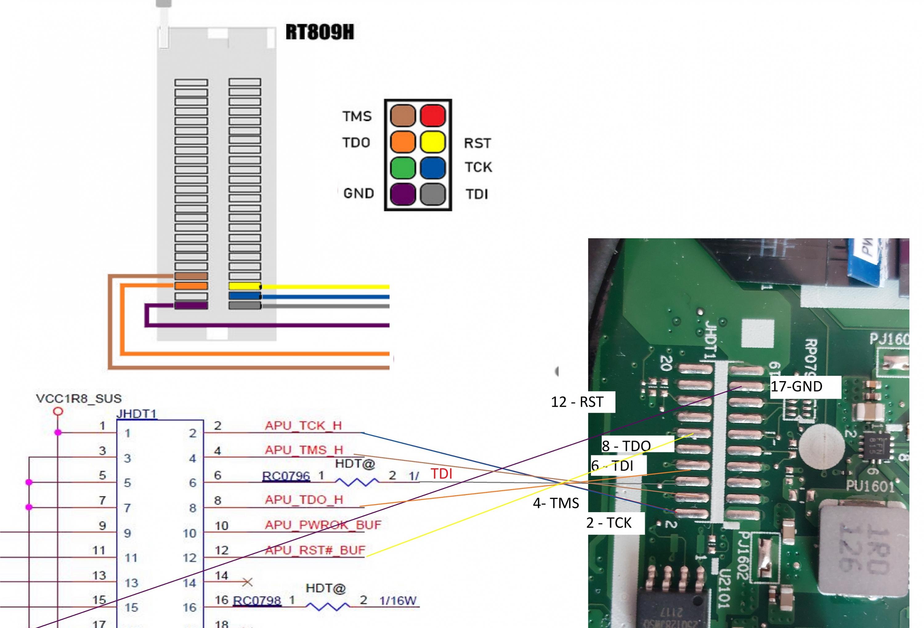

Re: Lenovo Thinkpad L15 (CPU 10th Gen) Supervisor Password
Please help with connection of RT809H.
With auto-ISP it shall connect without problem?
RST cable shall be connected?
There is somwere 10K resistor to switch to able programming?
I made schematic fot ISP/JTAG, can someone confirm?
