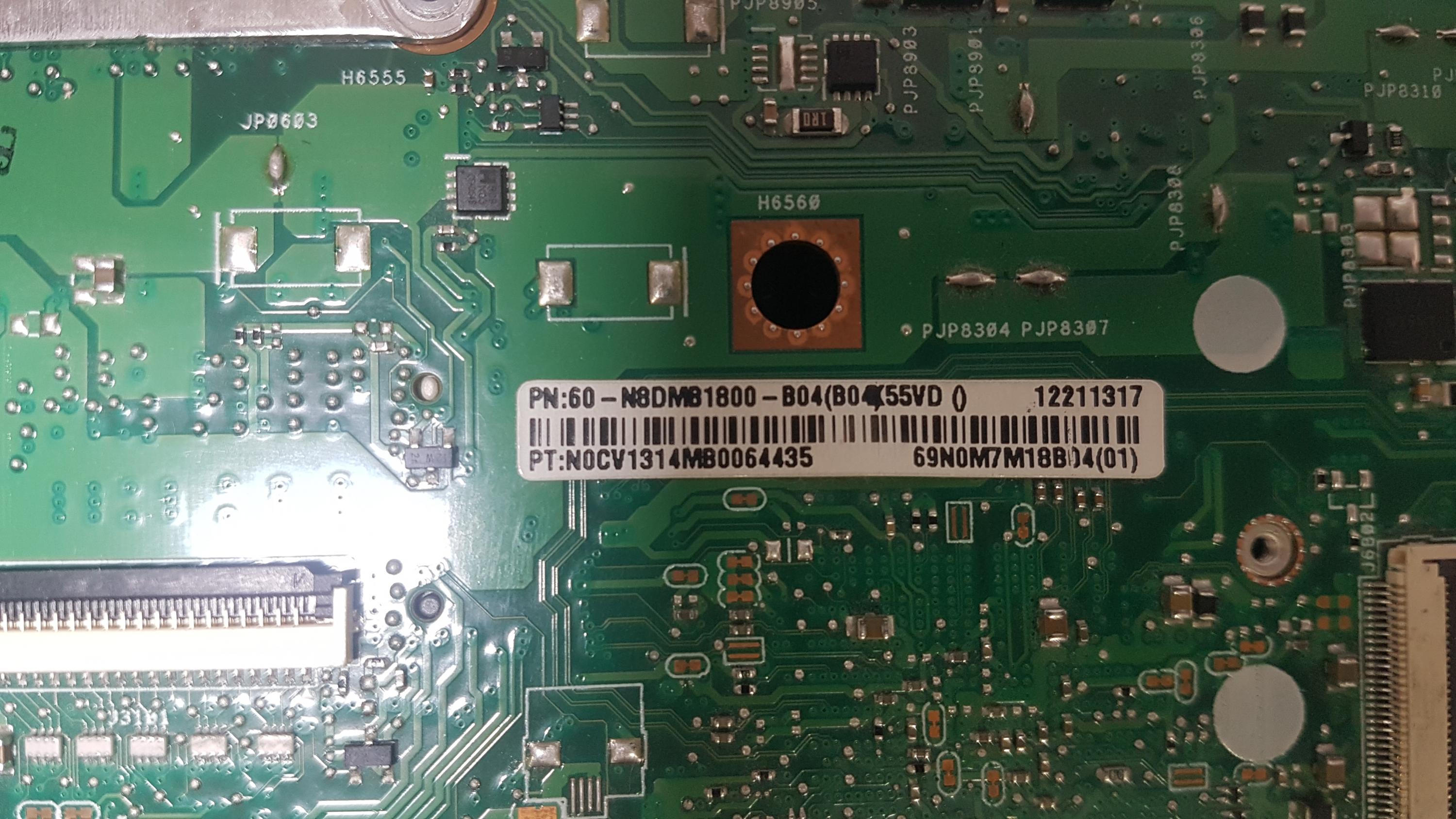

K55vd fan fast spininnig please help
  • bilen
    • Aug 2014
    • 632
    • istanbul
    motherboard code : k55vd rev 3.1 nvidia 610m gpu
    fan spining fast . working dump :
    please help me

        Re: K55vd fan fast spininnig please help
        Originally posted by bilen
        the problem continues
        Post a good clear readable picture of the white/green sticker on the motherboard. Usually its on or around the RAM socket .
        • bilen
          • Aug 2014
          • 632
          • istanbul
          here
            • 20643
            Try - https://www.badcaps.net/forum/showthread.php?t=83607
            • bilen
              • Aug 2014
              • 632
              • istanbul
              I've tried. the problem is the same
                • 20643
                try this one.If it doesn`t work this time the problem is somewhere else.
