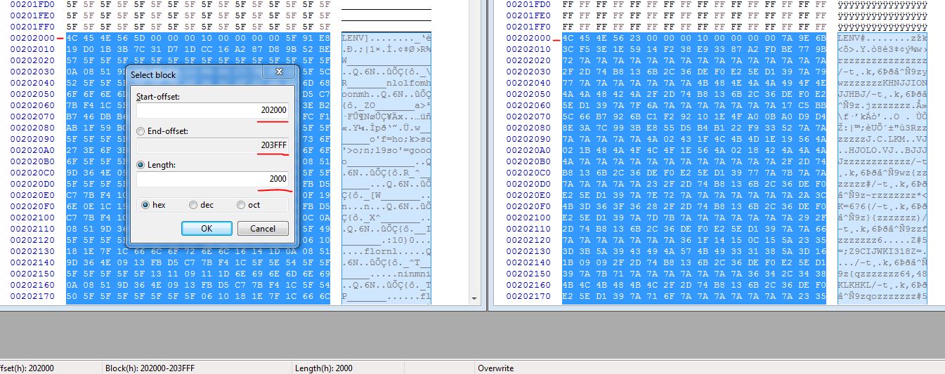

                              Re: Need bios lenovo yoga C930-13IKB
                              please rebuild my bios.
                              No detect m.2 nvme, no detect usb
                                • 20888
                                Use the virgin bios at post #9 .Copy your DMI using the off-sets in the attached picture from your backup and copy over the same off-sets into the virgin bios.
                                HxD hex editor https://mh-nexus.de/en/hxd/
                                • piszpunta
                                  • Jan 2019
                                  • 249
                                  • poland
                                  Thank you for teaching. Its working.
                                  how did you know DMI is at this address?
                                    • 20888
                                    Just by searching for the word LENV .
