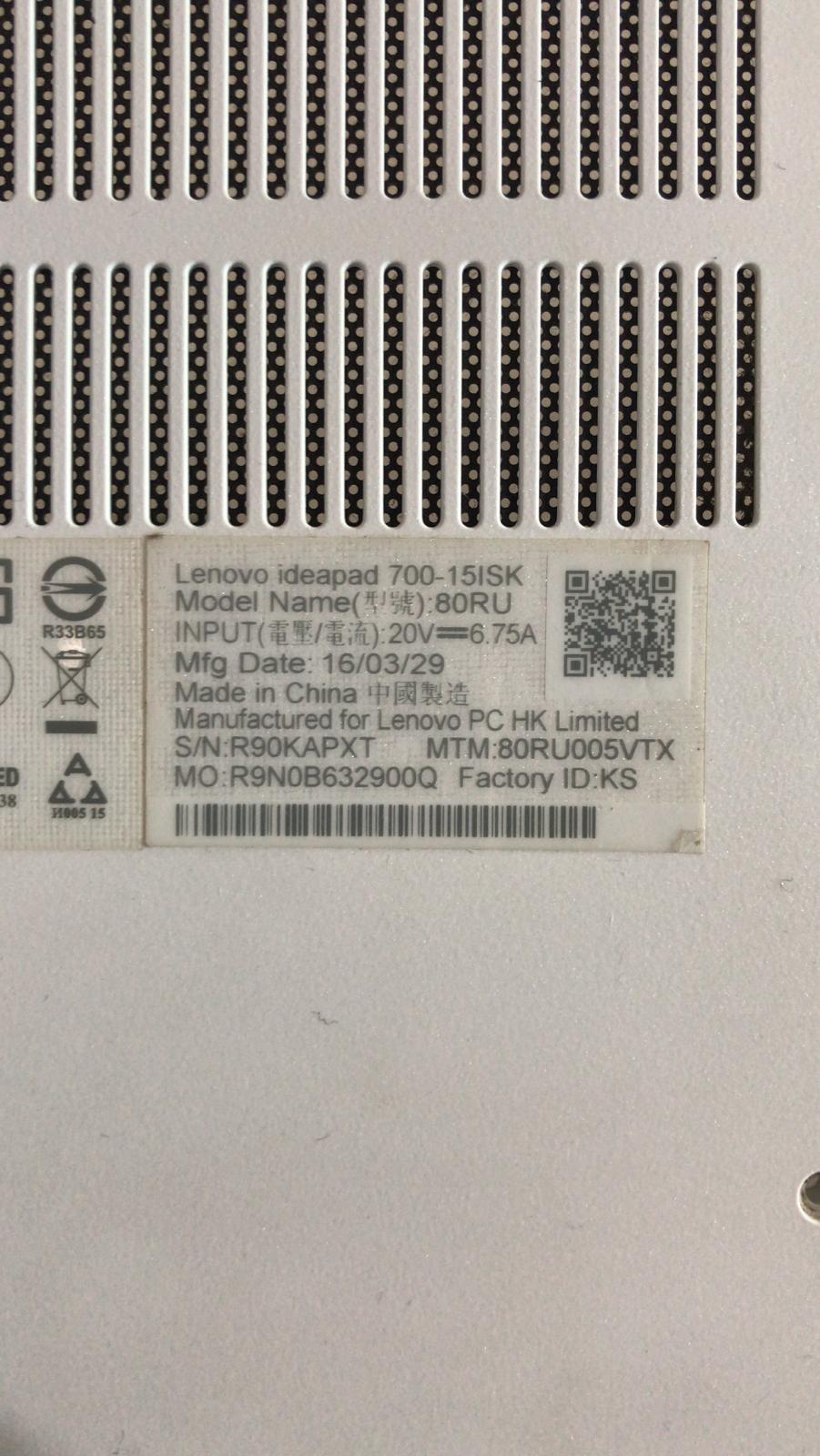

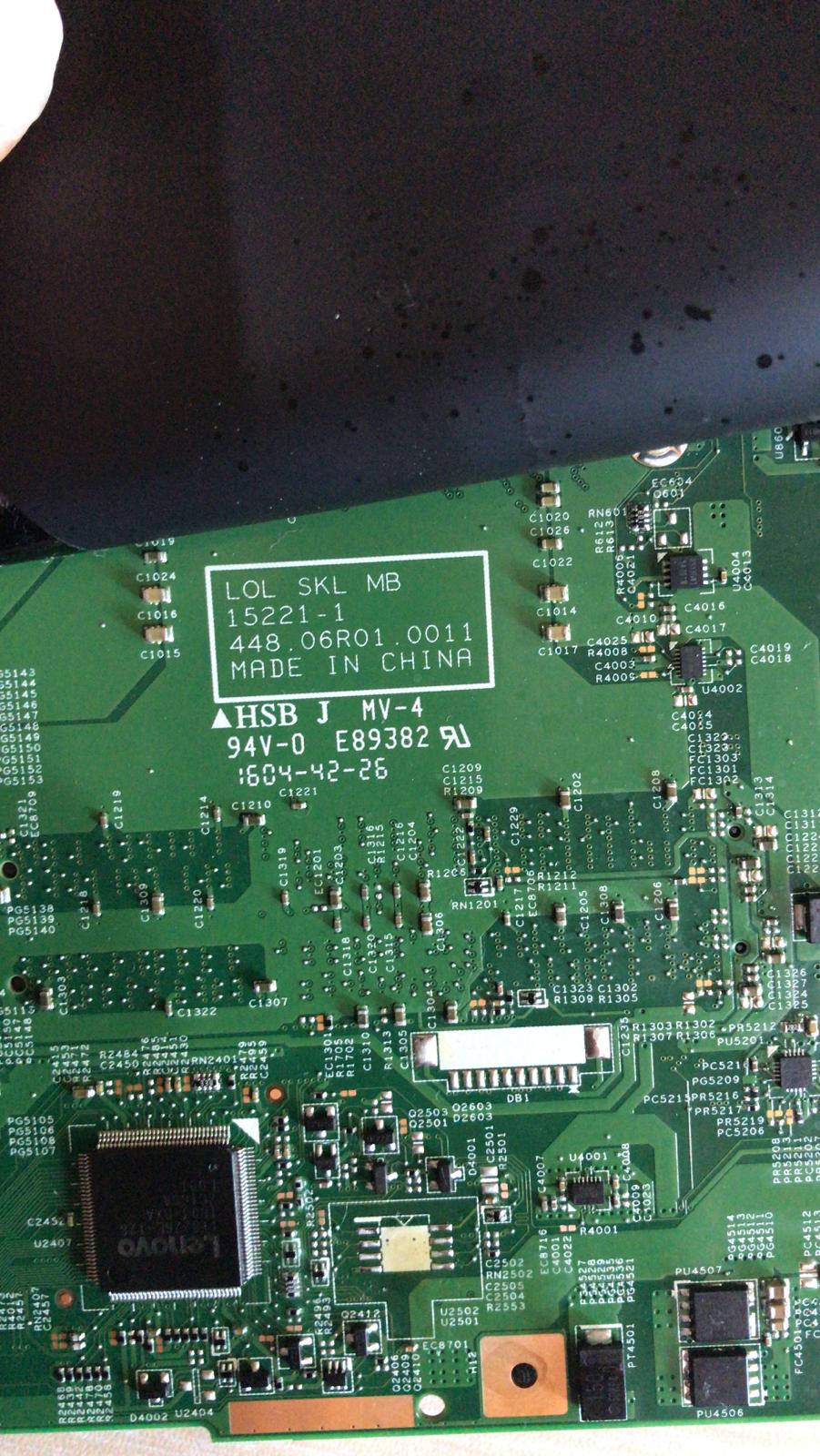

        Lenovo ideapad 700-15ISK BIOS+ EC NEEDED
        motherboard : LOL SKL MB 15221-1
        448. 06R01.0011
        case code : 80RU
        processor : 6700HQ
        Gpu : GTX 950M
        EC : IT8226E -128
        Bios chip : Winbond W25Q128FV 16MB
        Backup bios : lenovo ideapad 700 orj bios.rar
        thank you in advance for your help.

              Re: Lenovo ideapad 700-15ISK BIOS+ EC NEEDED
              Originally posted by mahmoodjavan
              plz test
              bios didn't work ,
              0.35 Amper
              Do not have EC rom?
                Does the mobo can charge battery?, if it can charge battery then 80-90% EC (include firmware/ec rom) still good.
                Did you have backup dump the EC, for comparing use HxD apps. Usually EC rom lenovo also found on bios dump.
                  device is working, but does not show external video card (GTX 950M)
                    I think that issue wasn't related with EC rom.
                    Maybe power rails missing supply for NVidia chips. Also "external video" give me confuse. Did you mean discrete dedicated VGA?
                    Anyway, try this, not tested. Merge your backupnwith update official.
                    If you have issue when extract it, try 7zip.

                      • 22293
                      There`s a problem with the original bios ME region, it opens ok in MEA but in FITC theres an error,i tried manually editing in the ME region,still has errors.The bios posted by mahmoodjavan has 1KB extra at the end and a dirty ME region,i made a new bios from that.
                      700-15ISK (Type 80RU) ME_CLEAN
                        plz test
                        thank you so much
                        • Edward1234
                          • Feb 2017
                          • 7
                          • Poland
                          Thanks, work well
