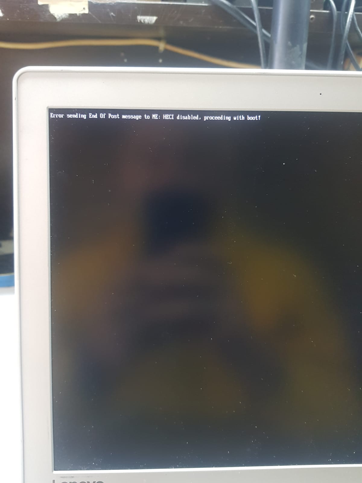

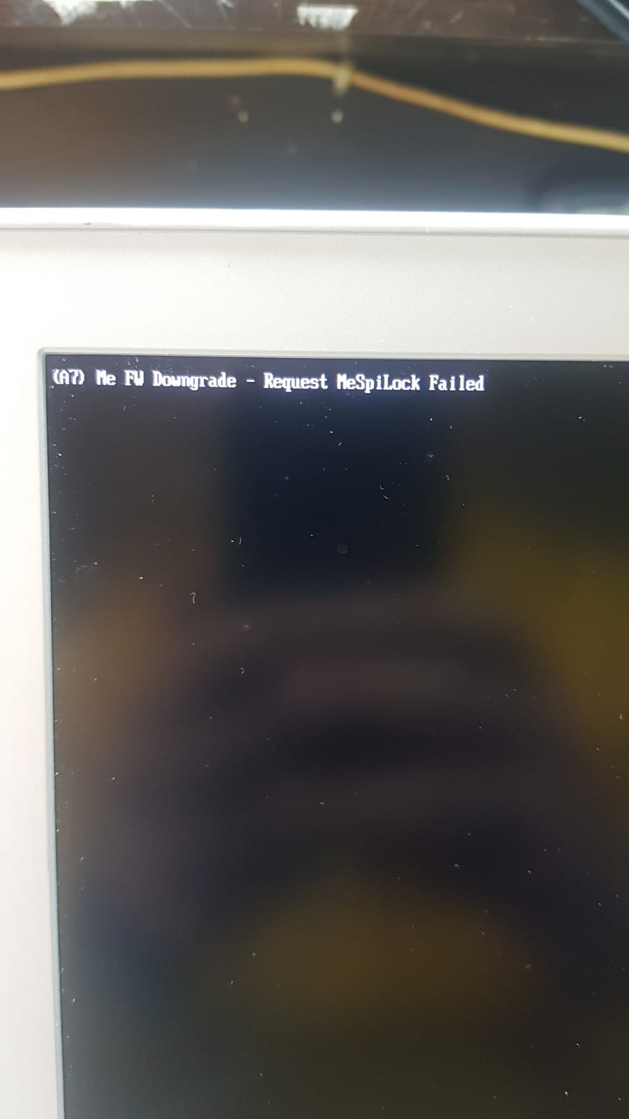

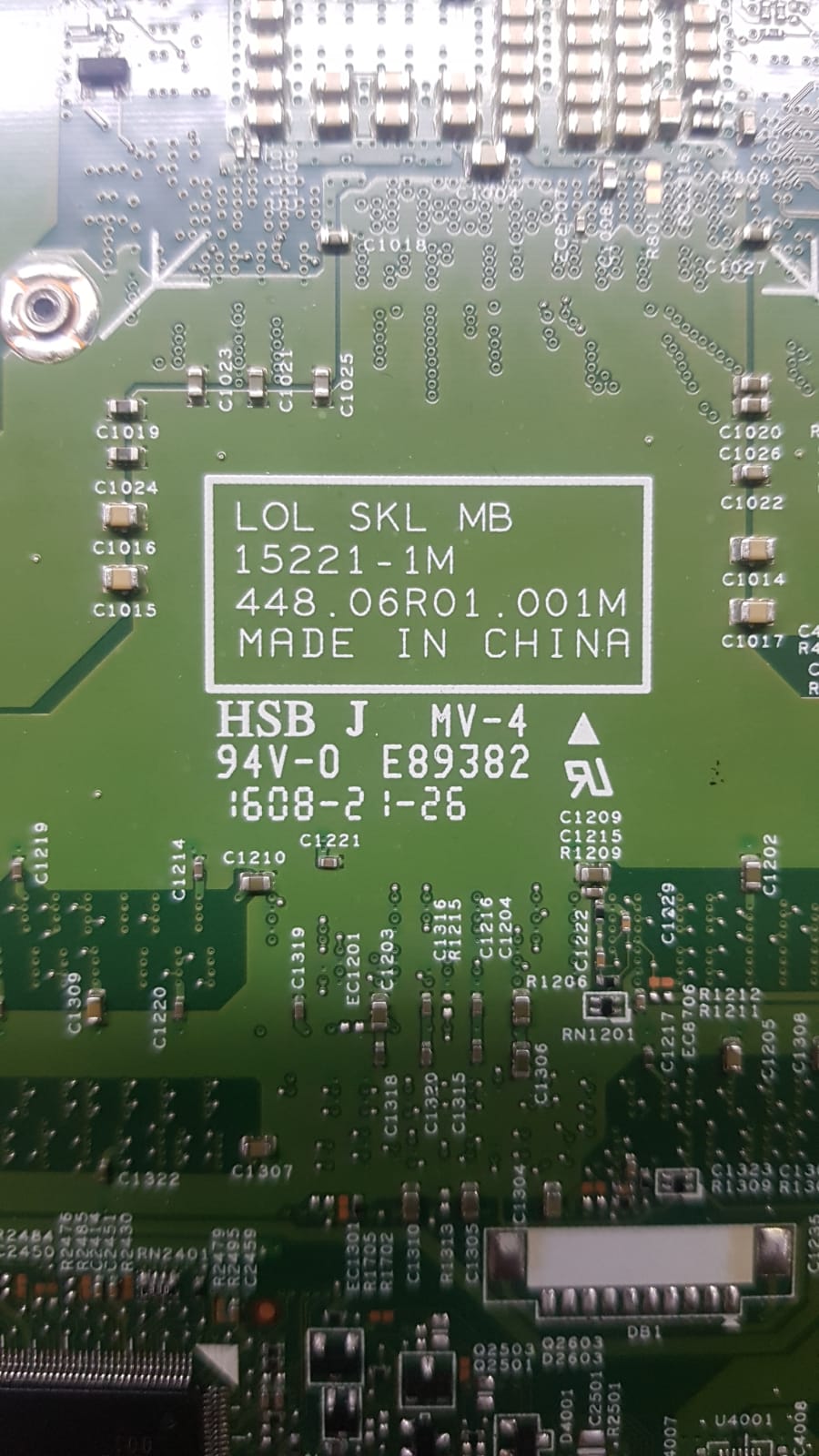

            İdeapad 700-15ISK
            hello friends lol skl mb 15221-1m 448.06r01.001m I tried all the bios files in the bios required shared topics, I could only get the image with the attached bios file, after a while it started giving "a7 me fw downgrade request mespilock failed" error, I made clean me to the same file, but I couldn't get a picture after clean me, if anyone can help I would be very grateful, thanks in advance
            • egelaptop
              • Jun 2015
              • 125
              • türkiye
              Re: İdeapad 700-15ISK
              Pictures and bios file are attached.
              • peste
                • Dec 2016
                • 13924
                • ROMANIA
                try..
                  Originally posted by peste
                  try..
                  Unfortunately, the image comes late and gives the error in the picture I added.
                    • 22293
                    #29
                    Your backup is the same as the bios at post #11. Try another bios chip,if that doesn`t work it could be a problem with the PCH/ME_FWP_EC
                    • egelaptop
                      • Jun 2015
                      • 125
                      • türkiye
                      #30
                      yes, the file in the 11th message is already I was able to take an image with it, but after a while I started to get such an error, it may be in ec, my problem, but I can not program ec, it gives an error, let me look a little more thanks

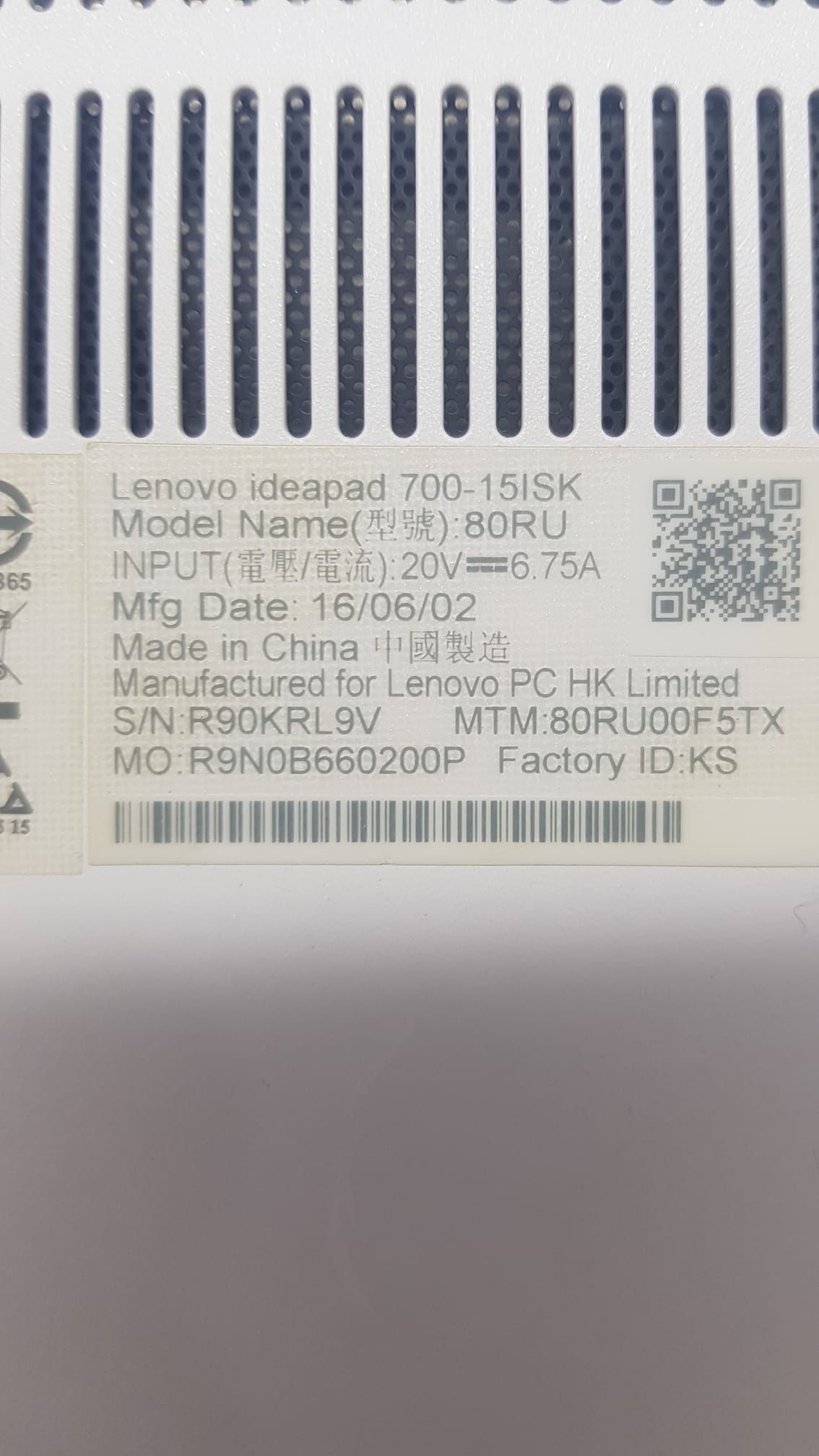

                                    • recep1982
                                      • Aug 2014
                                      • 91
                                      • istanbul
                                      #38
                                      pls help me Lenovo ideapad 700-15ISK bios repair needed
                                      anakart : LOL SKL MB 15221-1
                                      448. 06R01.0011
                                      The original bios and ec file is available below. thank you in advance
                                      • hoaca388
                                        Badcaps
                                        • Jan 2022
                                        • 12441
                                        #39
                                        448. 06R01.0011
                                        Where is serial number ? Don't forget.
                                        • recep1982
                                          • Aug 2014
                                          • 91
                                          • istanbul
                                          #40
                                          SN: R90JXWJB
