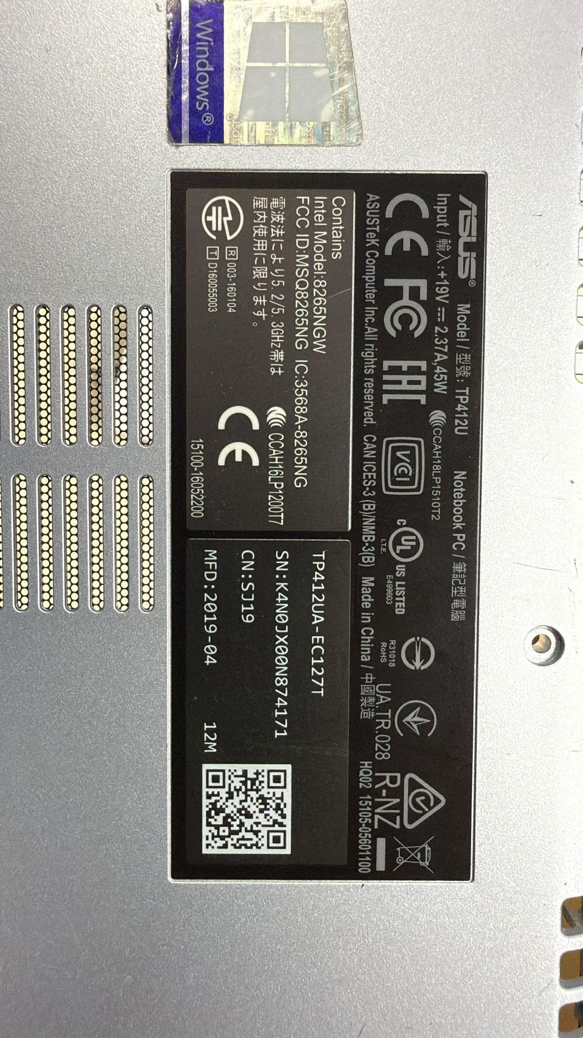

      HI everyone!😎,
      i need assistance to recover data from an ASUS TP412UA with a BitLocker-Locked and a corrupted BIOS dump
      Device:
      Motherboard:TP412UA rev 3.1
      Model: TP412UA-EC127T
      Serial: K4N0JX00N874171
      Current status:
      -it boots becasue i flashed the curropted BIOS firmware from an identical machine and only changed the serial number.
      -i still need an help to recover the data from the previous installation.i have the corrupted BIOS dump, but the drive is protect by bitlocker.
      In simple words:
      what i need help to analyze the currupted bios/firmware to understand what's missing and how to rebuild a clean image while preserving board-specific data.
      thx for every person who will respond at this message😁
      PS:if you notice the old bios file zip it's because the blog block me from upload the .bin file.
      Pietro

        You're out of luck, sorry, ME region and the whole BIOS is corrupted, TPM is reset when you flash new BIOS, even if you copy the DMI data
        No way to recover data unless you can get the 48 digits Bitlocker recovery key from MS account
        https://support.microsoft.com/en-us/...3-056f5ab347d6
        Longer explanation here: https://www.badcaps.net/forum/troubl...on#post3763076
