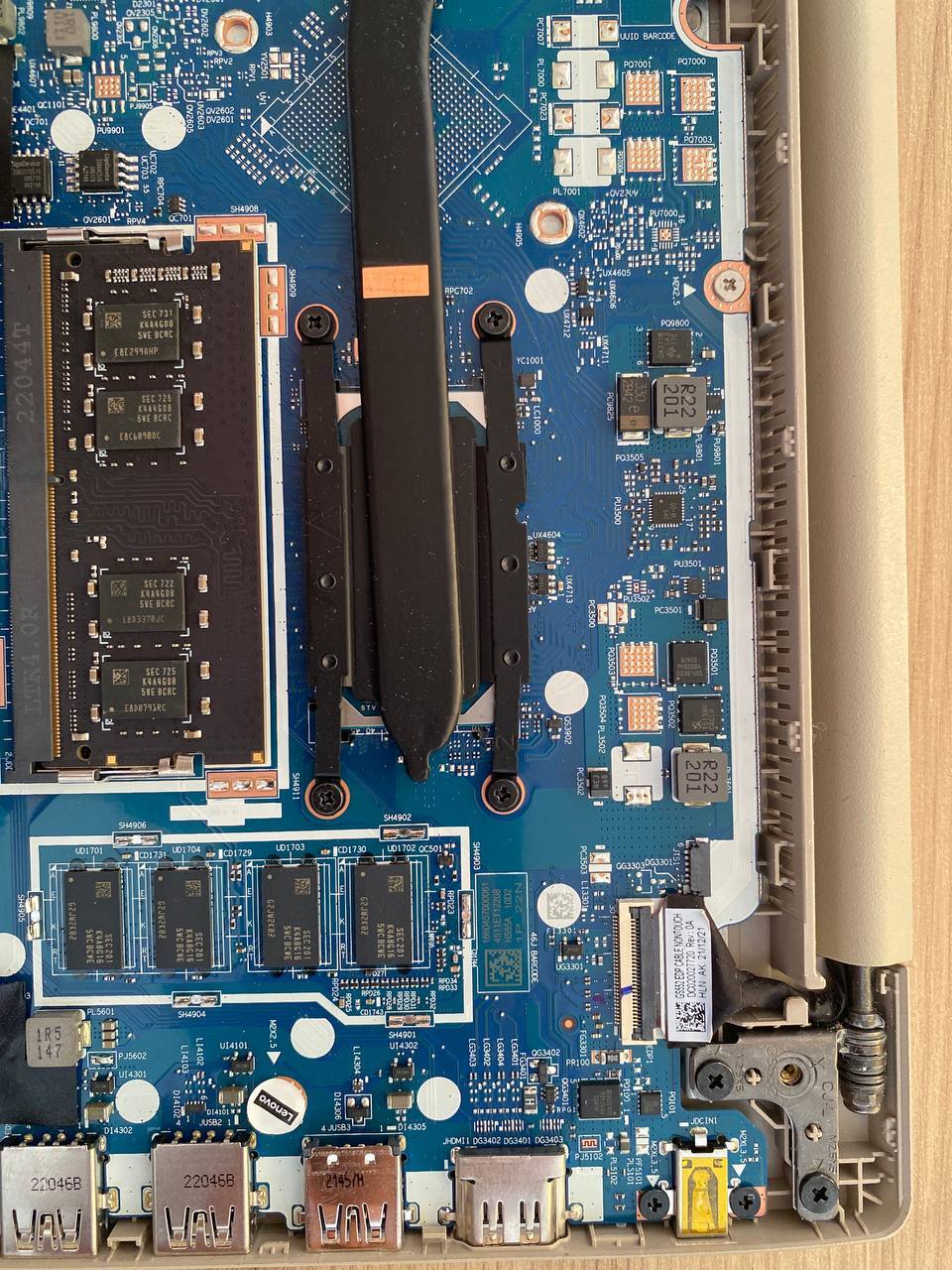

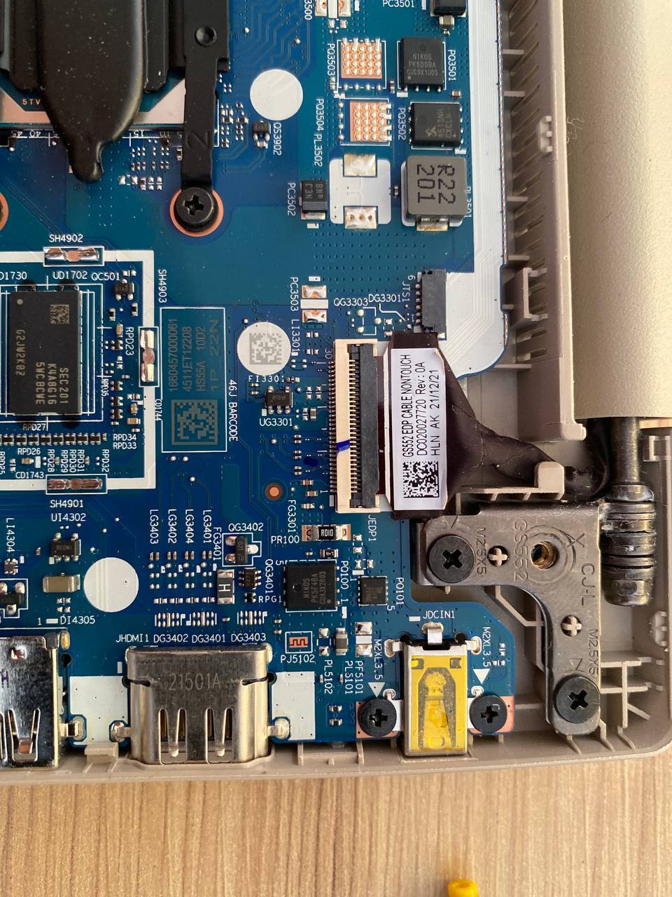

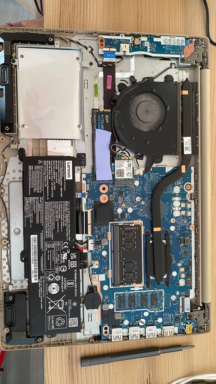

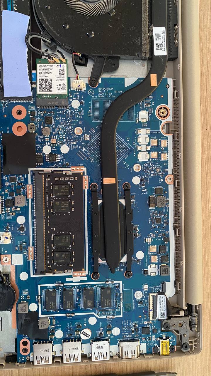

    I need your advice in diagnosing a motherboard issue on a Lenovo IdeaPad 3 15ITL05, motherboard HS45A/HS55A Rev 1.0 NM-D461 (2020-11-02).
    Symptoms:
    The laptop does not power on and does not respond to the power button.
    Background:
    According to the owner, her child was playing on the laptop when it suddenly shut down.
    What has been done so far:
    Original charger is missing; the non-original one was tested and found faulty (0 V output).
    Using a lab power supply (20 V, 0.5 A) — no activity on the board, no LEDs, no standby voltages.
    20 V present at the DC jack and PQ100 (MOSFET), but missing at PQ101.
    PU100 receives 20 V.
    Power consumption 0.030–0.050 A.
    The battery (Lenovo L16L2PB3, 7.6 V nominal, 8.7 V charging) was deeply discharged.
    Initially 0 V output, BMS locked.
    Each cell ~3.2 V, recharged to 4.2 V, but BMS still locked (0 V total).
    MOSFET PQ101 (SM3319) was shorted and replaced with the same model.
    After replacement, the board shows signs of life:
    Orange BATT_CHG_LED turns on when battery is connected.
    Battery controller unlocked; charging voltage 8.49 V, battery voltage 8.36 V.
    On power button press: fan spins, CPU warms up (no heatsink now), power button and PWR_LED blink.
    Current rises to 1.8 A, then drops to 0.3–0.4 A (charging). Without battery – 0.036 A.
    Screen stays black, no image on internal or HDMI output.
    Voltage measurements:
    PJ5901 (V9B+): 8.38 V (battery) / 19.9 V (AC adapter)
    PJ5902 (3VALW): 3.35 V in both cases
    PJ5601 (V9B+): 8.38 V / 19.9 V
    PJ5602 (+5VALW): 5.09 V / 5.11 V
    I’ll attach motherboard photos and schematic below.
    Question:
    Could you please advise which section I should check next, or what could prevent the board from turning on the display?

    How much current is drawn without battery after power button pressed, any voltages on ram, cpu? Slot ram removed - any changes? Resistances on main coils? RTC battery removed - does it autostart?
    Can you reprogram bios?
