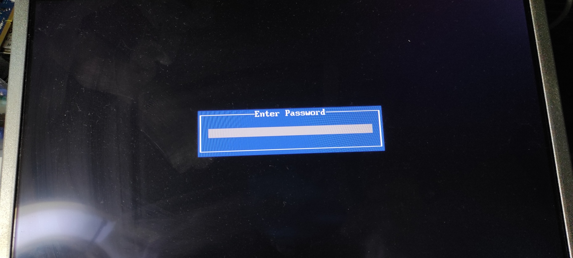

                              Did you try setting a new password rather than setting bios defaults. Theres another password for the Optional Kit Configuration: toughkit

                                  • 21679
                                  Re: Panasonic Toughbook CF-C2 please remove bios password!
                                  Are you tring without the HDD attached. Post a picture of the pass screen.I doubt its stored in the EC ,what is the EC chip ?
                                  Edit: did you remove the CMOS battery and clear it by shorting the battery pins for 20 seconds or so ?
                                    Yes i try without HDD
                                    The screen is the usual Toughbook password screen.
                                    Yes CMOS battery is detached from the beginning, no power on MB except the PSU when i plug it.
                                    I also tried 20secs short circuit.

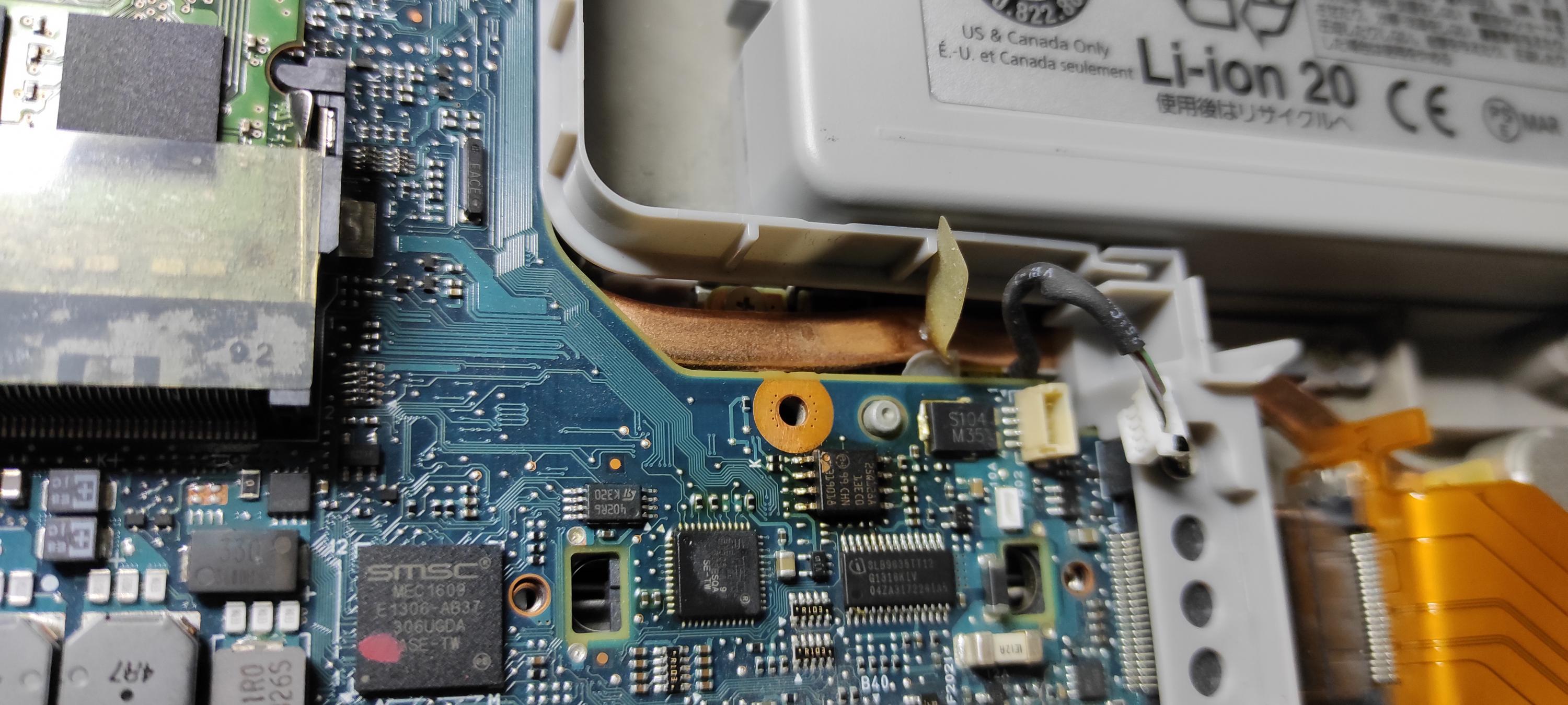

                                    Well i'm almost convinced is stored into EC.

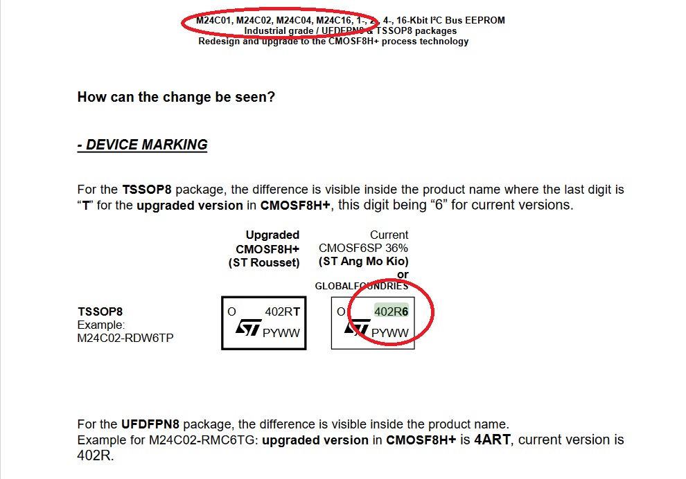

                                      what is that? maybe
