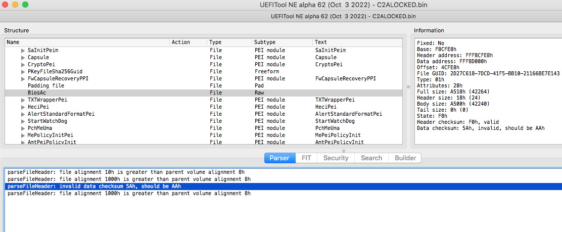

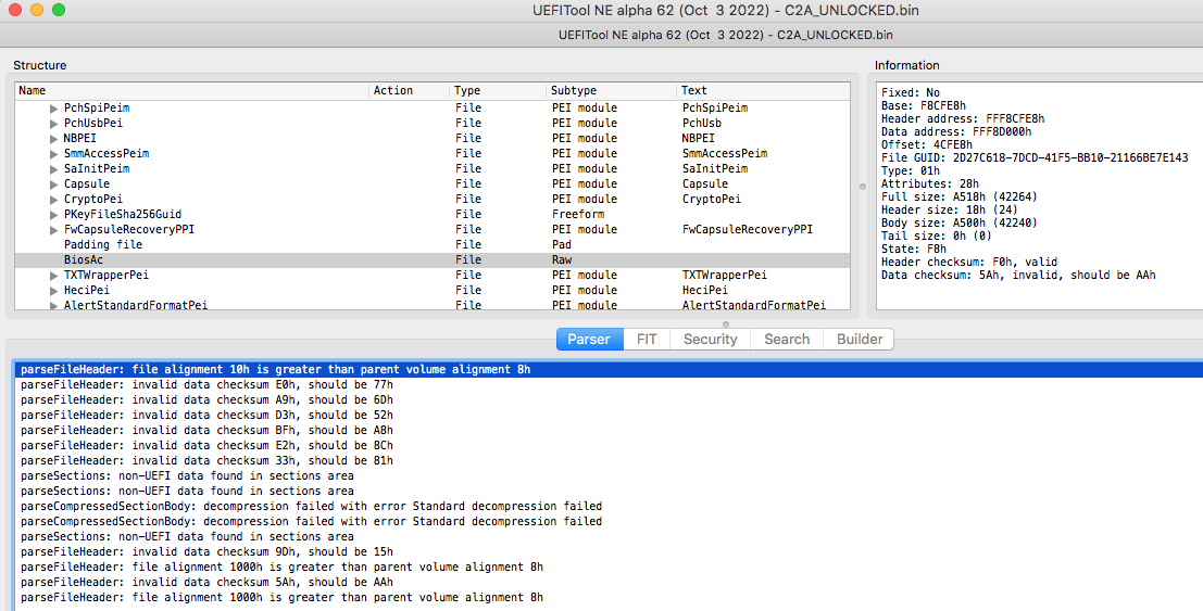

      Originally posted by ashr88
      Here you go:
      also with errors. i advise you to read bios chipset many times until you obtain 2 identical files. I don't think your laptop will start with soooo many checksum errors

        Re: Panasonic Toughbook CF-C2 please remove bios password!
        Sorry about that, it seems that my programmer was at fault. I replaced it and now it's verifying.
          still has errors, if I were you i'd use another bios chipset with unlocked file, it is a huge possibility that if you erase bios chipset and dump is not ok the laptop will be bricked. Anyway, I erased password but still have doubts your bios dump is ok.

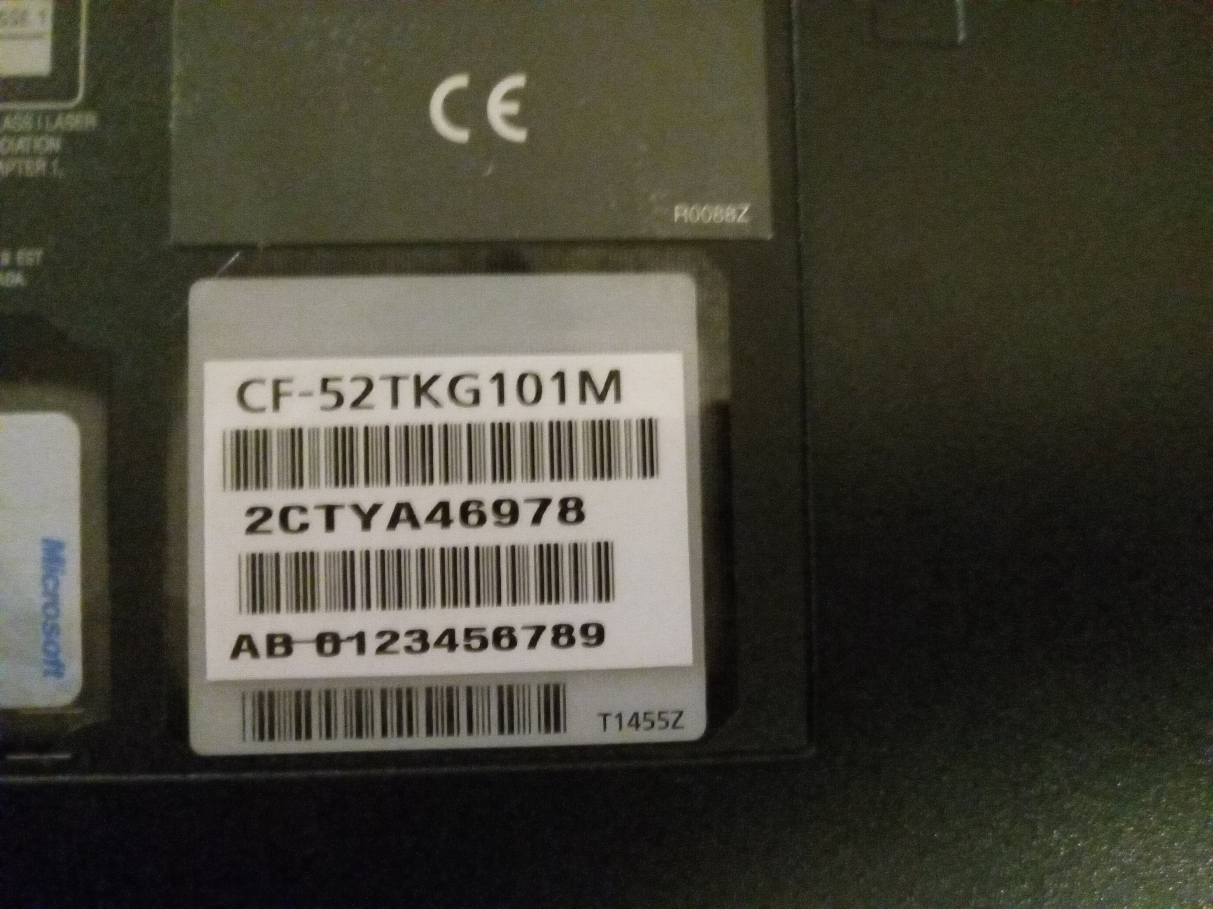

                                Could somebody help me with this.
                                Removed all power, unplugged bios battery,
                                let it sit overnight.
                                still have the password.
                                Unsure if i can use the files others have posted.
                                I'm guessing that could brick the unit.
                                So here is the info from the unit I'm working on.
                                I'm hoping i have followed all the guidelines.
                                Do I need to purchase a spi programmer and
                                ​Create a bin file of my current bios or is there
                                ​another way ?
                                CF-52TKG101M
                                2CTYA46978
                                Thank you in advance,
                                sincerely James.
                                  or is there
                                  another way ?
                                  CF-52TKG101M
                                  2CTYA46978
                                  sincerely James.
                                  This is really cool. Years ago like years and years i used to find help for motherboard reapir for those impossible to find in circuit component failures.
                                  when the Piii socket 370s were new tech lol
                                  Thank you again. Really cool
