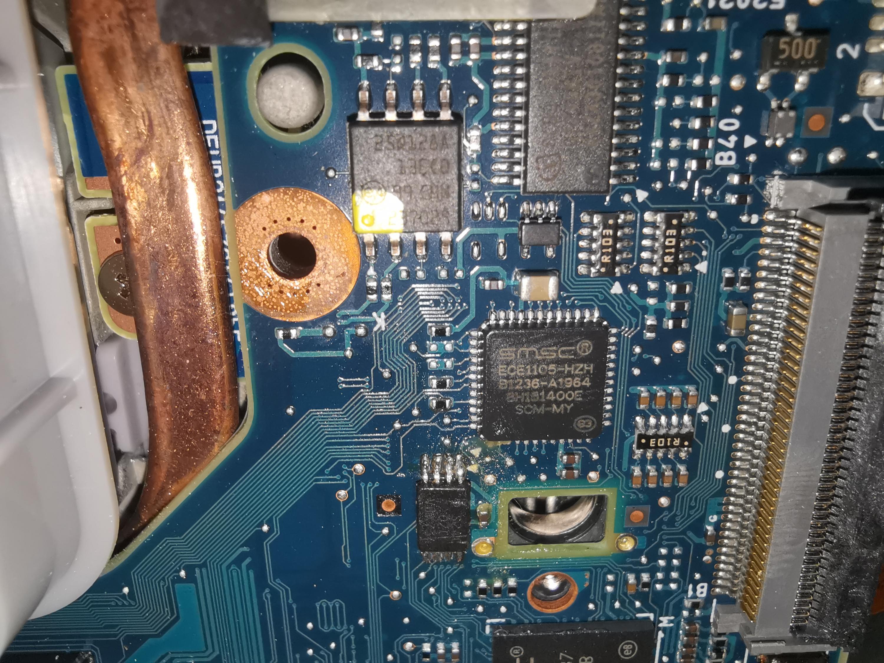

                Hi guys
                i have one one stupid question.
                how to run bios2.bin file to update locked bios on Panasonic toughbook CF C2.

                      #50
                      Re: Panasonic Toughbook CF-C2 please remove bios password!
                      You need CH341A programmer

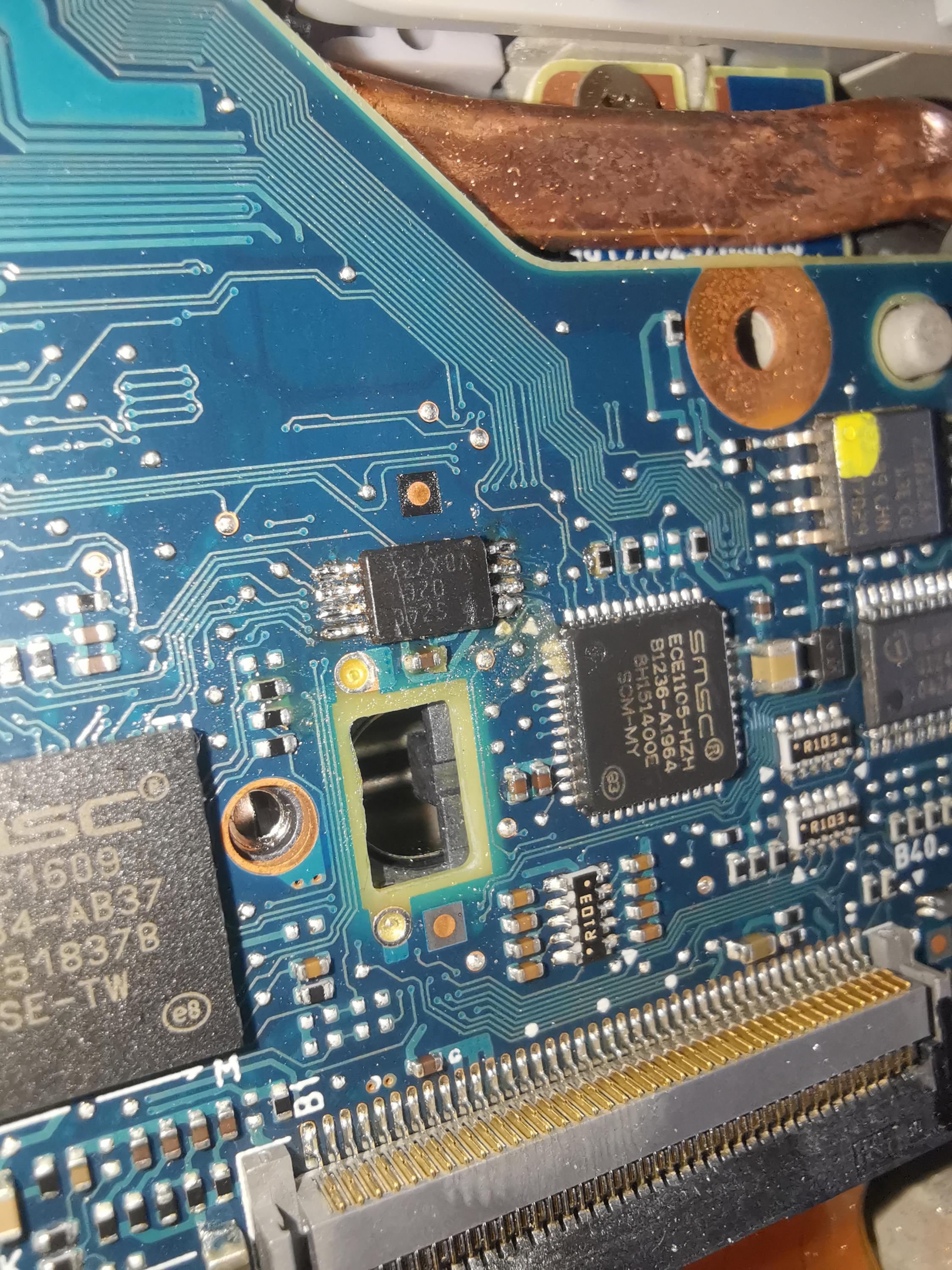

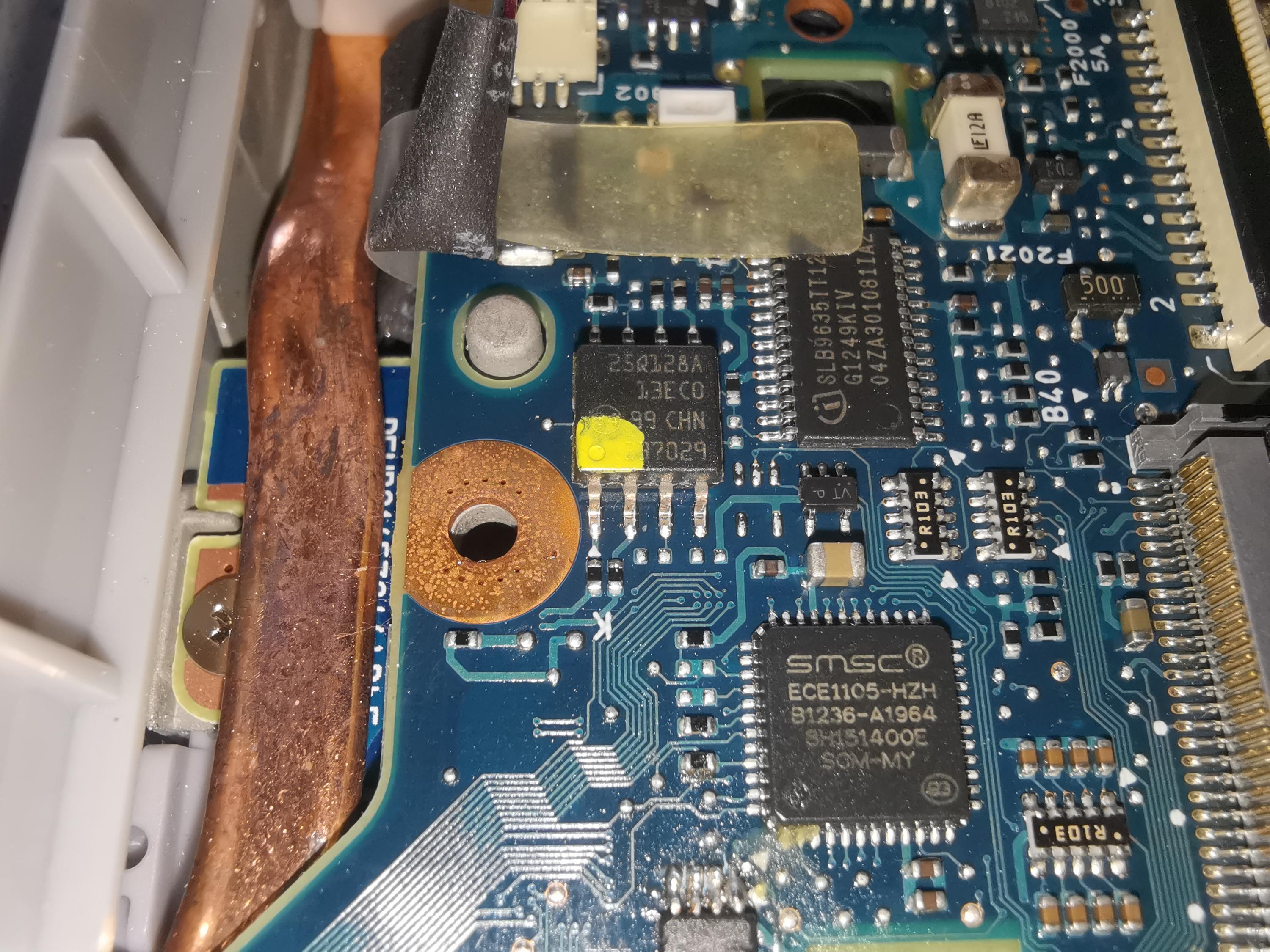

                          #52
                          There is option to buy it with 8pin flex clamp that fits 100% in the bios chip, in my case though this was impossible (never figure out the reason) and the programmer didn't recognize the chip so i have to desolder it everytime and solder it on a small pcb that comes with the programmer to read it and write it.
                          But now since the bios is ready you will have to do it only once

                                  @Andreasbest
                                  I got the programmer and the 8 pin flex clamp cable. I will try and update the chip with bios2 file from SMDflea.
                                  So the bios chip is the one that reads 402R6? Correct?
                                  My machine is asking for a password when I switch it on... It doesn't even let me enter the bios... Do you think its a supervisor password or a user?
                                  Would flashing it with bios2 resolve it?

                                      OK.. So I tried and tried but couldn't read the chip
                                      I had to desolder the chip, but my chip has something else written on it. I tried both the chips, it reads but I think it is not correct as I get FF and somewhere 0 also... While writing it gave error on both the chips buffer is greater than the chip...
