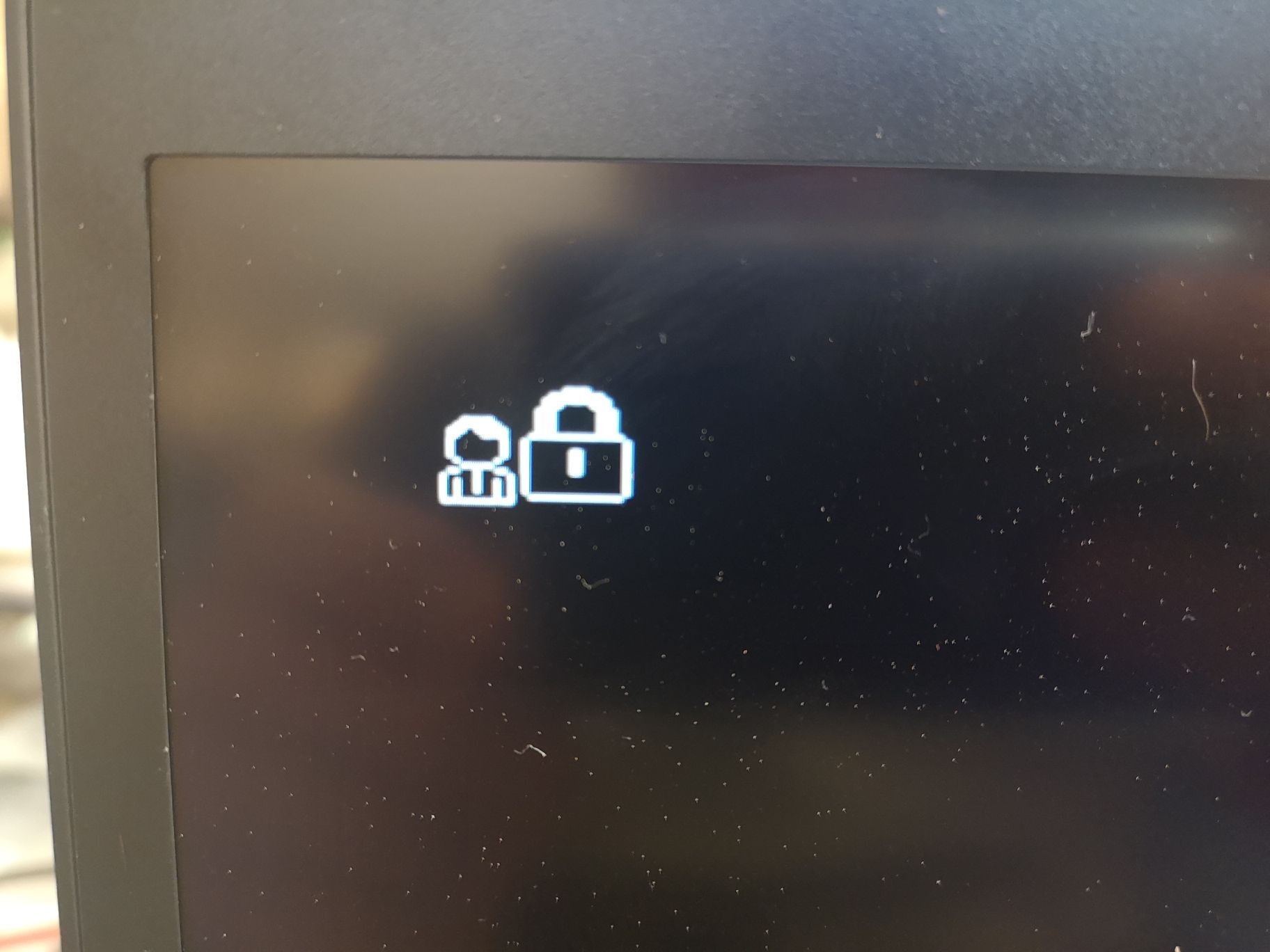

    Hello again badcaps team! In the end I tried modifying the BIOS with autopatch and I managed to create the patched image of my original BIOS, then I tried erasing the original and flashing the patched image to do the password reset according to the steps you have to do in your post of the autopatch manual. Also, now I have some practice and I know how to verify the flashes well and I know when I can have a failure and correct it, and I do all the work correctly, but it turns out that my image patched with the autopath does not work (the LED of the ESC key and the LED of the letter "i" on the THINKPAD sticker at the bottom right of the keyboard remain permanently lit) and it does not start, it remains black screen and does not start. I have tried flashing my original BIOS image again and the PC works correctly, and again I tried flashing the patched image but I have the same error, black screen, fixed LEDs on and black screen without starting. From what I understand, I think there's a problem with the patched image, but I followed the steps and everything turned out fine. Could you review my patched image or fix it if it's not correct?
    I'd appreciate it while I'm unable to read the EC chip.
    Thank you very much.​

                  Perfect, first of all, thank you so much for continuing to help me, Mxpower3. I really appreciate all your help.
                  I'll explain the entire order of work I've done and the results I've obtained. I've tried each of the images, and in this order:
                  1-> Yoga 11e_Password vss FF AUTO_PATCHED -> PC WON'T boot; black screen and both LEDs on solid
                  2-> Yoga 11e_Password vss FF + Nopwd_Patched -> PC WON'T boot; black screen and both LEDs on solid
                  3-> Yoga 11e_Password vss FF -> PC WON'T boot; black screen and both LEDs on solid, and 4 beeps.
                  4-> Yoga 11e_Password vss invalid -> The PC turns on, the screen displays: 0183: Bad CRC of Security Settings in EFI variable, when you press F1 the BIOS password icon appears differently as if it were a person icon, (before it was like a lock), but it does not enter the BIOS, I try with "1234", "1111", "0000", "Lenovo"... but everything gives an error, not even pressing the ENTER key directly is it able to enter the BIOS; the PC turns off. (attached photo of the image on the screen).​

                    Ok thanks for many try
                    Ok FF not work
                    just ff 4 bip weird, others bios mod must be checksum wrong
                    Vss invalid work but with supervisor password

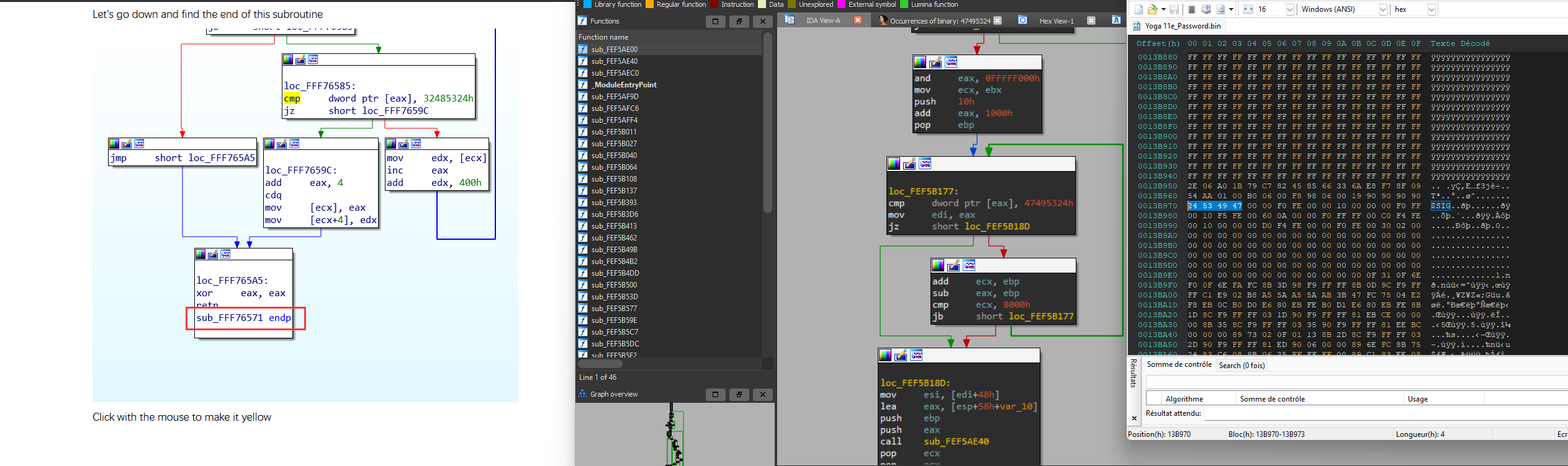

                    I saw a post here about correcting checksums for Insyde BIOS.
                    It's interesting.
                    Maybe it can prevent modified bios with Autopatch from not booting.
                    https://winraid.level1techs.com/uplo...VeyYeI4L5z.pdf
                    https://winraid.level1techs.com/t/gu...ontrol/34762/2

                        Thank you so much for continuing to help me here, Maxpower3.
                        I skimmed the PDF and the link you posted in the post, and I think it would take me months to understand all that info... hehehehe...
                        I'm still a newbie and I'm just learning, to be honest. That's why I don't really understand what you're showing me. I'll try to read everything little by little to see if I can figure something out. But thank you, really. Anyway, I tried the images you posted in the post, but with both flashed, I get the same problem as always: -> PC WON'T start; black screen and both LEDs lit solid as before. It seems like this motherboard or BIOS is resisting. Too bad. I don't know if there are any more options left to try... but thank you for trying with me and for your patience.
