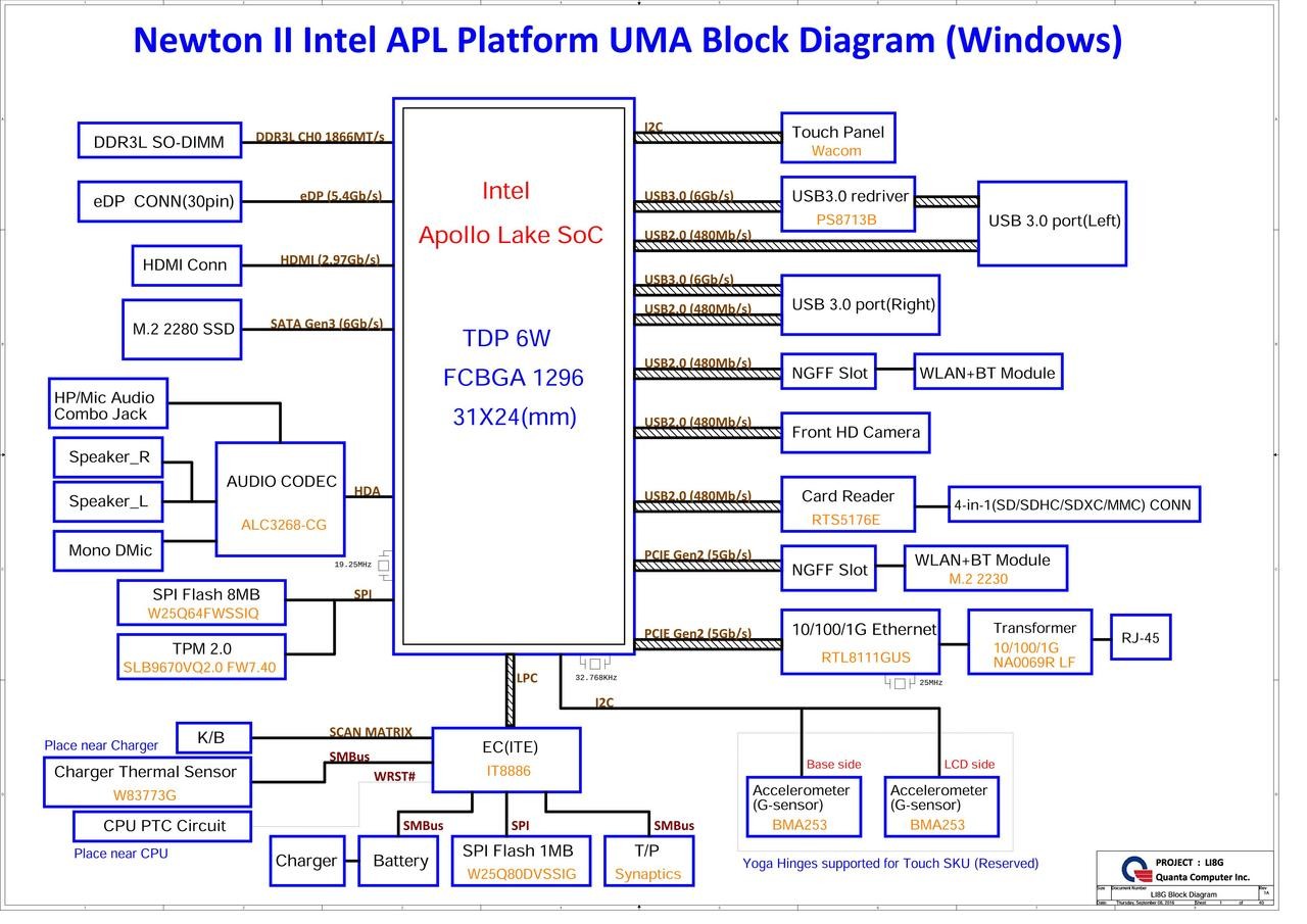

                          • 22001
                          Re: Lenovo
                          [QUOTE=Akintunde;1037249]
                          Originally posted by Akintunde
                          Good day Everyone please i need someone to help me with bios file for this LENOVO THINKPAD YOGA 11E BIOS password. This is the number written on the motherboard LENOVO DALI8GMB6D0 .This is my old file. it has password
                          If you look at the quanta LI8 schematic,or look closely at the motherboard you`ll see that the KBC chip is an ITE.The pass could be in the ITE 1MB flash W25Q80 , or in TPM, not sure.

                              • 22001
                              Re: lenovo thinkpad YOGA 11E BIOS password
                              Post your W25Q80 backup .
