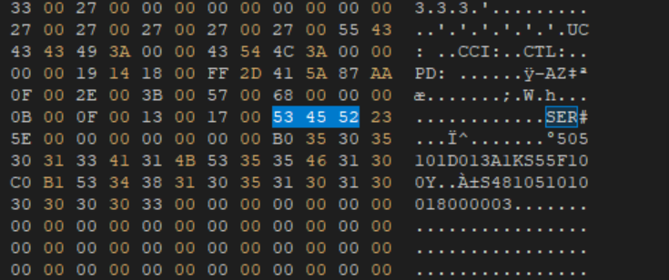

                            yoga 11 ??

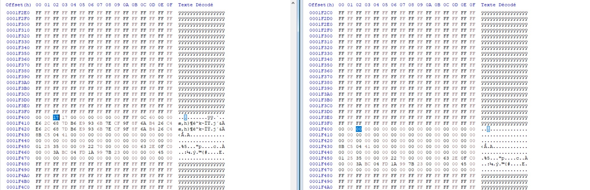

                            • Zeeshanali1
                              • Oct 2018
                              • 27
                              • Pakistan
                              #76
                              yoga 11 ??
                              Click image for larger version  Name:	346088338_1889112264807590_2993564720963228287_n.jpg Views:	0 Size:	15.4 KB ID:	3463752
                              its from Yoga 11e 5th gen
                              i will read file again then send you
                              lenovo patch didnot work on this laptop
                              display blank after patch
                              zash

                                      #80
                                      Cliquez sur l'image pour la voir en taille r?elle   Nom : 		image.png  Affichages :	0  Taille :		53,6 Ko  ID : 			3464344
                                      I don't understand your EC file, serial not match and yoga 460 in the title.
                                      It's the original one.
                                      No worries or message on startup.
                                      Which EC? NCPE288 model?
