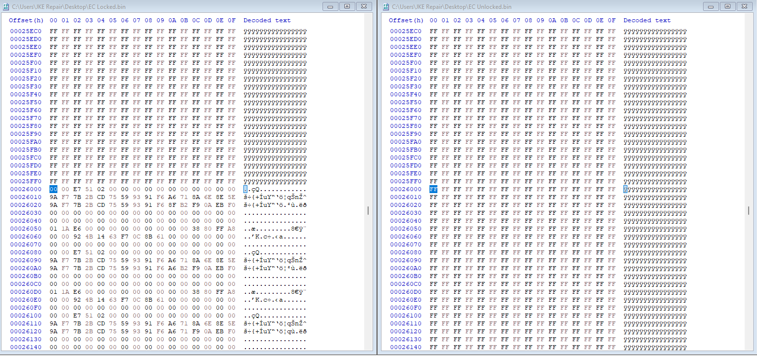

                                        #99
                                        can someone help remove the password:
                                        LENOVO YOGA 11E LLA--117833-1M
                                        Type 20LM
                                        SN:R9-0QZB16
                                        here my original bios and EC file (NPCE288 256kb)
                                        • joby91
                                          • Sep 2018
                                          • 43
                                          • german
                                          #100
                                          For anyone still searching for solution here it is:
                                          The password is stored in EC chip NPCE288 from 0x2600 to 0x2647. Just fill in with FF.
                                          Here the Screenshot and also my locked and my unlocked EC file.
