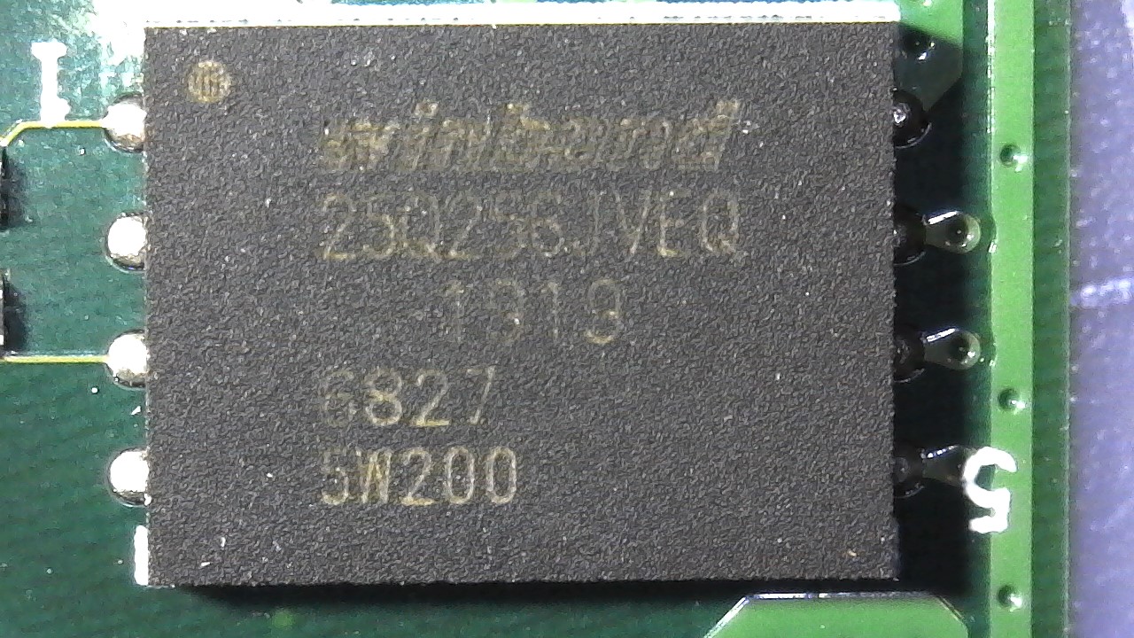

      I found the W25Q256JVEQ Bios chip. It is a 8-WDFN Exposed Pad type chip. How do I connect to it and read it?
      Sorry for the newbie questions. I never came across one of these chips.
                Solder the wires to the chip pins

                                    Hi Guys
                                    My Laptop most likely bricked my laptop after Bios Update...
                                    Resetting no success.
                                    Now i took out the bios chip (25Q256JVEQ) and read the bios in the RT809F ISP Programmer (?correct?).
                                    I did two readings, please look at the attachments.
                                    Can may be someone provide me with a working bios to flah on... as a last resort chance...
                                    model : Thinkpad X1 Carbon 7th Gen
                                    motherboard: FX490 NM-B861 Rev: 1.0 (2019-03-28)
                                    serial number: PF-1RWX6S (19/07)
                                    typre number: 20QD-003AMZ
                                    many thx

                                    Originally posted by da_n0n3
                                    Hi Guys
                                    many thx

                                    • da_n0n3
                                      • Sep 2024
                                      • 5
                                      • Switzerland
                                      THX hoaca388, the provided BIOS.BIN worked perfectly.
                                      had to perform several attempts to flash the BIOS.BIN to bios-chip (RT908f Programmer).
                                      Can further use the Laptop.
