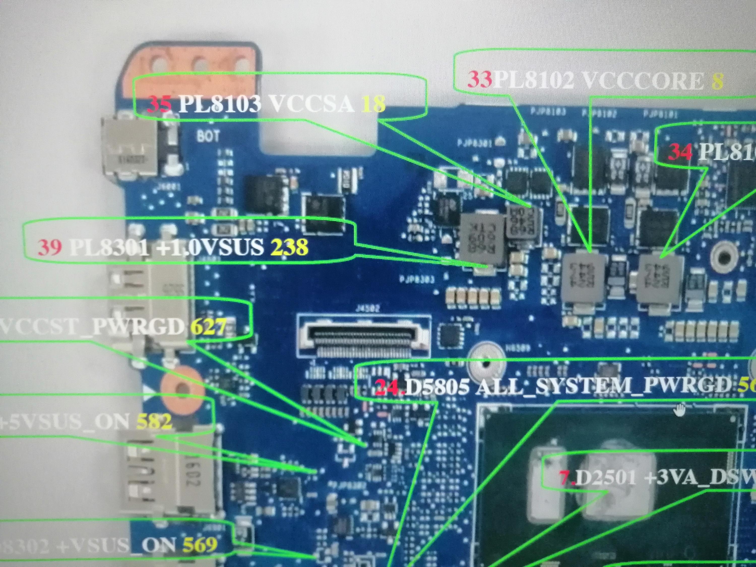

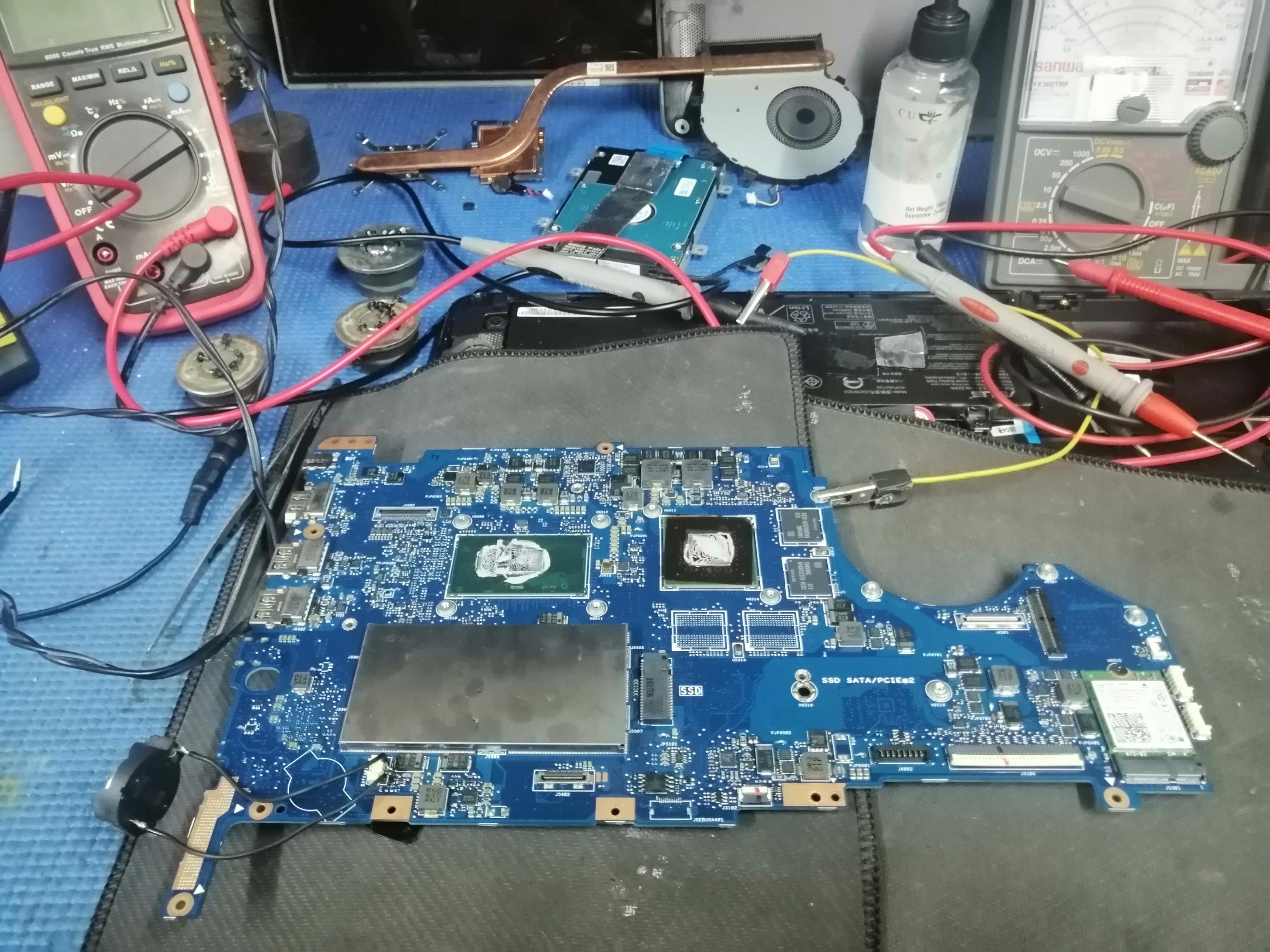

                      When charger plugin, split second consume 0.19a then 0.00a, no light indicator or power,power button no response.
                      3.3v, 5v, vreg 3.3v and vreg 5v ok, power button has 3.3v.
                      i cant find any short in all coils.
                      PL8301 1vsus and bios 3.3v comes on split second when charger plugin, when bios chip remove, 1vsus and 3.3v bios is stable.

                        • superdota2
                          • Jun 2015
                          • 64
                          • PHILPPINES
                          Re: Asus q524u

                            Re: Asus q524u
                            change the bios chip ..
                            • superdota2
                              • Jun 2015
                              • 64
                              • PHILPPINES
                              Re: Asus q524u
                              already change it, but still the same.
