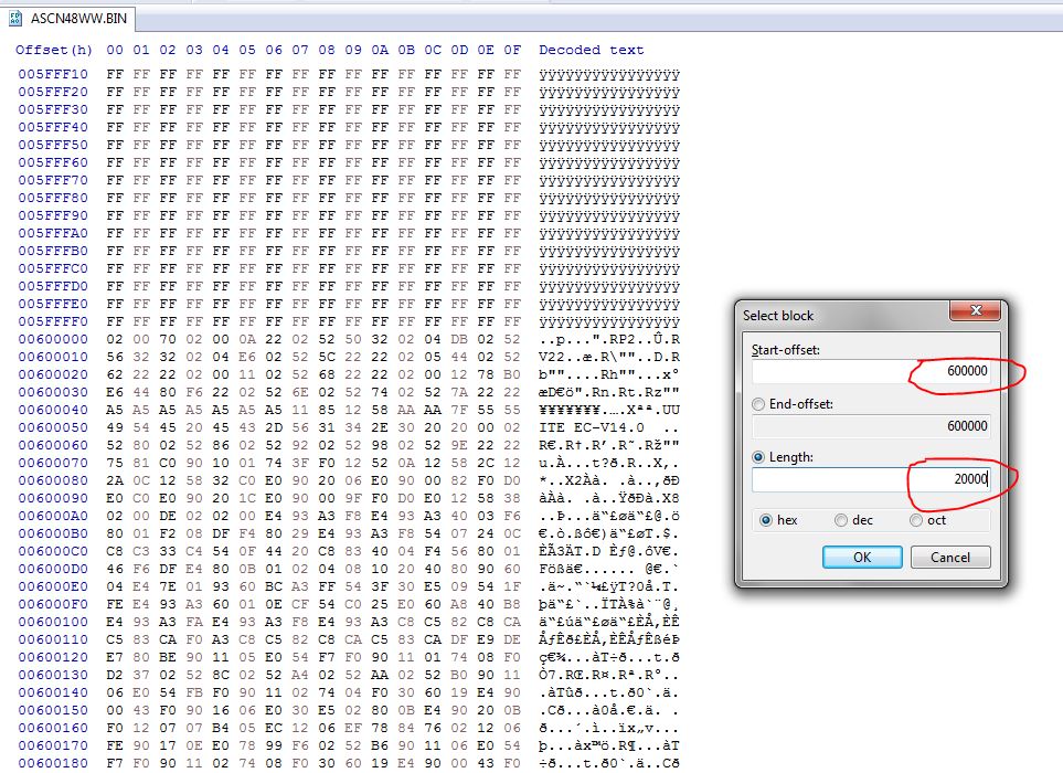

need to help to extract this bios S145-14IWL, S145-15IWL, V14-IWL, V15-IWL

      Re: need to help to extract this bios
      thanks still same i NEED EC on this also IT8586E please
        • 22080
        You can copy it from the bios. Open with HxD and select "Edit" then "Select Block" , enter the values shown in the picture, start-offset 600000 (six hundred thousand) ,and the length 20000 (twenty thousand) and click OK ,then select "Edit" and "Copy" ,then select "File" then "New" ,then select "Edit" then "Paste Insert" then select "File" then "Save" .
        HxD https://mh-nexus.de/en/downloads.php?product=HxD20

        • String2016
          • Nov 2015
          • 2238
          • philippines
          I follow your advice use the bios from post#2 save it but still 16mb, could you please post it here the EC file thanks

            • Claudiomfa
              • Nov 2015
              • 455
              • Portugal
              ec file extracted
              • qayyum786
                • Aug 2018
                • 1959
                • INDIA
                Sir SMDFlea how to recognize EC file start offset from dump
                TIA
