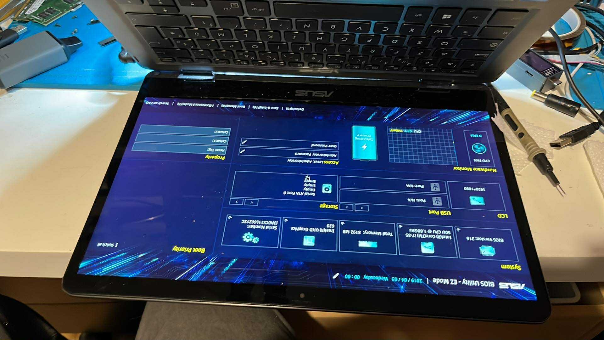

                I changed the cpu. The computer is displaying late and the fan is running at full speed. I tried clean me and I couldn't. original bios is attached please help me for celan me

                    thank you so much. the image is ok but the fan is still running at full speed even though the cpu temperature is normal.what could be the problem?

                      There are have two ME files, NPDM and YPDM. Try again with YPDM, good luck !

                        thank you but same problem. Fan full speed working

                          New bios with latest ME version.
                          If not working fine, try fine other problems.

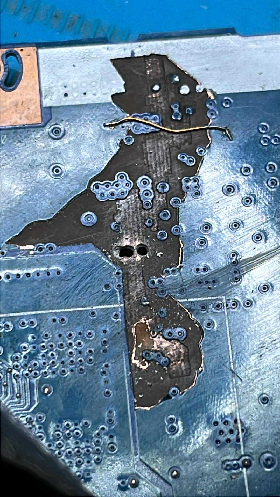

                              • Maxpower3
                                Bad Veteran
                                • Feb 2018
                                • 1375
                                • France
                                always respecting mechanics.
                                dodgy repair
