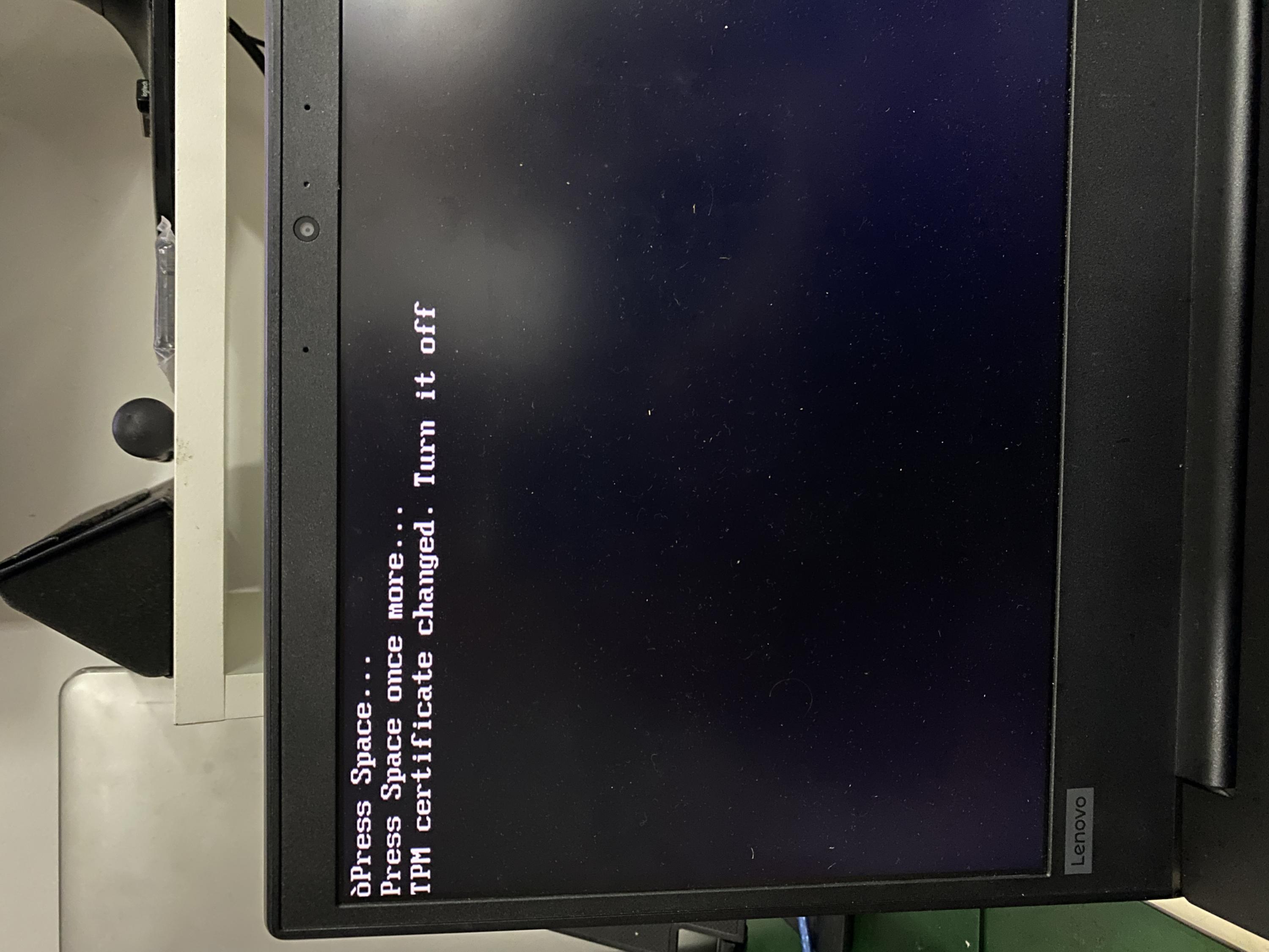

      dear friend .. I have same notebook and this write
      lenovo bad crc of security settings in efi variable
      bad svp data stop post task
      and stop .. is it from bios?
      I can t find bios ..Autside from badcaps find 2 bios but they didnt work..

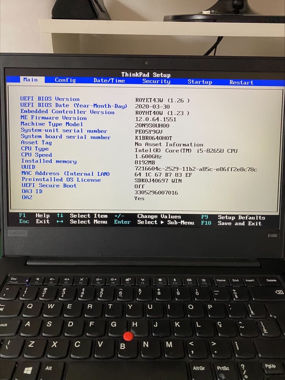

          can somebody Patch The bios for me it is from lenovo E490, Grateful for the help.
          Regards

            Post the full model number and machine type

              its Type 20N9-S1HC00.
                • 21439
                Re: Bios crashed in E490 update bios
                Try this one.If it boots up ok run the bios update from lenovo to flash the EC .

                    I didn`t patch it. What KBC does it have ?
                      • 21439
                      To answer my own question its a IT8227E-256

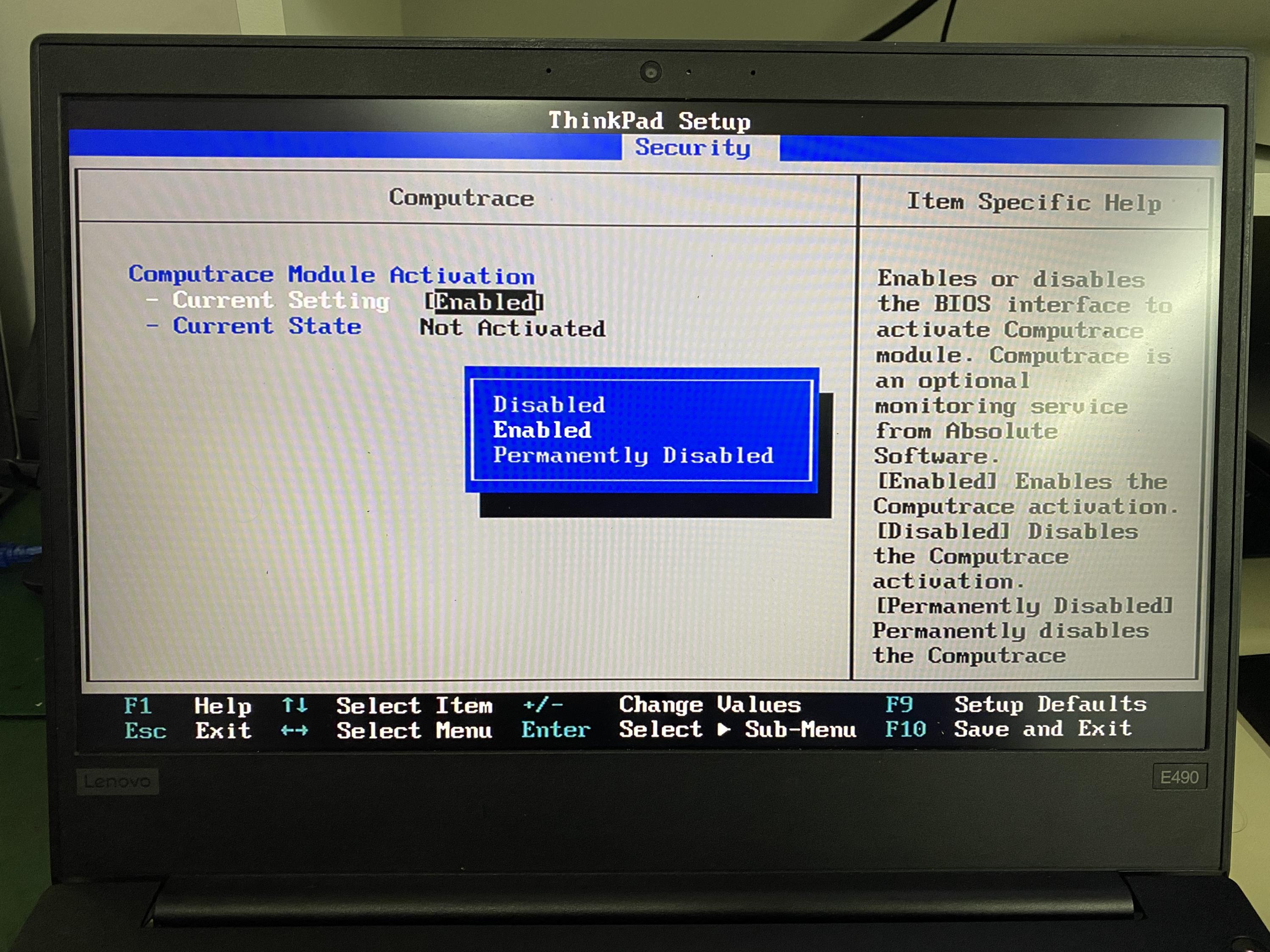

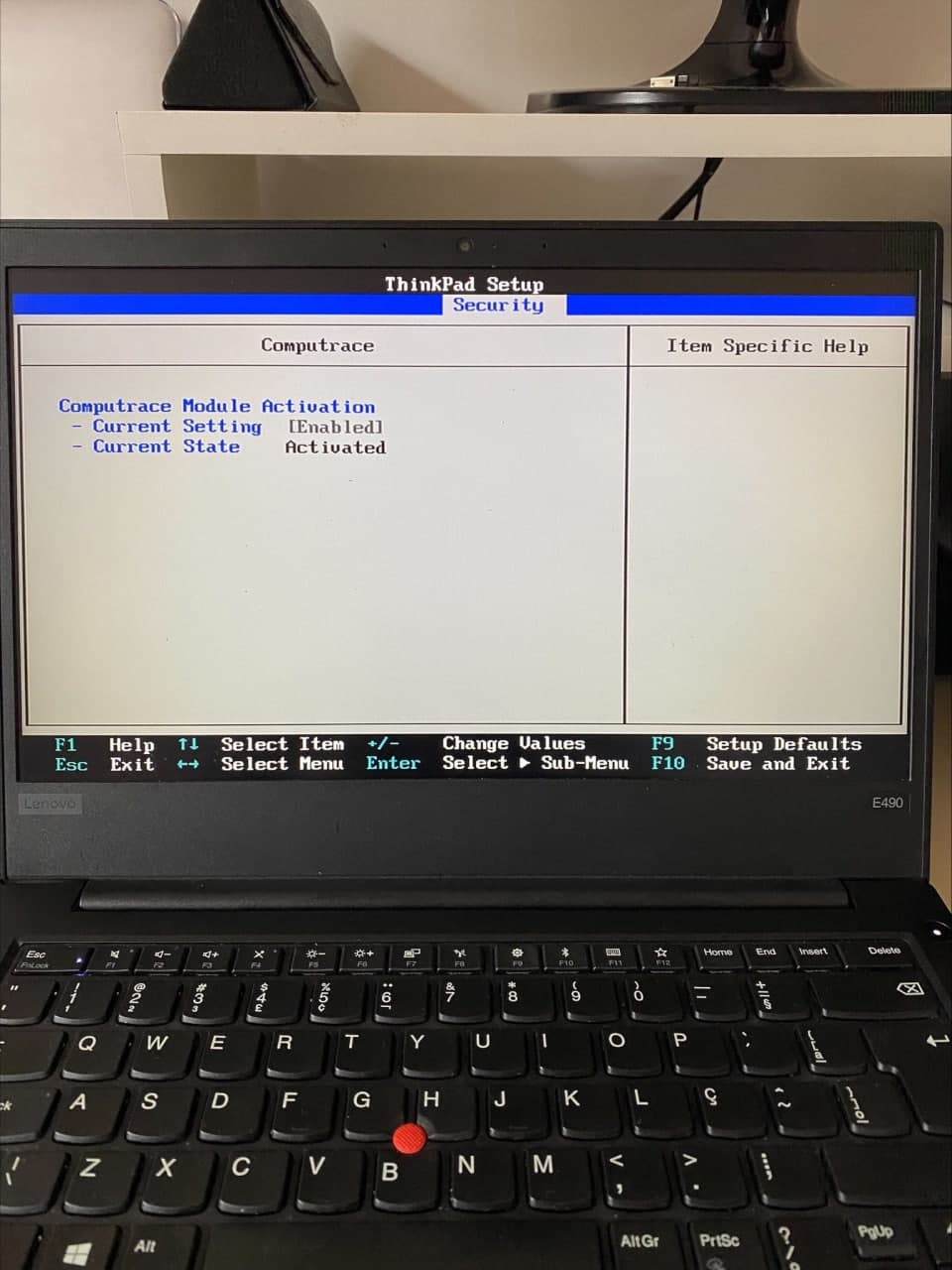

                                    I found out that the machine is only with computrace enabled, you can move the machine to install the system, but I can't disable the computrance, would I be able to solve it?
                                    • santoslao
                                      • Apr 2017
                                      • 126
                                      • BZ
                                      I thank the forum but I managed to solve it...
