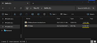

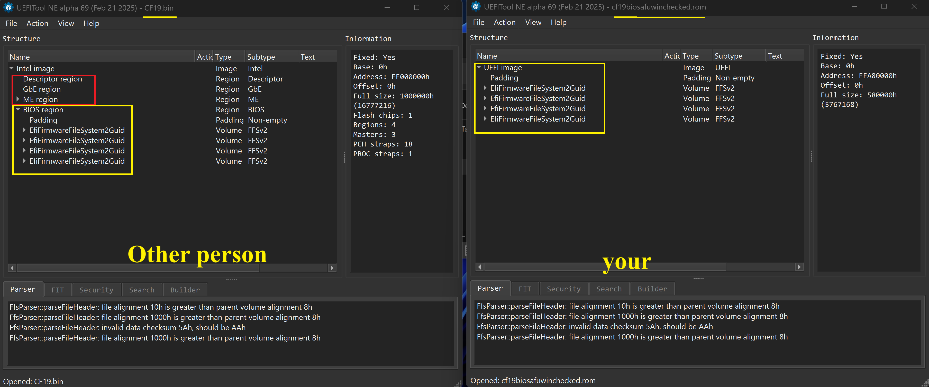

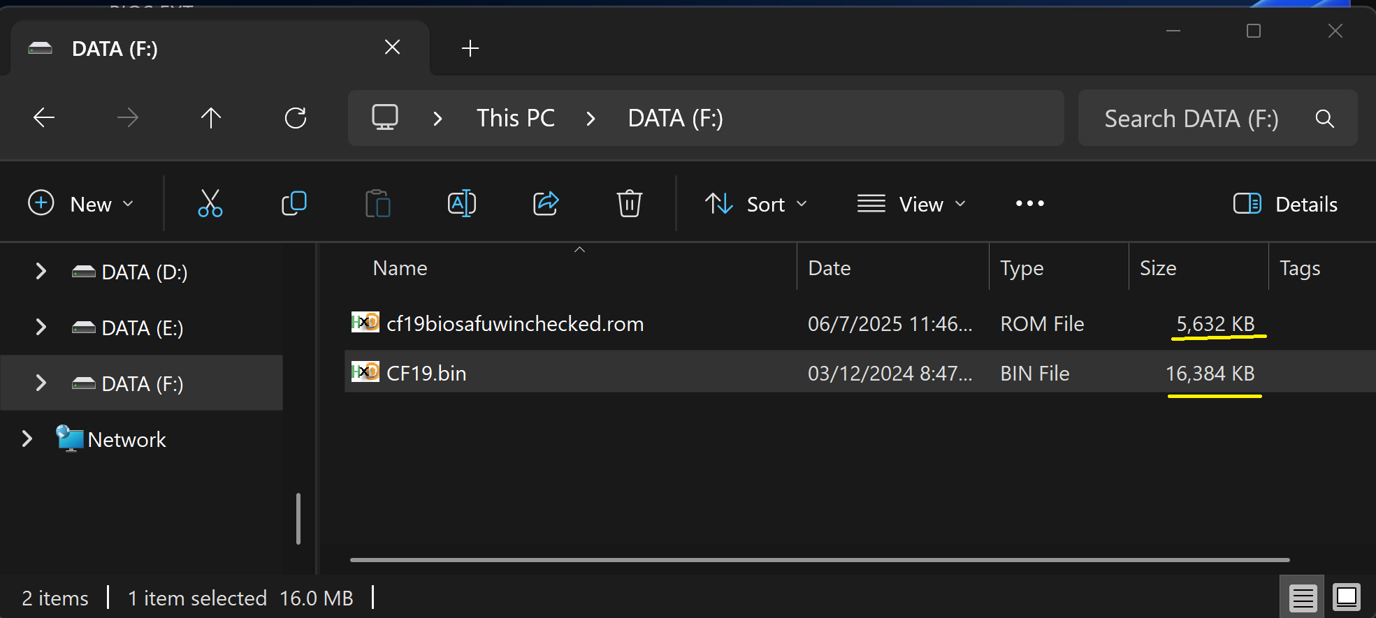

                                    okay, after buying a ch431A and an ezp2023+, not able to even recognize the chip I tried using the Afuwin tool and the decrypyter, no idea how to make that work either.
                                    hopefully this dump will be useable:
                                    CF-19 MK6
                                    CF-191DYAX1M 2LKSA91956
                                    DFMD2182
                                    Please help
                                    • hoaca388
                                      Badcaps
                                      • Jan 2022
                                      • 11572
                                      • Viet Nam
                                      #38
                                      CF-19 MK6
                                      DFMD2182
                                      Please help
                                      The difference between backup with Afuwin and backup with programmer.
Name:	2025-07-07 20_30_27-DATA (F_) - File Explorer.png
