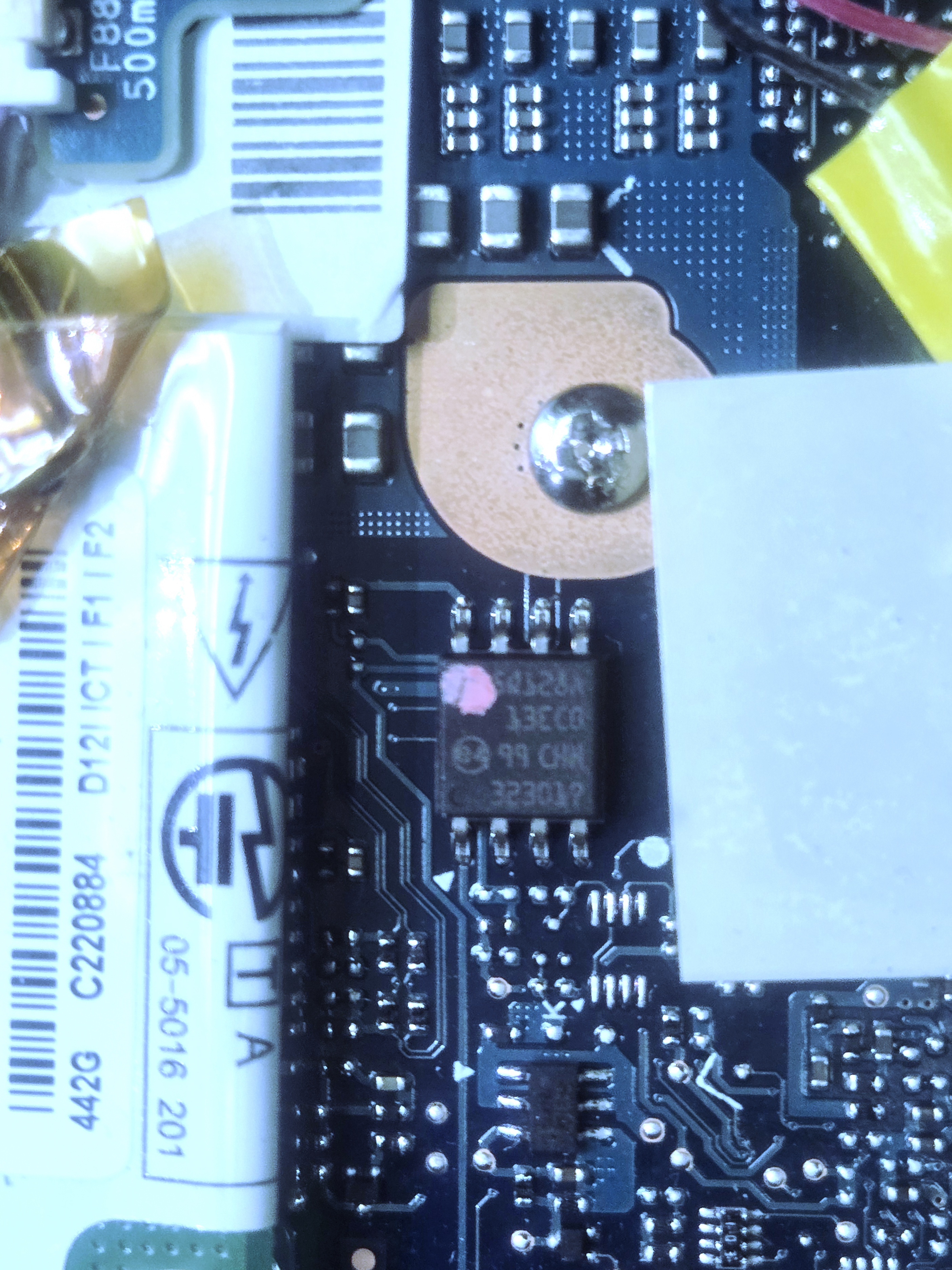

    I could be confused, butbi beleive it is Micron 25Q128A. When I set the ch341 to it it still could not read.
    • hoaca388
      Badcaps
      • Jan 2022
      • 12354
      #42
      Micron 25Q128A
      It is 2.7vol to 3.6vol

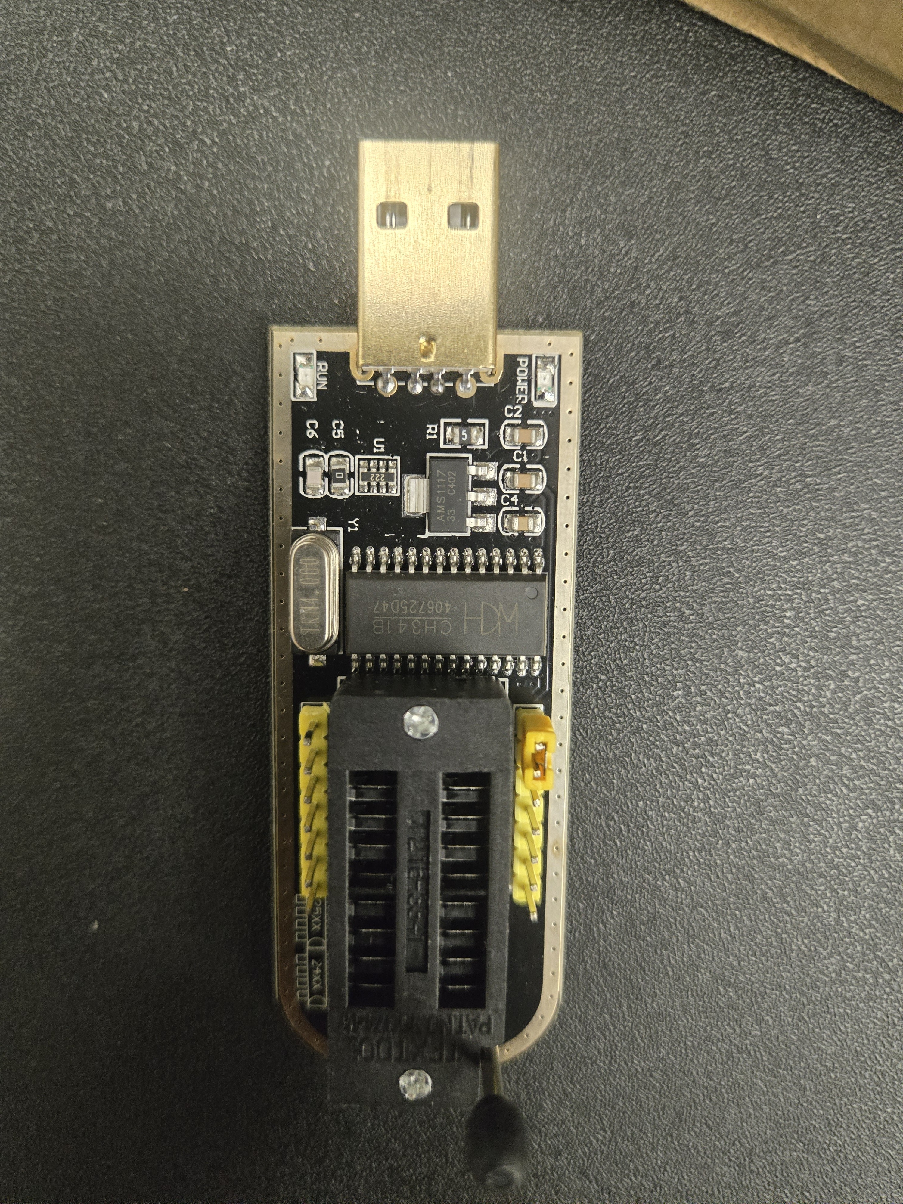

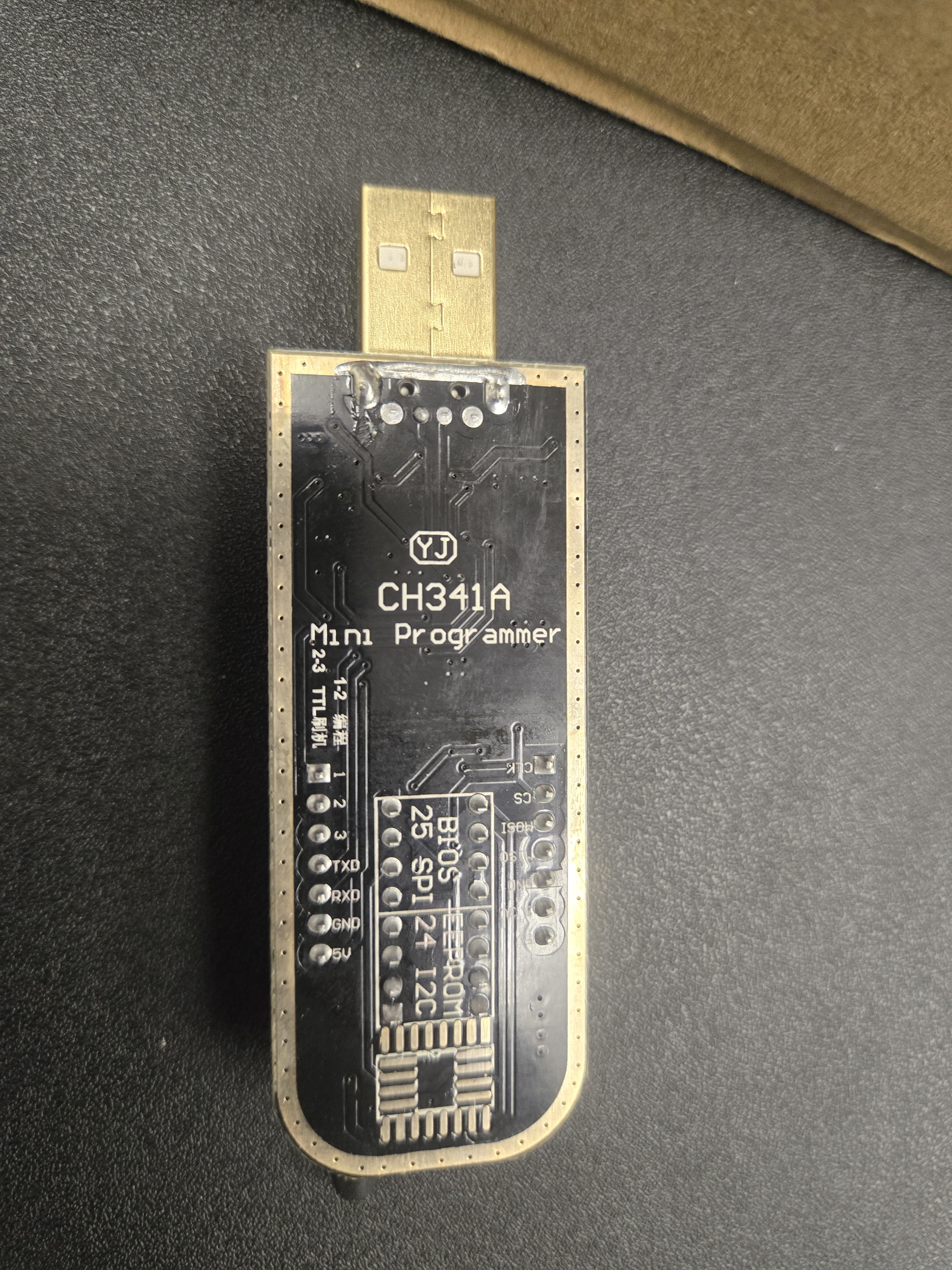

        OK, thank you very much for clarifying. I do not have the correct adaptor, I have read of a flaw in the programmer, that it will apply 5v i am uncertain if the one I have is fixed, there was no documentation sent with it, and the company website does not exist.
        Maybe someone could identify it.
        • Cpaka
          • May 2025
          • 11
          • canada
          #44
          Okay, i said Yolo, it read fine with neoprogrammer, awesome software.

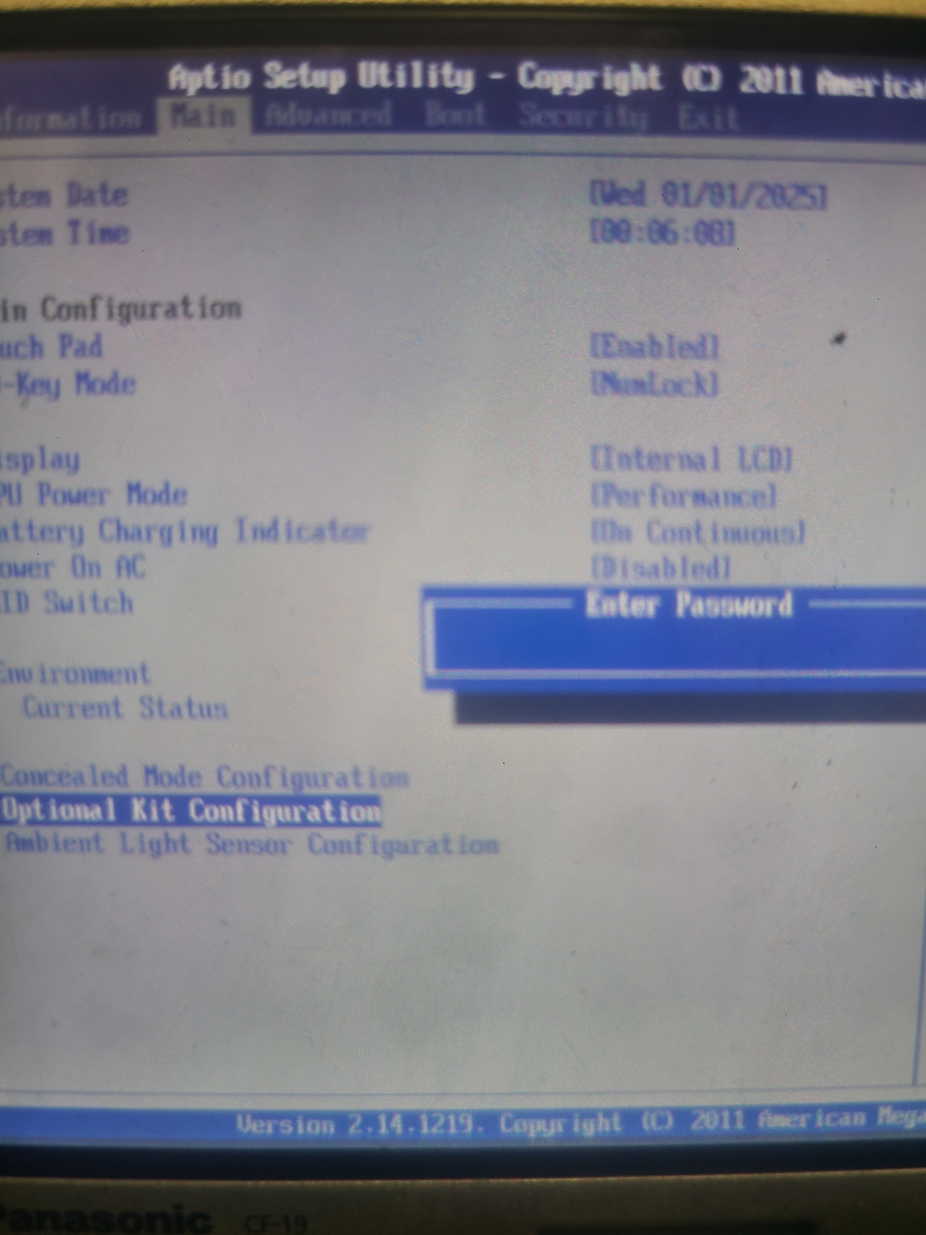

                now I just need to figure out what "optional kit configuration" is, and how to unlock that haha.
                • danito
                  • Jun 2016
                  • 1108
                  • Romania
                  #48
                  worked! thanks again!
                  try toughkit
                  • Cpaka
                    • May 2025
                    • 11
                    • canada
                    #49
                    Originally posted by danito
                    try toughkit
                    that was it, thanks!
