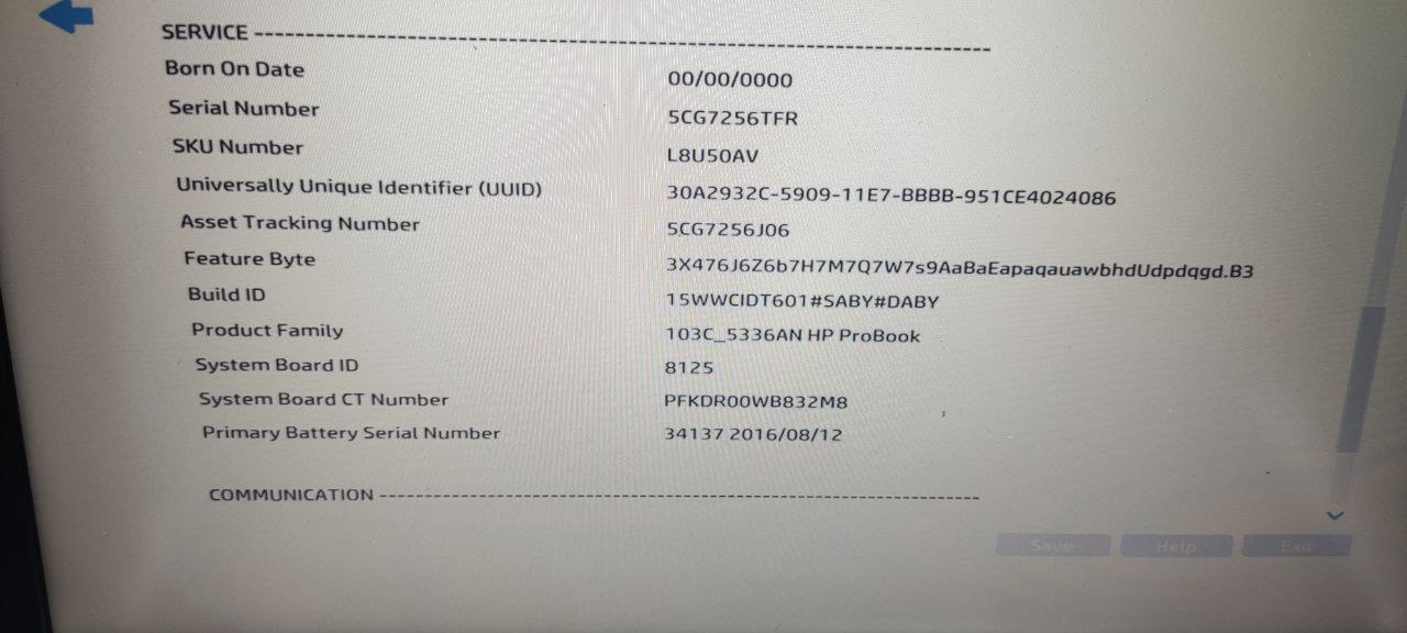

                                  hp probook 652 g2 error feature byte
                                  6050a2740001-mb-a01
                                  BIOS has been charged
                                  https://www.badcaps.net/forum/attach...6&d=1599999605
                                  with this file
                                  Enter the serial number and everything
                                  But it is not accepted
                                  feature byte
                                  I ask my friends to edit the file
                                  Note that a backup copy is not available
                                  The information is deleted from the device

                                      Scan QR Code on the label, above the text. Sometimes a letter is not printed (the label is too short).
