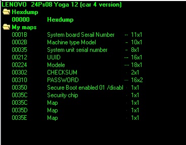

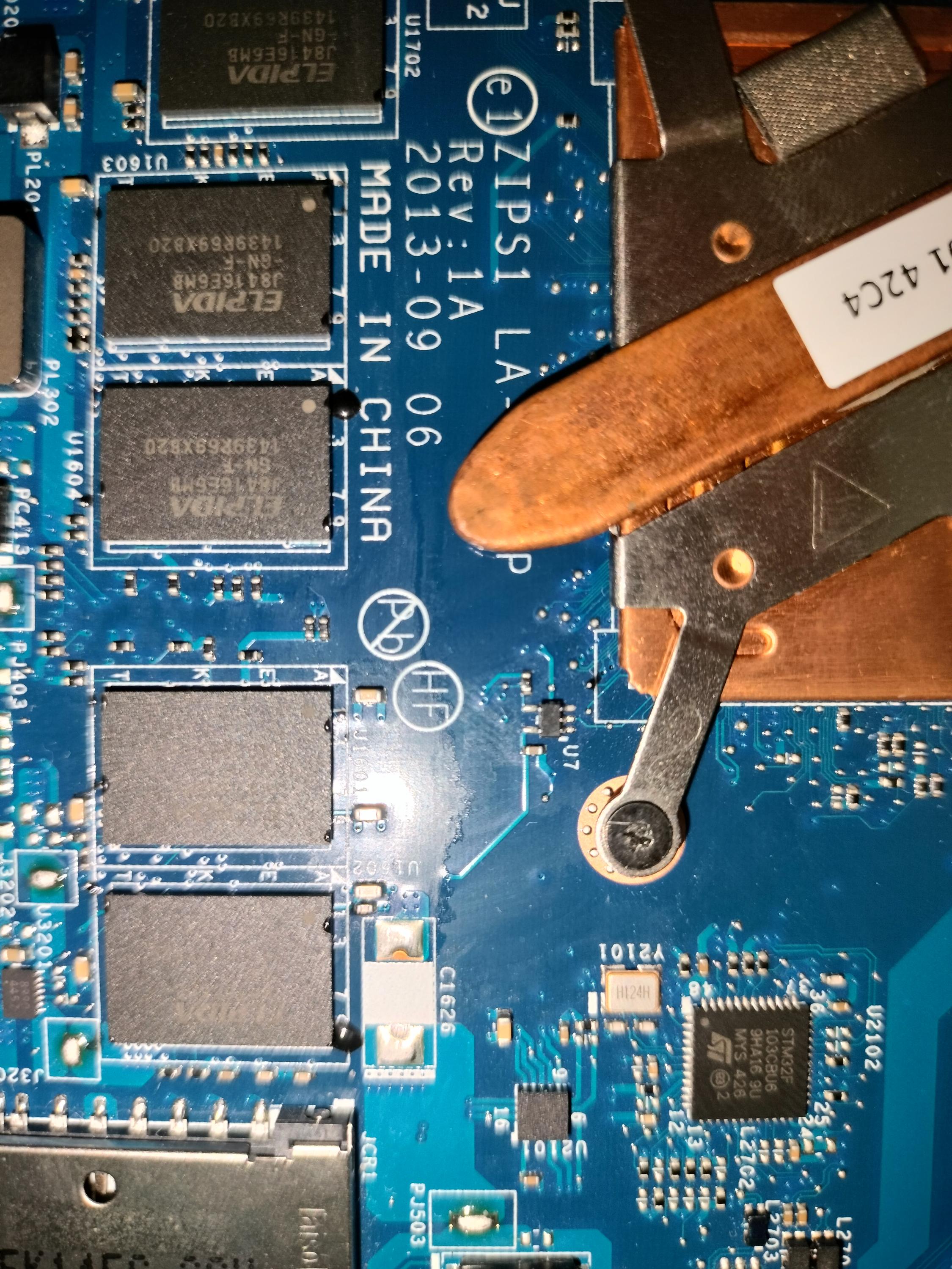

            • estabilito
              • Aug 2020
              • 54
              • poland
              Re: Thinkpad Yoga LA-A341P BIOS
              Any idea how to remove supervisor password from this motherboard?
              I flashed the bios and kbc but password is still here. Password is gone only if i remove the eeprom chip so i Think that the password is there but this is write protected chip and i cant do anything.

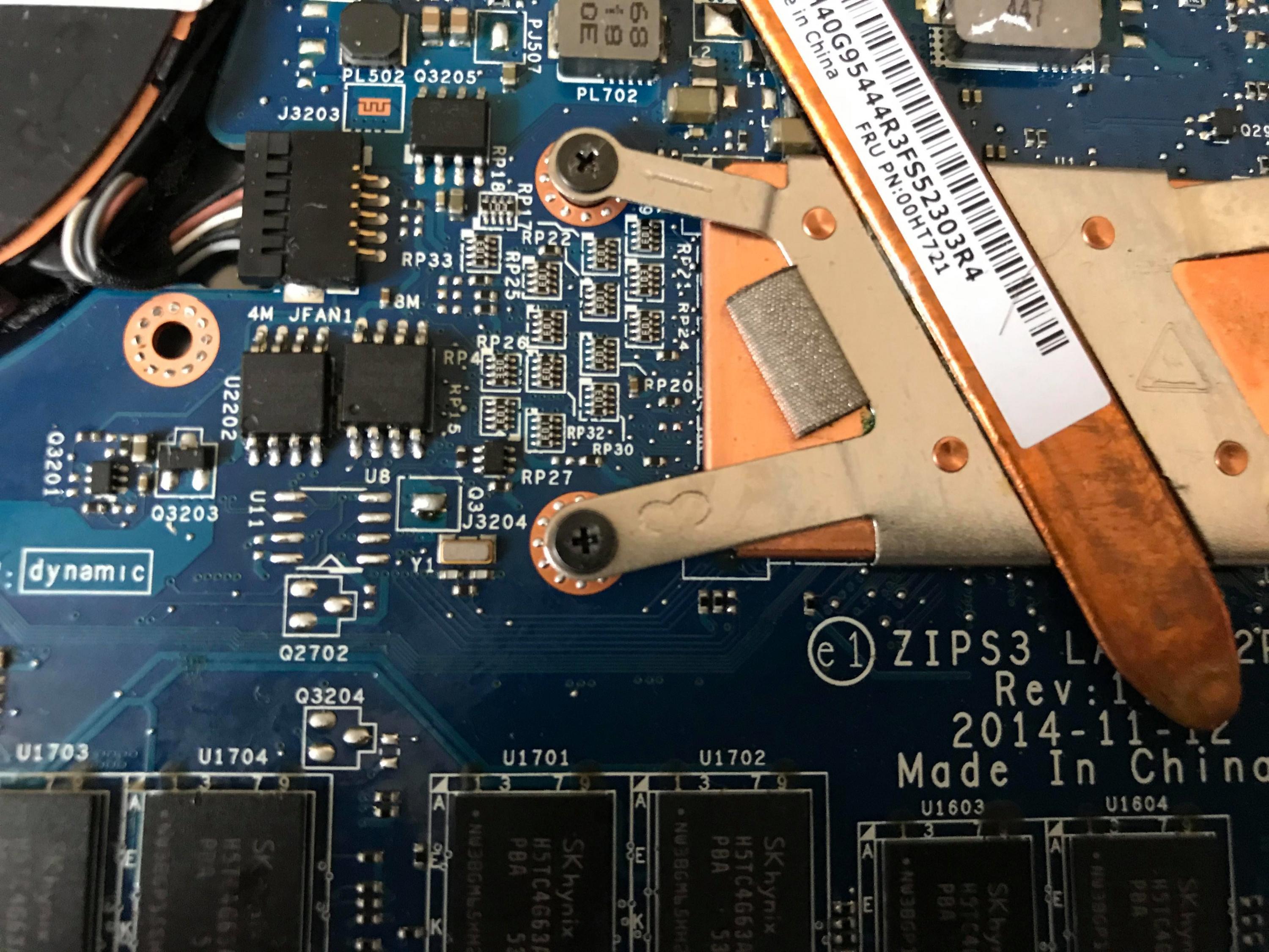

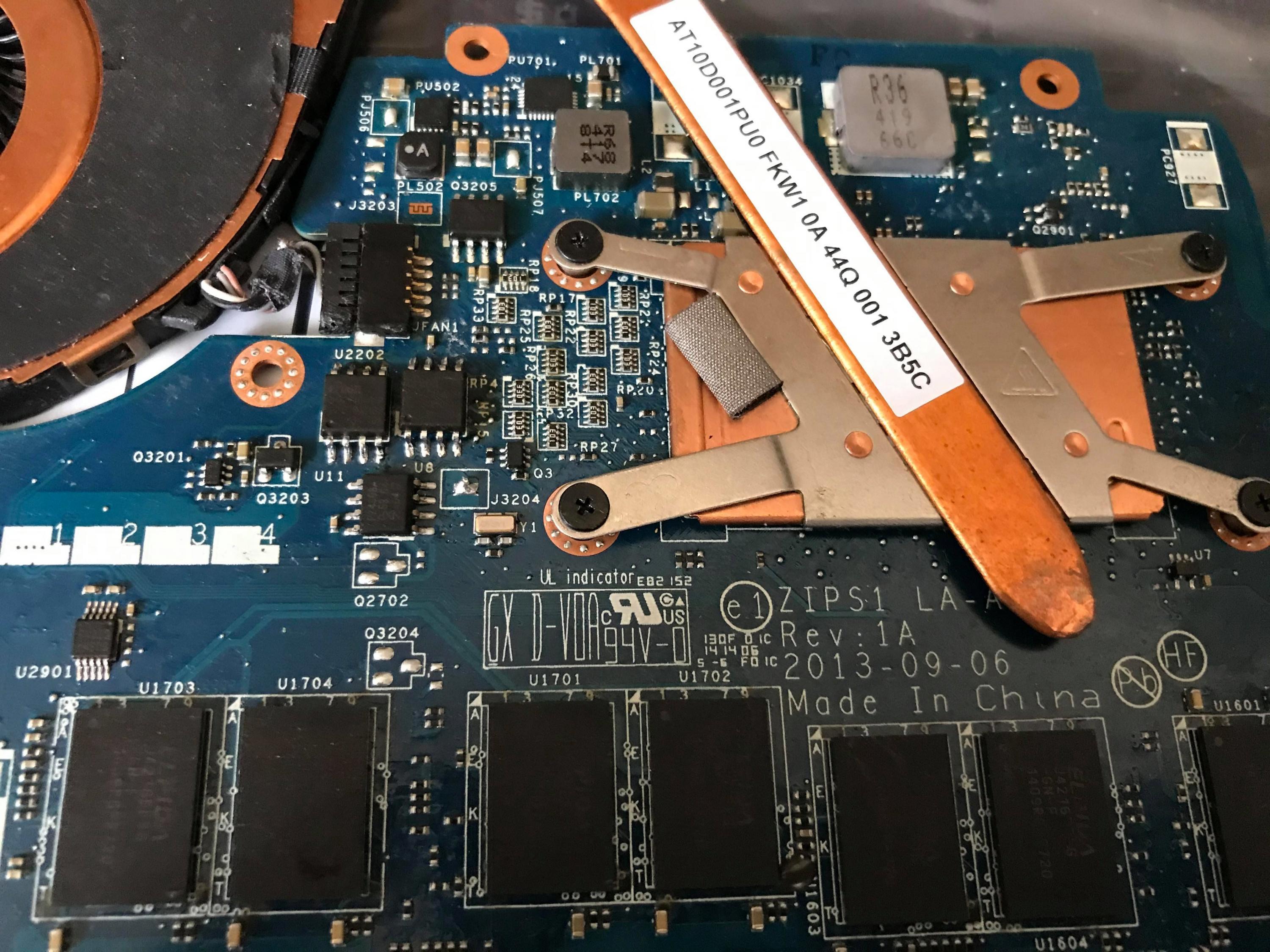

                LA-A341P : 2x bios and 24rf08 + EC
                LA-A342P : 2x bios and EC
                the 24rf08 or p24s08a reads very well, this eprom is not locked
                or bypass password with shunt on 24rf08 between scl and sda when backlight come and F1 to enter setup.
                • estabilito
                  • Aug 2020
                  • 54
                  • poland
                  It work's, thank you!

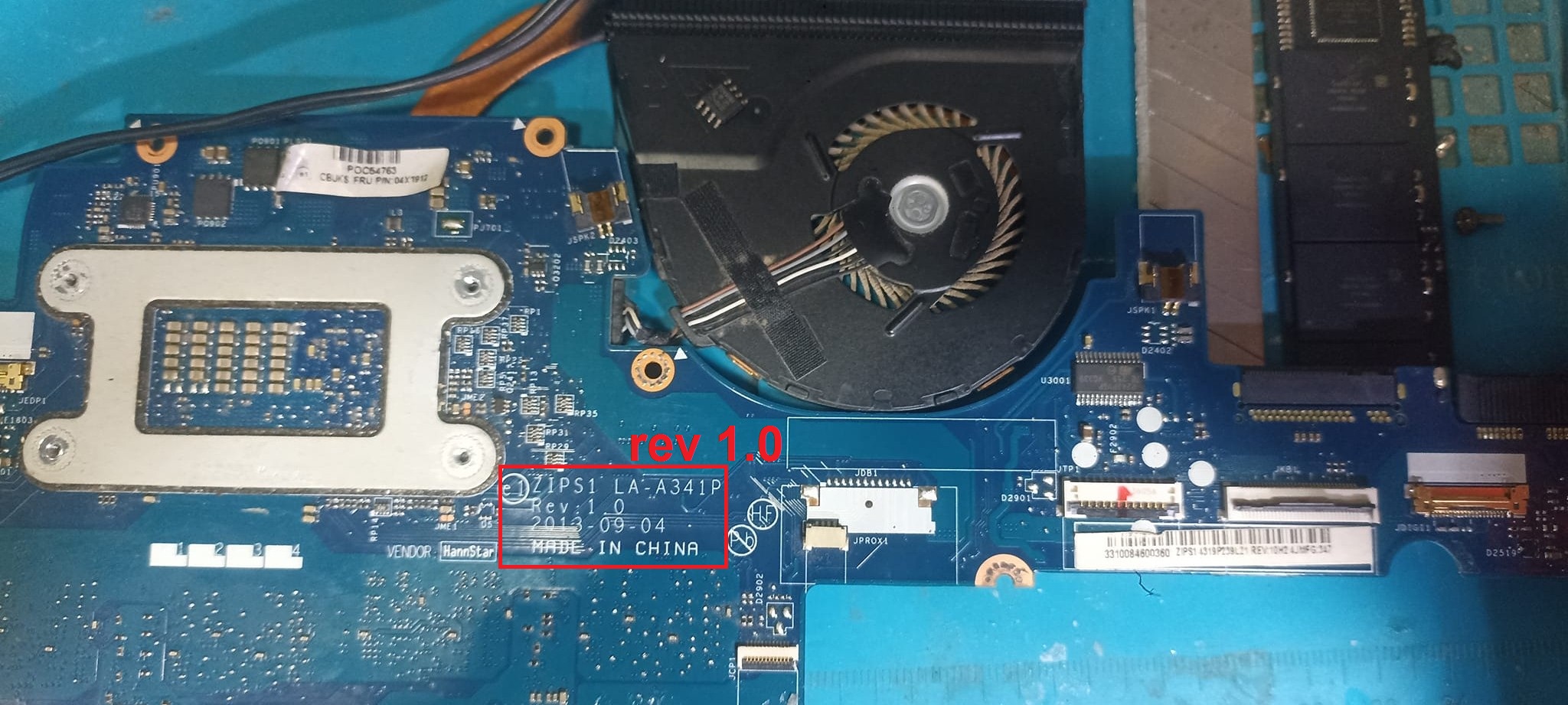

                              • corona100
                                • Mar 2020
                                • 145
                                • U.S.A
                                Lenovo LA-A341P REV 1.0 bios request
                                hello guys looking for lenovo LA-A341P REV 1.0
                                REV 1.0 Not the A1
                                • peste
                                  • Dec 2016
                                  • 12859
                                  • ROMANIA
                                  Re: Lenovo LA-A341P REV 1.0 bios request
                                  REV 1.0 Not the A1
                                  post the full name and model of the laptop

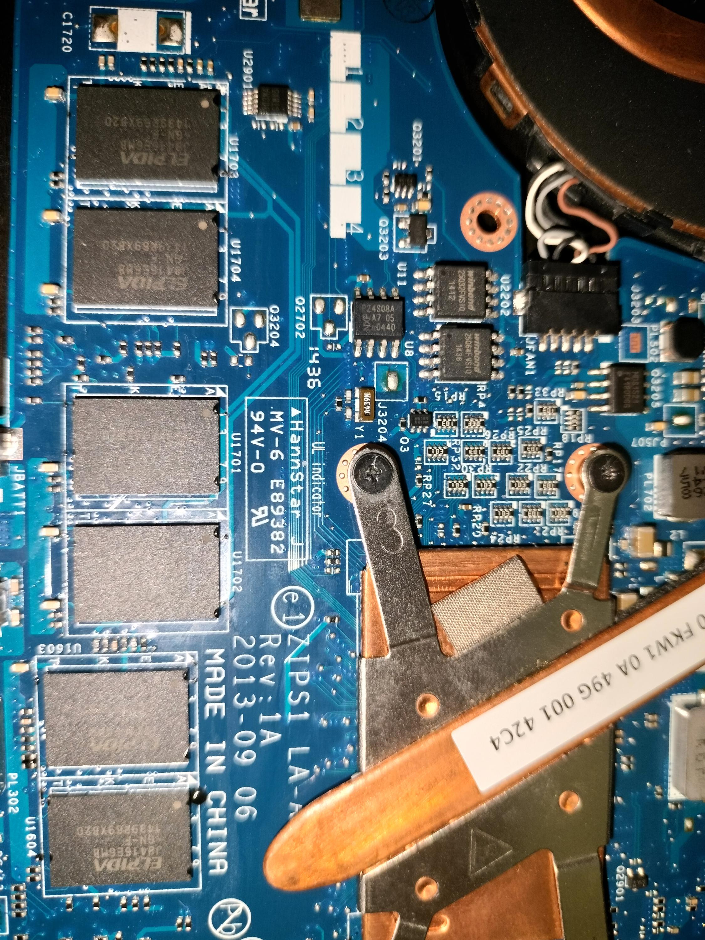

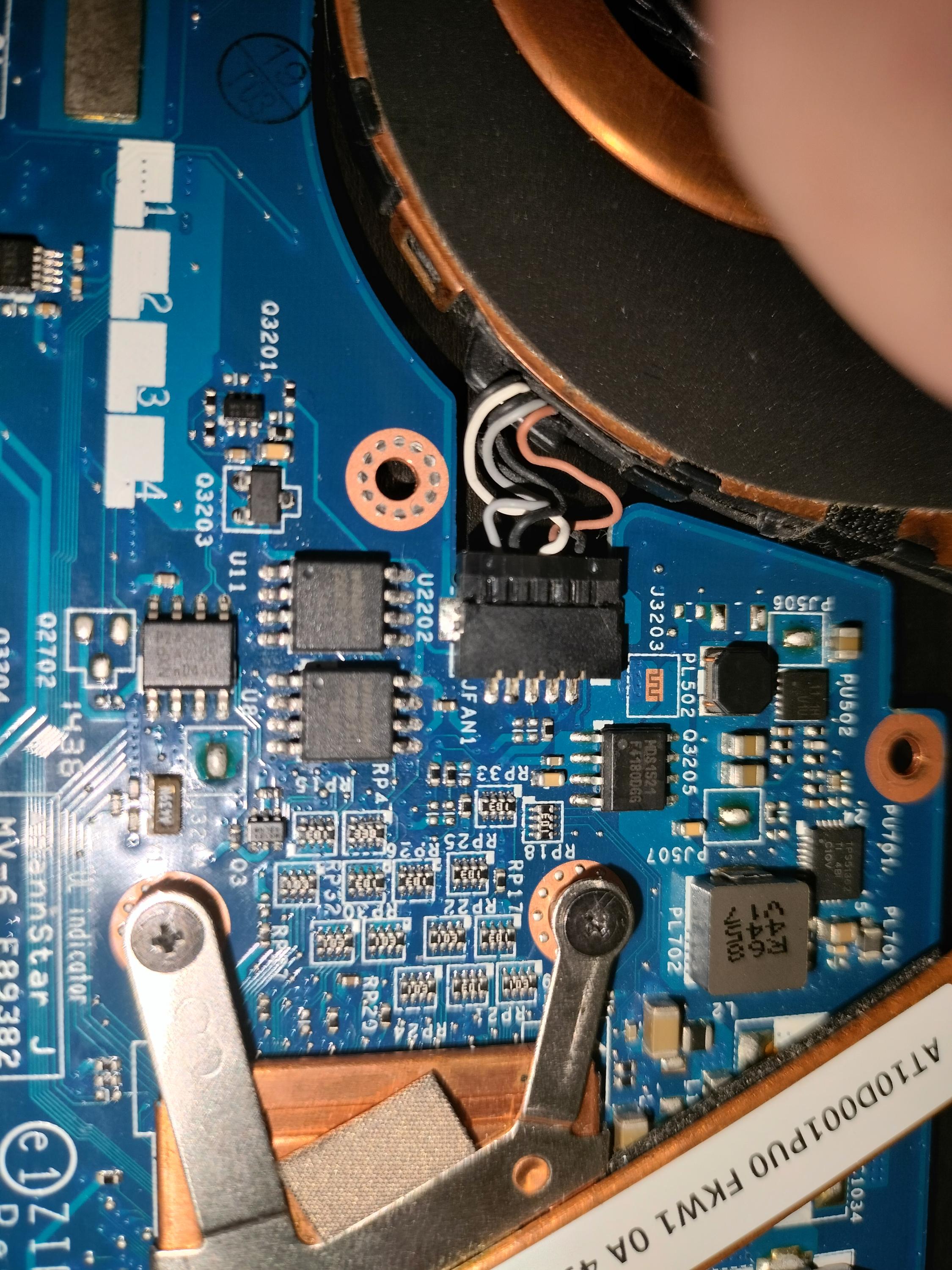

                                    Could you highlight the scl and sda in an image, also what is the optimal way to shunt it to unlock password, as the chip is rather difficult to access if the full frame is assembled
                                    thanks -M3troid

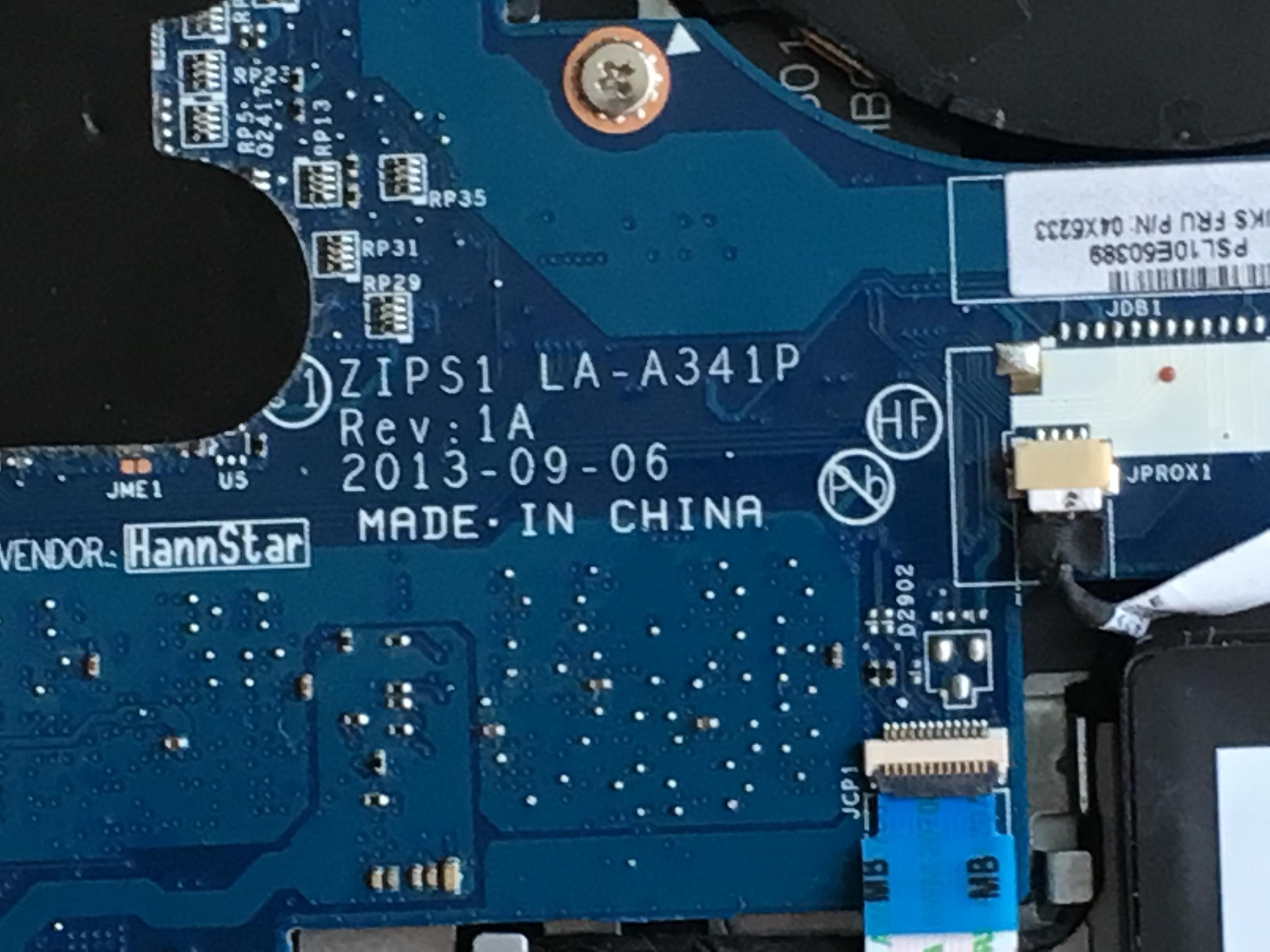

                                      my apologies, images loaded after a reload of the page, images clarify very well.
                                      did you initially use the bioshunger bios to achieve unlocked password, i take it this one is not ME neutered, i can achieve this myself once i arrive home
                                      • m3troid
                                        • Aug 2022
                                        • 4
                                        • georgia
                                        i tried shunting after i had succesfully used the bioshunger files to troubleshoot that indeed the bios chip was being problematic, i then neutered IME from the original bios files and got it to boot, however i could never get past the bios password so i tried shunting it, with what i assume is very bad success as my laptop no longer boots, the fan speeds up fast shutsdown the laptop and repeats this process 3 times blinking the power LED, my assumption is from the attached images that this process somehow fried my onboard ram as the chip itself looks to be visually fine but ram chips have weird wear in them
                                        any remedies to recommend for this process or is my laptop just toast at this point i am indeed waiting to get a multimeter at this point to zero in on possible issues
