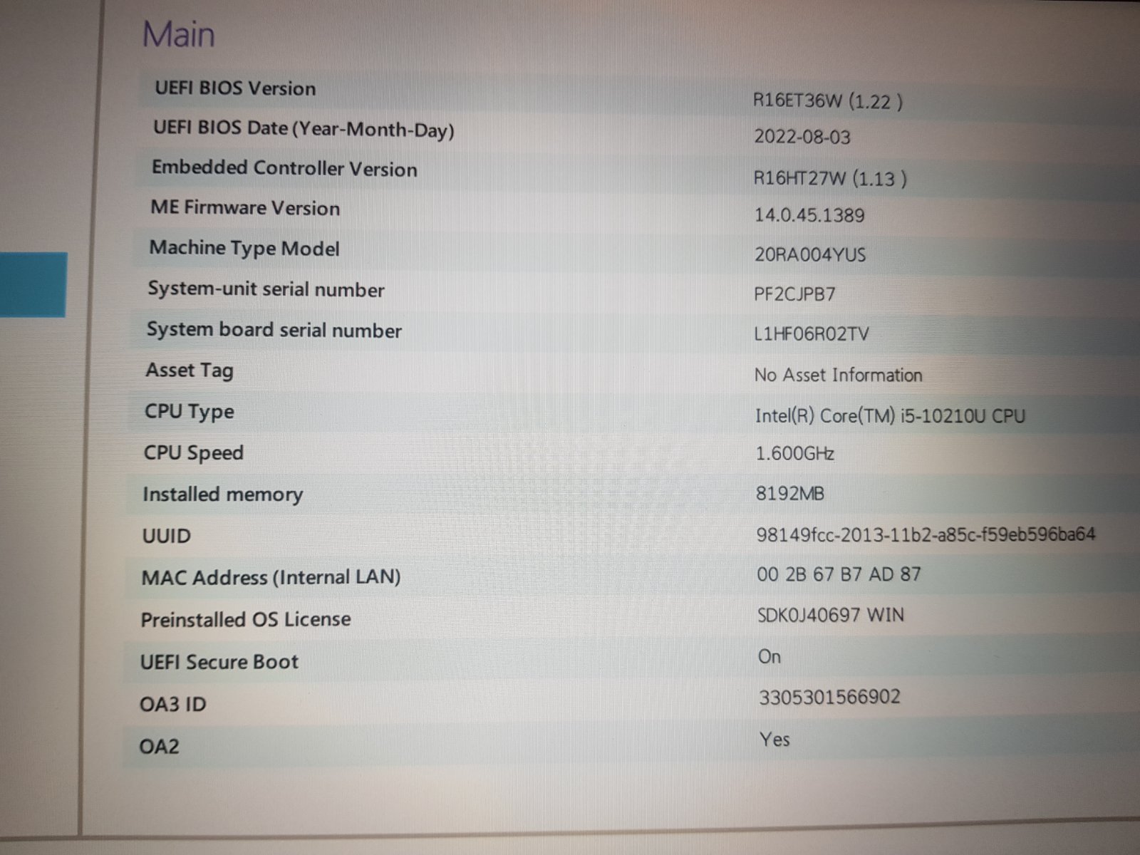

                                        Can anyone help me with this X1 Yoga 1st gen, 20frs09n05 bios?
                                        • hoaca388
                                          Badcaps
                                          • Jan 2022
                                          • 11378
                                          • Viet Nam
                                          #2020
                                          Re: LENOVO BIOS AUTO-PATCHER for Supervisor Password Removal
                                          Here
