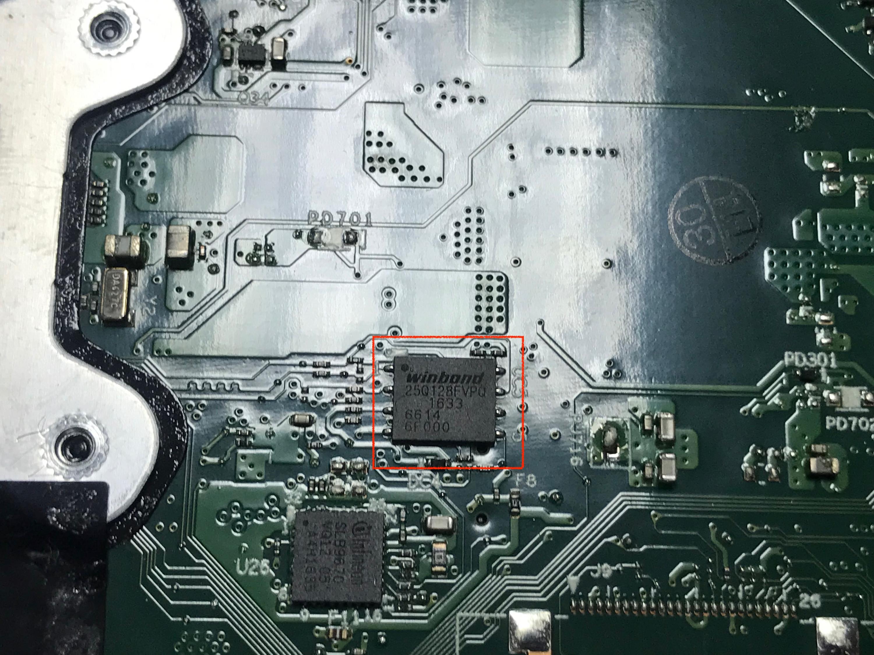

                                Hello guys.... So i having little issue. Firstly i take off different chip U28 W25Q128JVSIQ_SO8 try to patch doesnt work obviously but when i moved and patched the bios MX IC it went ok untill i try to boot up. Now i hearing only some melody (smart beep code) and that Lenovo PC app really doesnt tell me whats wrong. Any help?

                                  Re: LENOVO BIOS AUTO-PATCHER for Supervisor Password Removal
                                  Forget to say. Its x270

                                        • volinakis
                                          • Jan 2021
                                          • 2736
                                          • N/A
                                          #720
                                          Originally posted by SMDFlea
                                          Thanks, I solved the problem - on X260 is a VSON8 chipset and I used a VSOP8 chipset to unlock bios and terminals didn't solder well on motherboard and i thought the patch wasn't ok.
