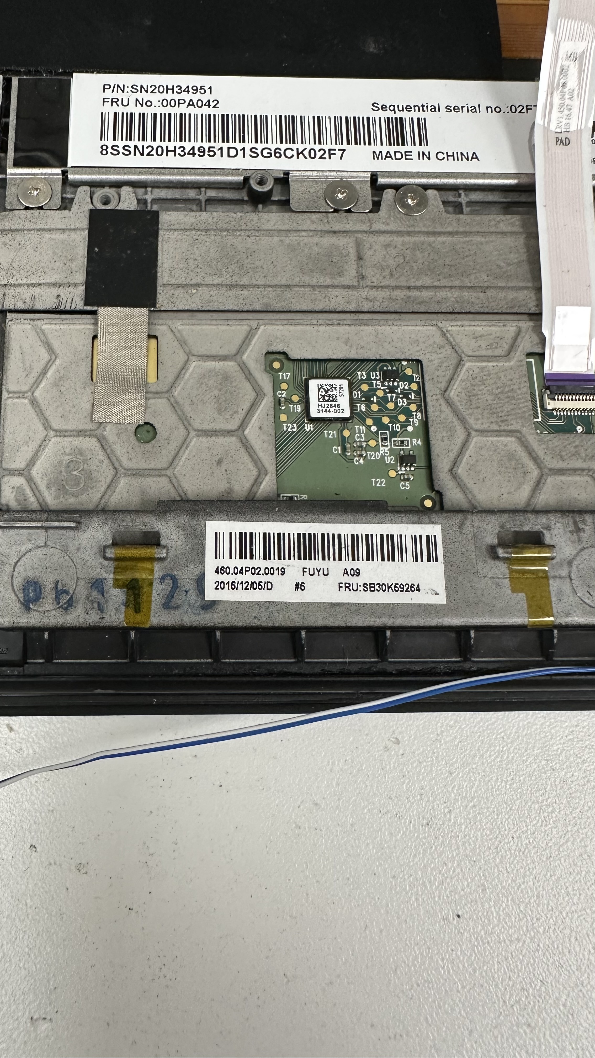

    No sticker with serial. It was removed. 🥲
    Check for sticker on the motherboard. Can't be done without serial number.

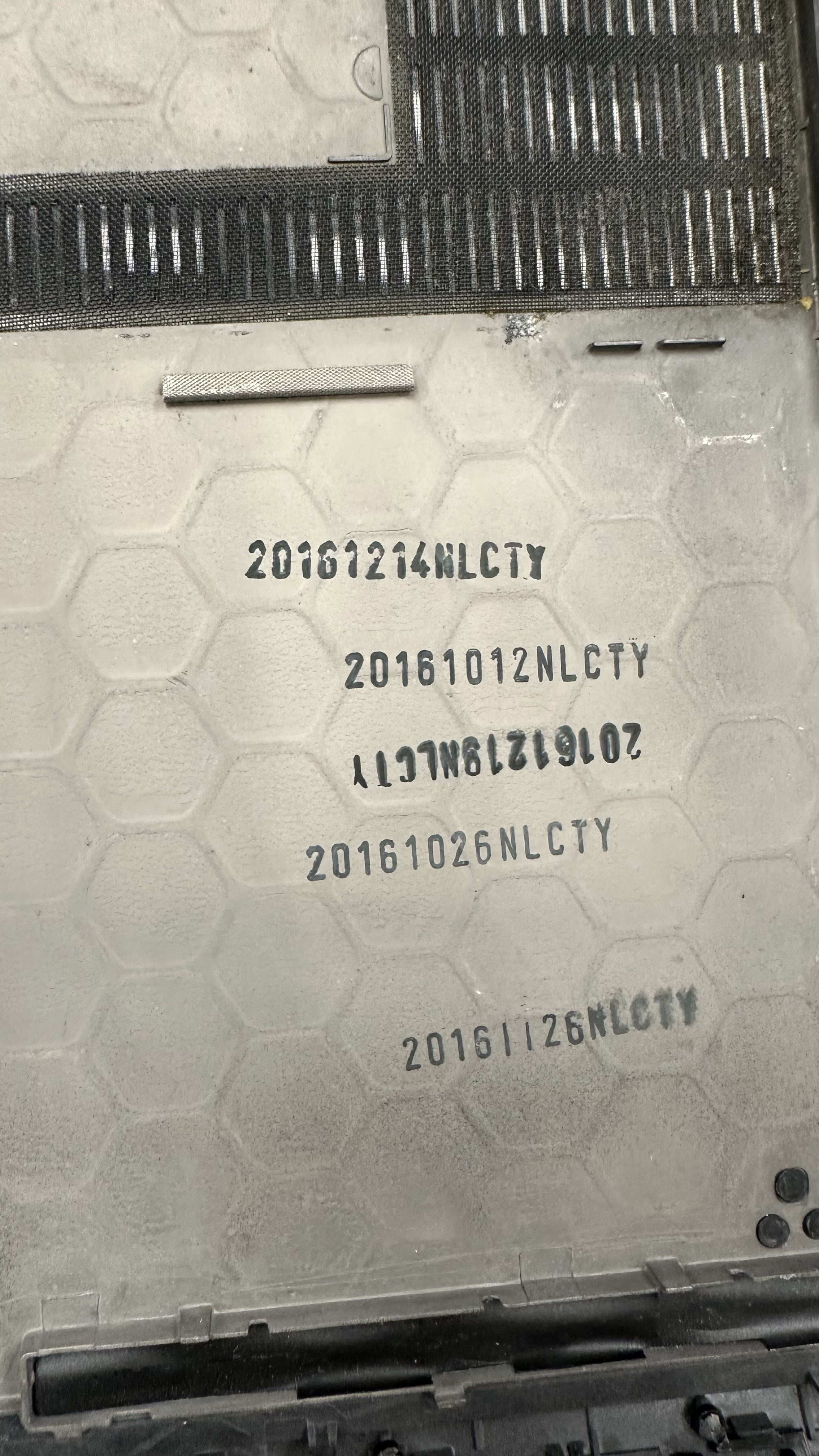

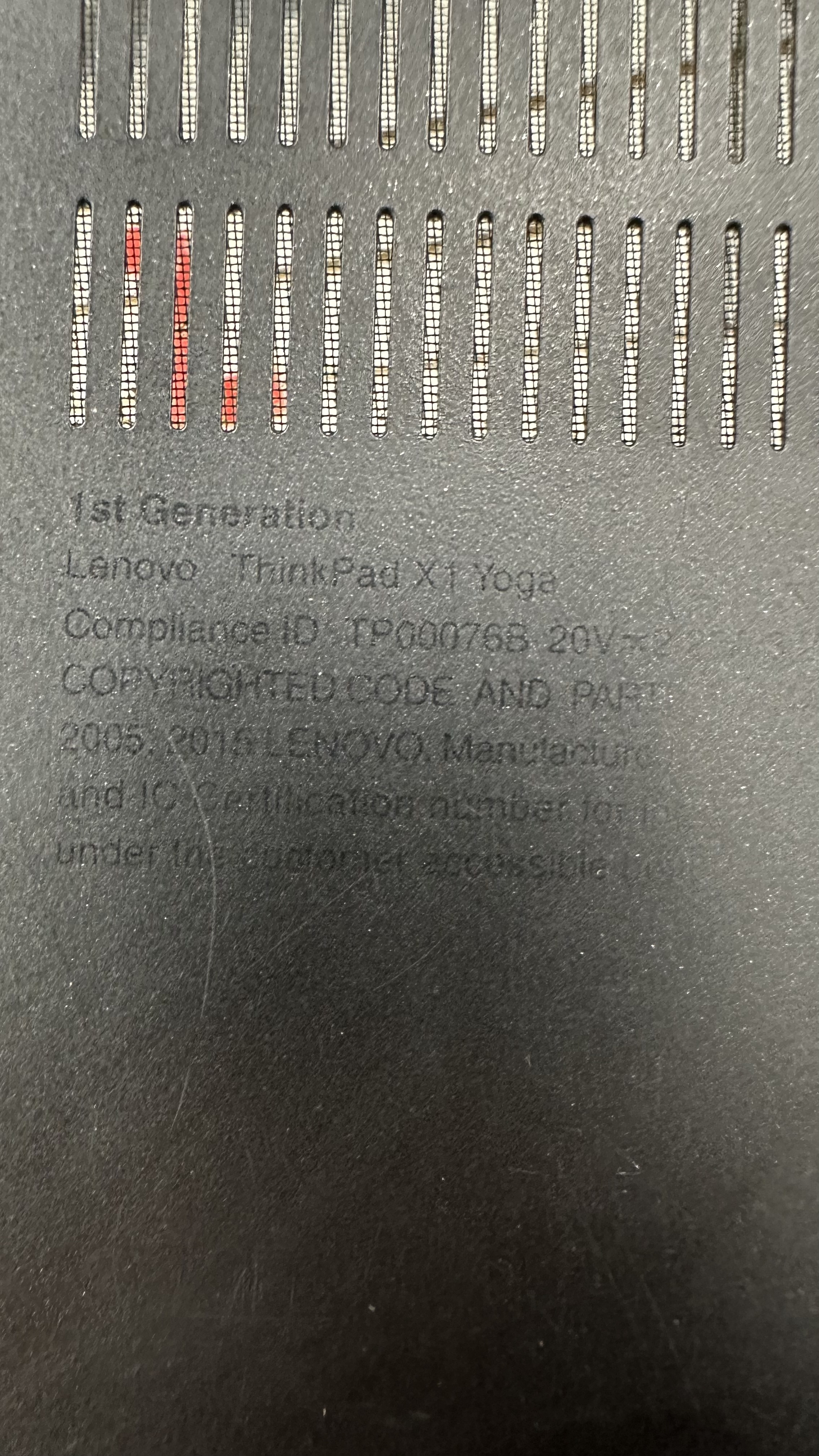

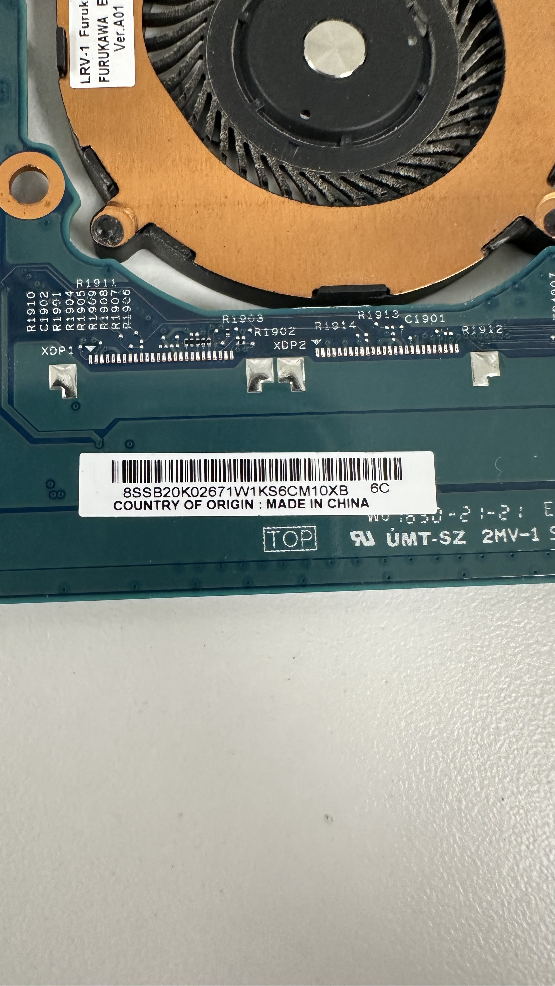

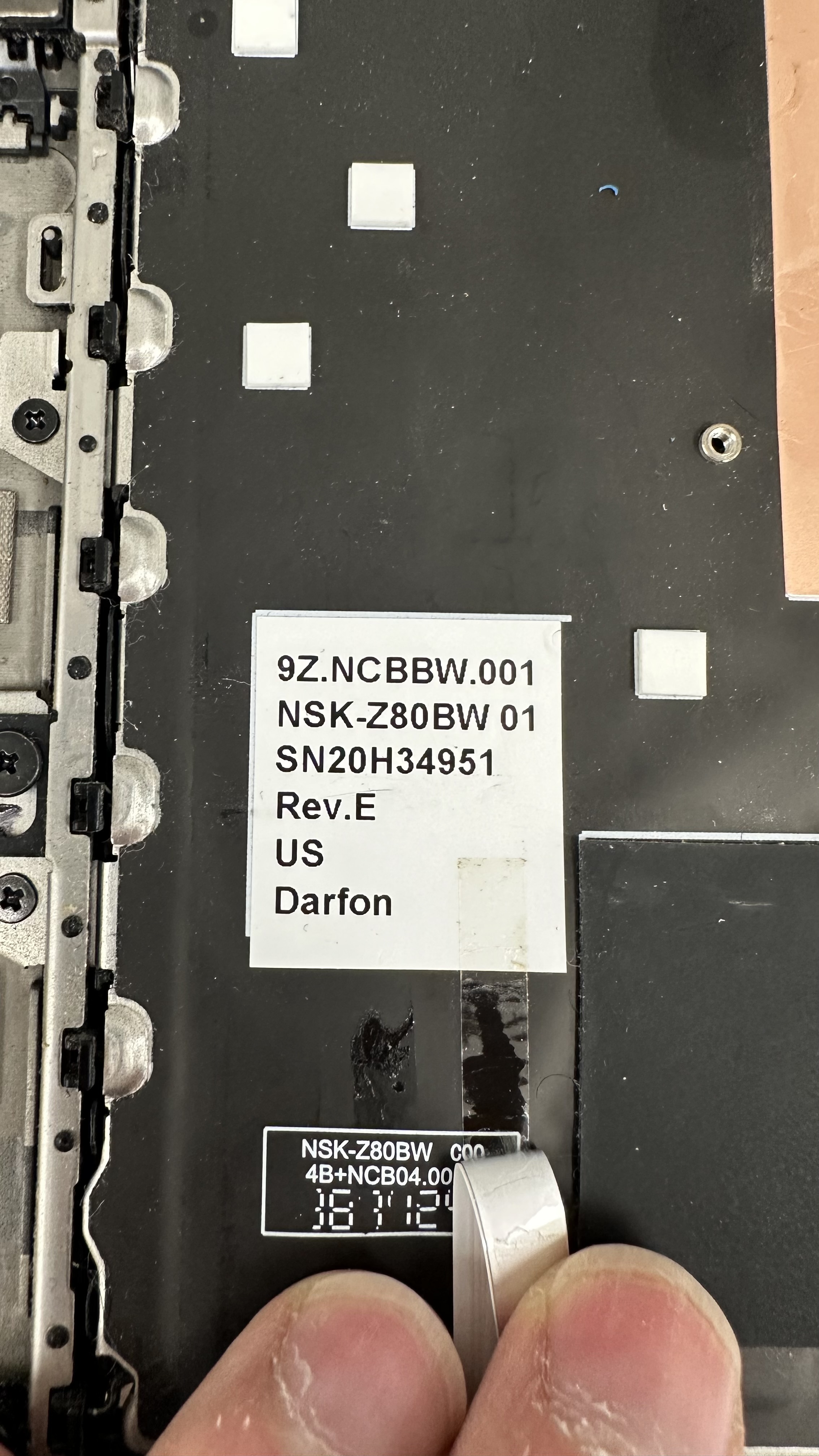

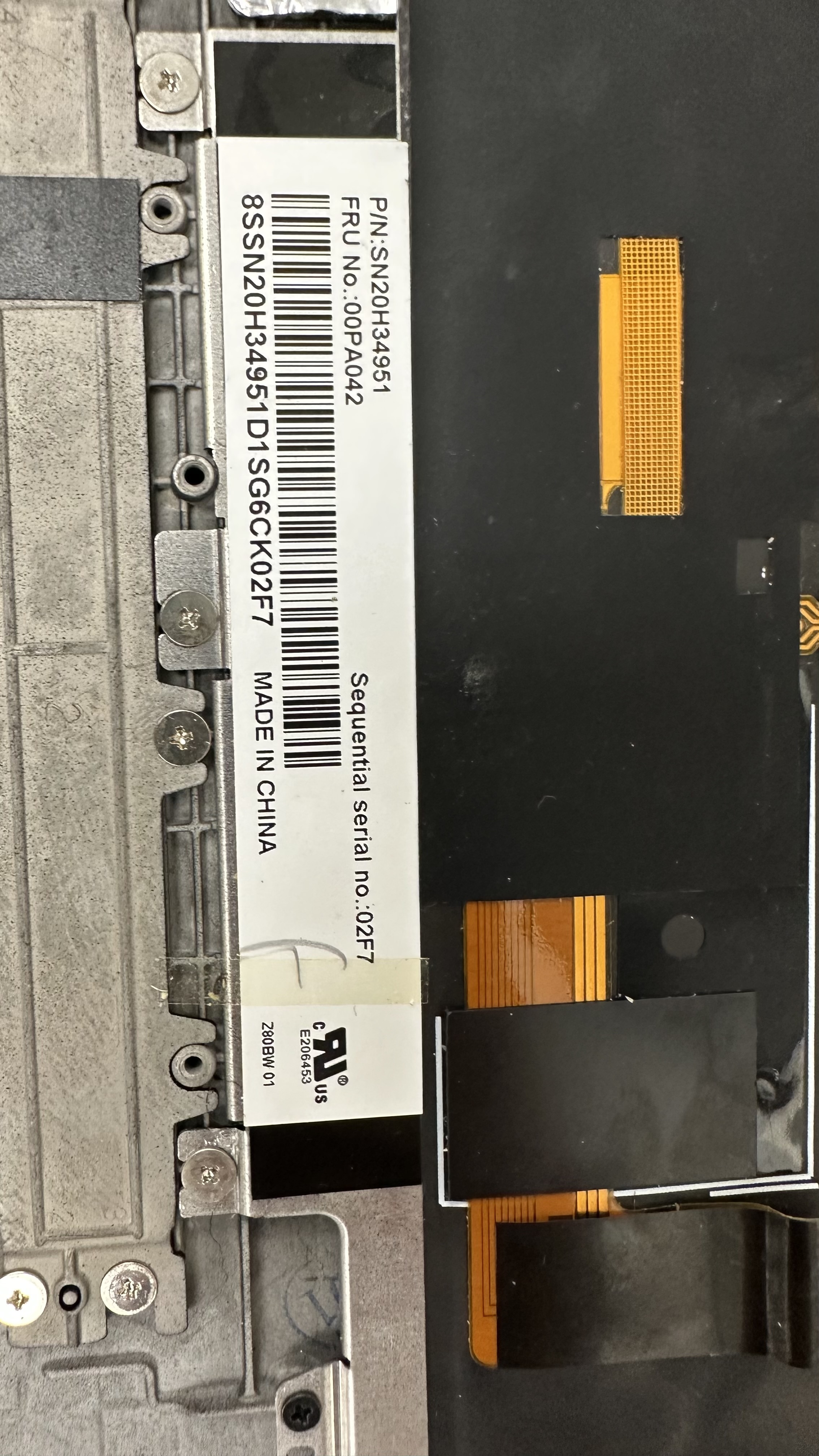

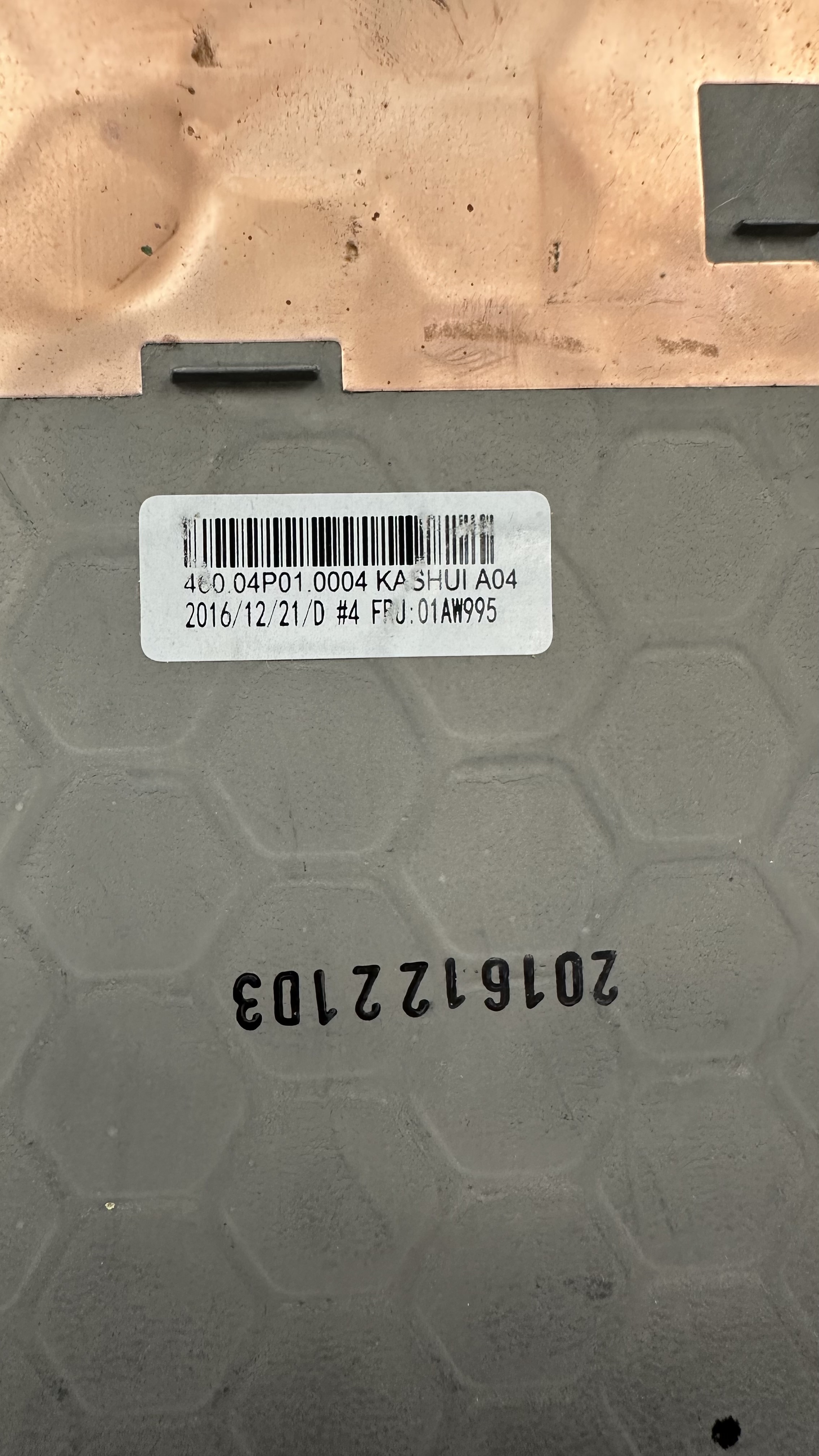

      These are the only things I found that could be related to the serial number. Can’t figure out which one.
      • danito
        • Jun 2016
        • 1101
        • Romania
        #3483
        Originally posted by Mehmet Korhan
        These are the only things I found that could be related to the serial number. Can't figure out which one.
        https://www.ifixit.com/Guide/Lenovo+...acement/126756
        • Mehmet Korhan
          • May 2024
          • 31
          #3484
          The sticker for the serial is missing on the back cover.
