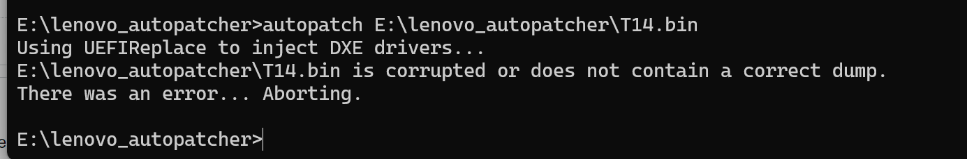

                                    Get some error like this, xx.bin is corrupted..
