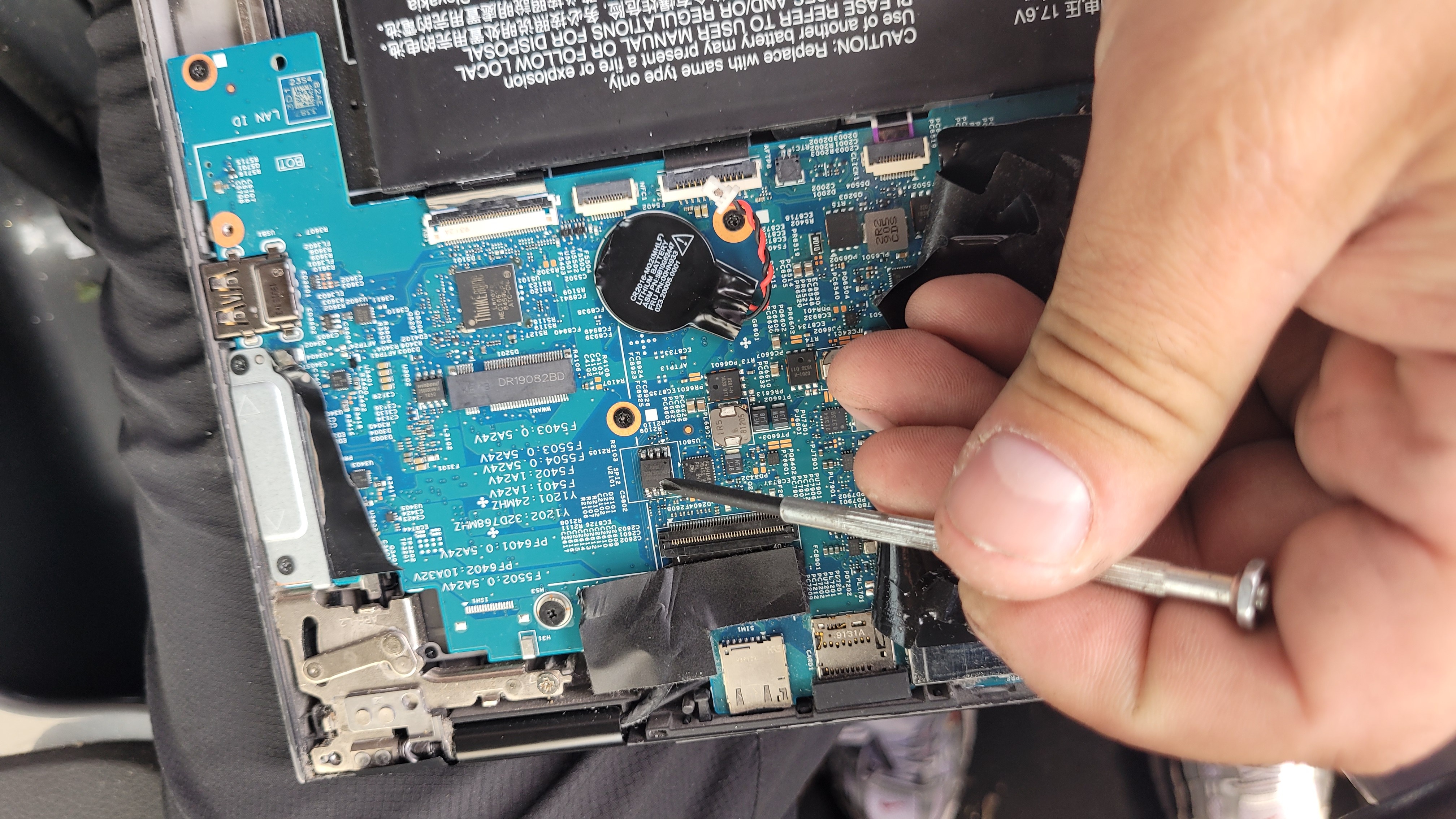

                        #3271
                        This is my second laptop on segoday that i put on my blades . lenovo thinkpad x1 yoga gen 3.
                        Sending the files of the second laptop that I read and patched . Black screen and not even the lights are on
                        eprom w25Q128
                        Can you please see what the problem is?
                        I have laptops in the same condition . Doesn't respond to power like it's dead
                        Maybe my steps were not correct : 1.I disconnected the battery
                        2.Unplugged the bios.
                        3. I soldered the eeprom chip
                        4. I read it, saved it and wrote it.
                        All!!!! It never turned on again
                        to read eprom I use programmer vvde and proc but maybe I need to use another programmer ch341a
                        Please give advice on which direction to look for a solution to the problem
                        Even without eprom computer lit up and turned on, fans were spinning, lights were on but as soon as I installed flashed eprom two computers stopped responding to power "zero reaction". Now even if I solder out the eprom the laptops remain dead.

                          #3272
                          Originally posted by Knucklegrumble
                          lenovo_autopatcher_0.2.zip
                          [ HOW TO USE THE PATCH ]
                          STEP 1: Flash and replace current BIOS with the generated patch file
                          STEP 2: Boot the machine
                          STEP 3: Press ENTER/F1/etc. to enter BIOS settings
                          STEP 4: Enter any character when asked for Supervisor Password
                          STEP 5: Press enter when it shows Hardware ID
                          STEP 6: Press space bar 2x when asked
                          STEP 7: Turn off machine
                          STEP 8: Restore original BIOS
                          STEP 9: Reset BIOS settings to factory default
                          Thank you, and enjoy!
                          Download -> https://www.badcaps.net/filedata/fetch?id=3166264
                          After Step 7, I was having issues restoring the original bios. I tried another CH341 programmer to no avail. I have blank checked and verify that the chip is identical to the file I am flashing it with. If needed the original bios and the patched bios are below. Also is it possible that I could've damaged the traces with the chip? What happens after flashing would just be a blank screen without sound, just lights and it would boot loop.

                            Post the laptop serial numbers please --> https://www.badcaps.net/forum/troubl...before-posting

                              #3274
                              20LE-S0HQ0B
                                SMDFlea commented
                                Editing a comment
                                Not the model type, the serial number
