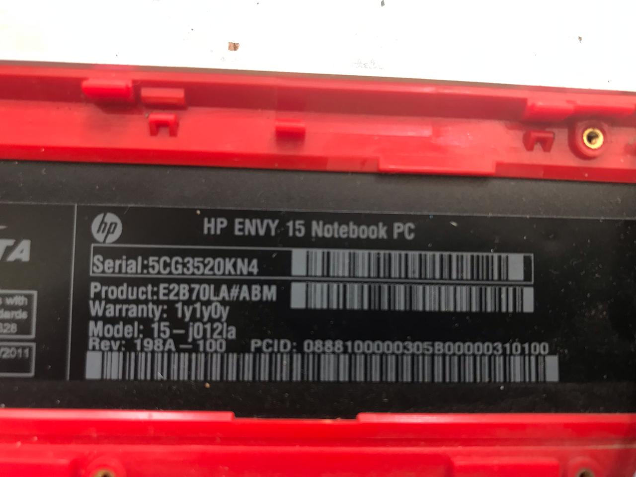

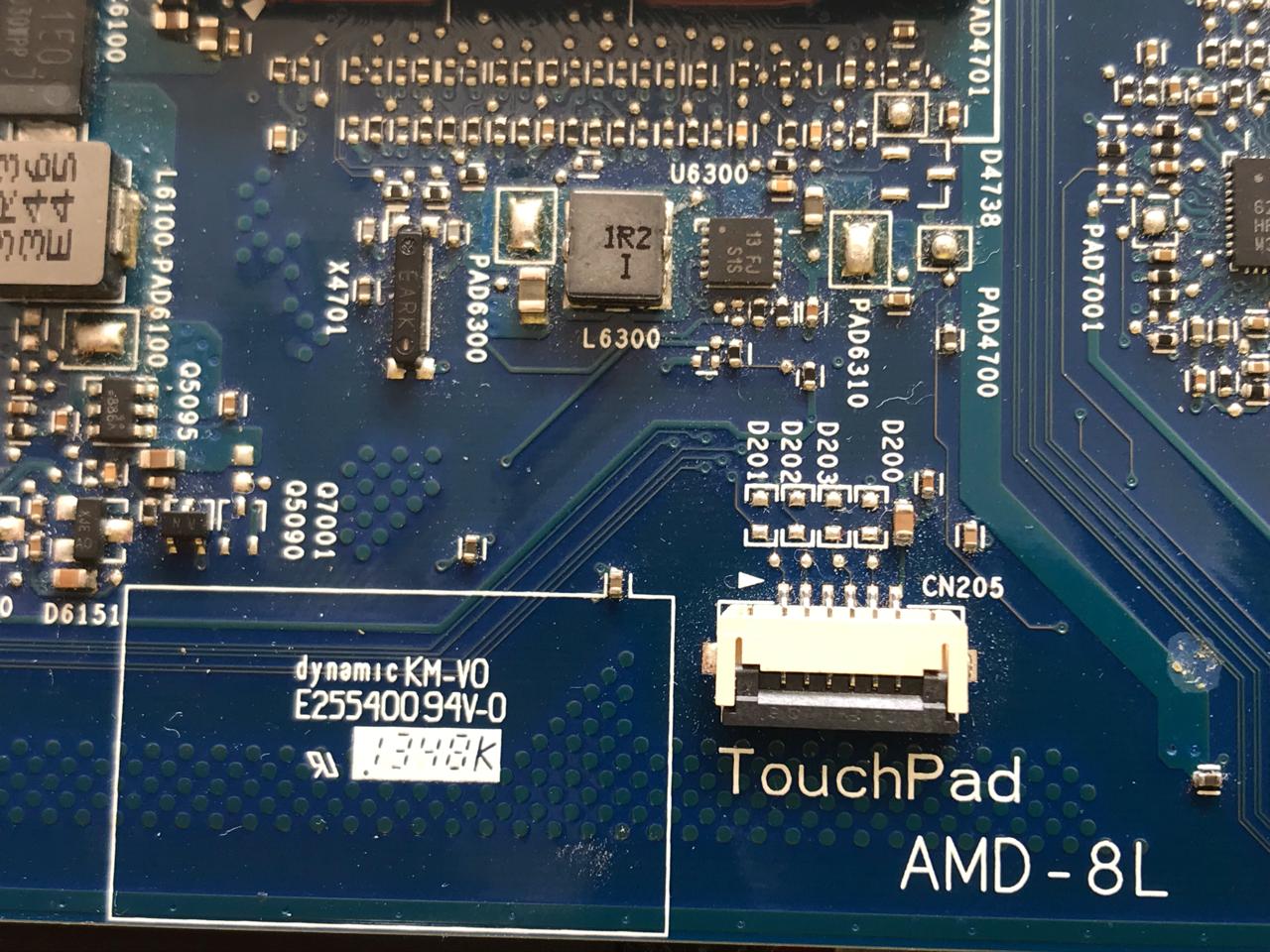

    Help friends with this bios envy 15 j012la without video, Dynamic KM-V0 E25540094V-0 motherboard, attached my dump and the information of the equipment.

    Try this bios,extracted from hp bios update. In your picture i can see some liquid spill just above where the AMD-8L is , clean it up make sure the trace is ok .

      Excelent thanks laptop ok work. Smdflea master
