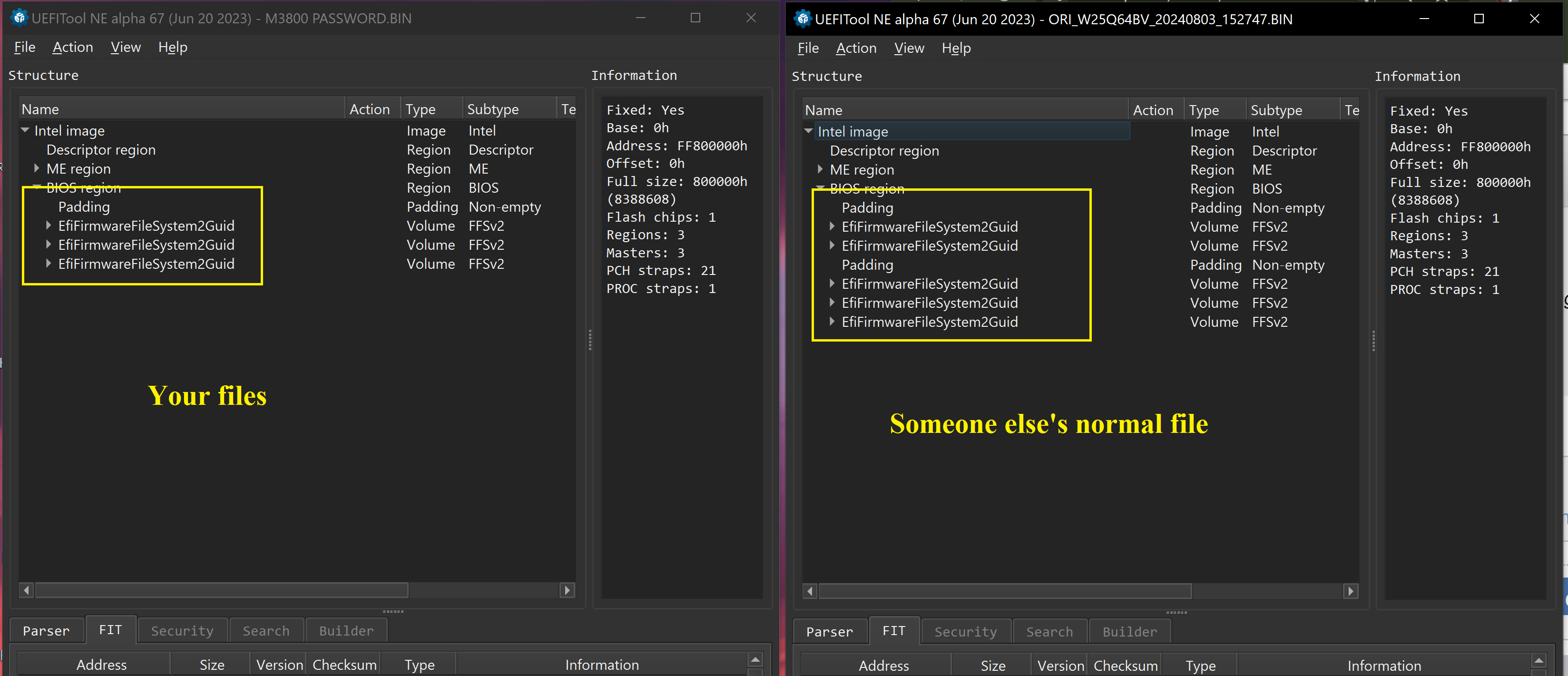

dell precision m3800 with a locked bios
  • Trisnaadi
    • May 2017
    • 11
    • Indonesia
    #201
    TRY: SKUDER1
    Hi thanks so much, this password works!
    Thank you 😊
    • volinakis
      • Jan 2021
      • 2874
      • N/A
      #202
      Originally posted by Trisnaadi
      Hi thanks so much, this password works!
      Thank you 😊
      you are welcome
      • Trisnaadi
        • May 2017
        • 11
        • Indonesia
        #203
        Originally posted by evserv
        password: 342E16D5
        Thank you so much for helping, unfortunately the password is not working, but good news is other user help me with another password and it works.
        Thank you
        • evserv
          • Jun 2014
          • 362
          • Russia
          #204
          I gave you the correct password. It is entered in small letters. I don't know where you made a mistake.
          • ali akbar
            • Apr 2017
            • 45
            • bangladesh
            #205
            hi dell p M3800 bios pw.sirvice tag-JD2QT32.pls help
            • Albias
              • Aug 2024
              • Liethuania
              #206
              i need BIOS pasword for Alienware m17 R4
              System Disable: 82************
              Service Tag: G*********
                SMDFlea commented
                Editing a comment
                Off topic, the thread is only for the M3800
            • iandek
              • Sep 2024
              • 3
              #207
              I need the password for M3800, tag 9VSJYZ1 pls.
              • kalilinux25
                • Mar 2018
                • 2089
                • ZAMBOANGA SIBUGAY
                #208
                Originally posted by iandek
                I need the password for M3800, tag 9VSJYZ1 pls.
                RULES UPDATE for BIOS requests/offers AVOID BANNING, READ BEFORE POSTING
                https://www.badcaps.net/forum/troubl...before-posting
                Please follow this format
                issue:
                Model:
                Serial Number:
                Motherboard Code:
                Post your backup bin even its corrupted
                • iandek
                  • Sep 2024
                  • 3
                  #209
                  Ok, no probs; I figured out what the password was so don't need it anymore. Thanks.
                  • evserv
                    • Jun 2014
                    • 362
                    • Russia
                    #210
                    Originally posted by ali akbar
                    hi dell p M3800 bios pw.sirvice tag-JD2QT32.pls help
                    password: CD04656A
                    • bitmosco1
                      • May 2019
                      • 9
                      • nigeria
                      #211
                      PLS CAN SOMEONE HELP ME TO UNLOCK MY DELL PRECISION M3800
                      SERVICE TAG 3TFGD12
                      • hoaca388
                        Badcaps
                        • Jan 2022
                        • 12354
                        #212
                        Originally posted by bitmosco1
                        PLS CAN SOMEONE HELP ME TO UNLOCK MY DELL PRECISION M3800
                        SERVICE TAG 3TFGD12
                        Read chip again.
                        • bitmosco1
                          • May 2019
                          • 9
                          • nigeria
                          #213
                          2ND READ
                          • hoaca388
                            Badcaps
                            • Jan 2022
                            • 12354
                            #214
                            Originally posted by bitmosco1
                            2ND READ
                            Read again.
                            • quangtuyen
                              • Jan 2023
                              • Viet Nam
                              #215
                              HI BR HELP ME DELL 3800 PASSWORK
                              SVTAG: CV2TY52
                              • hoaca388
                                Badcaps
                                • Jan 2022
                                • 12354
                                #216
                                Originally posted by quangtuyen
                                HI BR HELP ME DELL 3800 PASSWORK
                                SVTAG: CV2TY52
                                Where is your dump ?
                                • evserv
                                  • Jun 2014
                                  • 362
                                  • Russia
                                  #217
                                  Originally posted by quangtuyen
                                  HI BR HELP ME DELL 3800 PASSWORK
                                  SVTAG: CV2TY52
                                  password: 38AD620E
                                  • retrooo
                                    • Mar 2017
                                    • 93
                                    • mexico
                                    #218
                                    Hi guys i have one precision m3800 that has locked bios i need help unlocking it ,thanks in advance
                                    M3800
                                    Service tag:BOWYG72
                                    • volinakis
                                      • Jan 2021
                                      • 2874
                                      • N/A
                                      #219
                                      Originally posted by retrooo
                                      Hi guys i have one precision m3800 that has locked bios i need help unlocking it ,thanks in advance
                                      M3800
                                      Service tag:BOWYG72
                                      Password is: 123123
                                      • retrooo
                                        • Mar 2017
                                        • 93
                                        • mexico
                                        #220
                                        Password is: 123123
                                        Thank you work at first try!!!
                                        i have some skills using hex and uefi tools ,can you point me to how to do it myself and help other users?
                                        • trix11
                                          Dell Precision T1650 MT Workstation bricked after BIOS update
                                          by trix11
                                          I have a Dell Precision T1650 MT workstation (of the following spec.) that was bricked yesterday when attempting to update the BIOS from A27 to A28 per:
                                          - https://www.dell.com/support/home/en...-t1650/drivers > Dell Precision T1650 System BIOS
                                          - Dell Precision T1650 mid tower Workstation
                                          - Xeon E3-1225 V2
                                          - 32Gb PC3-12800E RAM
                                          - 4Tb SATA HDD
                                          - motherboard: Dell part: 0C3YXR CN-0C3YXR-72200-39C-01GR-A02
                                          I see now that others have experienced like issues e.g.:
                                          - https://www.dell.com/community/Prec...
                                          10-24-2022, 10:35 PM
                                        • MMH3
                                          Dell Precision 3450 small form factor - BIOS cannot be opened in FIT - please help clean
                                          by MMH3
                                          i would appreciate, if someone could help me.
                                          DELL: 3450 sff
                                          Servicetag: (!) obviously FAKE - ABC2345
                                          Mainboard: 0GK35Y - serial /ABC2345/CNFCW0023800L6/
                                          Chipset: Intel W580 (Rocket Lake PCH-H)
                                          BIOS: 1.34.1
                                          ME: 15.0.50.2633
                                          mor data can be found the HW-Info-data in the rar-file
                                          I have this BIOS from a DELL Precision 3450 SmallFormFactor mainboard i bought refurbished.. from china.
                                          The board itself works without any issues.
                                          My goal was to clean the ME of this and fully...
                                          09-13-2025, 11:54 PM
                                        • bmxlovah
                                          Dell Precision T7910 no bios, no post after applying SAS/RAID setup
                                          by bmxlovah
                                          My Dell Precision T7910 died after enabling onboard SAS controller and applying RAID settings. There were no hardware changes between working and not working state, only setup (via bios -> controller settings). After applying settings and reboot PC turns on, flash leds (normally) but there's no further action, it just stays on with no graphics and no keyboard led's on. There's no Dell logo, nothing. I've tried resetting bios by jumper, replacing cpu's, replacing ram, removed/replaced cmos battery, disconnecting all drives etc. I've also dumped .bins from mobo chips SLI1 (16...
                                          11-24-2022, 06:29 AM
                                        • zenius
                                          by zenius
                                          12-08-2024, 06:13 AM
                                        • cozily
                                          DELL Precision 3660 Tower Workstation BIOS
                                          by cozily
                                          I bought a DELL Precision 3660 Tower Workstation from a second-hand seller. After bringing it home, I found out it was actually a testing unit. The BIOS cannot be upgraded (only the ME and PD2 sections are upgradable), and there are test messages displayed during boot, which really affects the user experience.
                                          Upon inspecting the motherboard, I noticed that the BIOS is composed of two chips: one 8-pin 16MB chip and one 16-pin 32MB chip.
                                          I acquired two new chips from another source containing the official BIOS version, but after installing them, I found that none of the...
                                          07-09-2025, 08:43 PM
