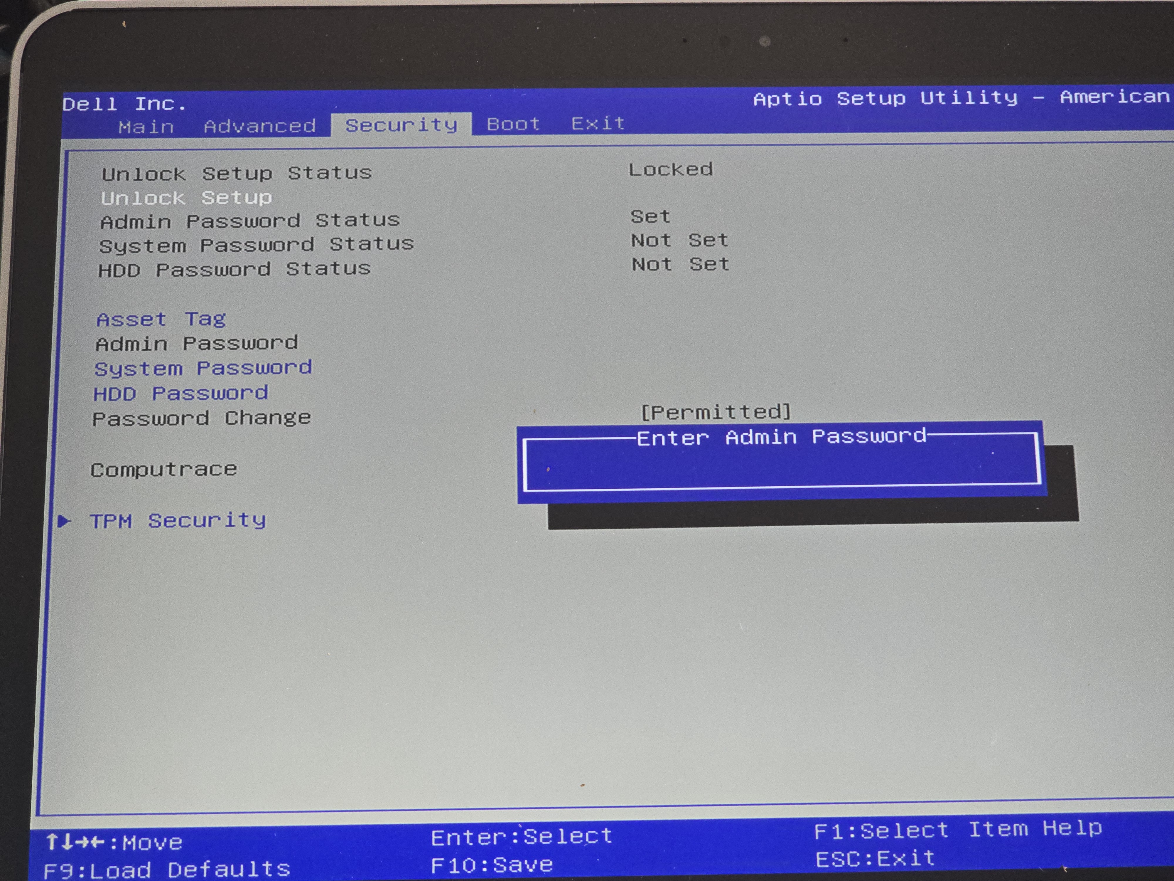

dell precision m3800 with a locked bios
  • mariusz9220
    • Jul 2025
    • 5
    • Poland
    #241
    Originally posted by peste
    The bios chip must be unsoldered from the board before writing or reading..
    do not use the clip, you may have errors..if you do not have anything to unsolder it with,
    solder wires between the programmer and the bios chip..
    you need an SPI programmer...here is a video for example..https://www.youtube.com/watch?v=DWWi...nnel=ThisIsHow
    Sorry for writing post-under-post.
    I have made a dump of my BIOS with Intel Flash Programming Tool. I think this one will be much more useful.
    BIOS .BIN file is in attachment
    Thank You
    • volinakis
      • Jan 2021
      • 2874
      • N/A
      #242
      Originally posted by mariusz9220
      Sorry for writing post-under-post.
      I have made a dump of my BIOS with Intel Flash Programming Tool. I think this one will be much more useful.
      BIOS .BIN file is in attachment
      Thank You
      try:
      AGA
      • mariusz9220
        • Jul 2025
        • 5
        • Poland
        #243
        try:
        AGA
        WORKED ! 😀 THANK YOU VERY MUCH BRO !
        • igalex796
          • Dec 2024
          • 3
          • mexico
          #244
          I need password, how can i get it
          • volinakis
            • Jan 2021
            • 2874
            • N/A
            #245
            Originally posted by igalex796
            I need password, how can i get it
            post serial no. as in rules of this forum.
            • igalex796
              • Dec 2024
              • 3
              • mexico
              #246
              Sorry my bad JW6NY52 M3800 pass unlock pls
              • volinakis
                • Jan 2021
                • 2874
                • N/A
                #247
                Originally posted by igalex796
                Sorry my bad JW6NY52 M3800 pass unlock pls
                pass is:
                LINUX
                • Dragonlee
                  • Jul 2025
                  • 2
                  • Vietnam
                  #248
                  Hi everyone, I have a dell precision m3800 with a locked BIOS. I need someone to help me to unlock it.
                  SERVICE TAG: B7W4662,
                  EXPRESS SERVICE: 24421811258
                  • peste
                    • Dec 2016
                    • 13695
                    • ROMANIA
                    #249
                    Originally posted by Dragonlee
                    Hi everyone, I have a dell precision m3800 with a locked BIOS. I need someone to help me to unlock it.
                    SERVICE TAG: B7W4662,
                    EXPRESS SERVICE: 24421811258
                    post the original contents of the bios chip..
                    • evserv
                      • Jun 2014
                      • 362
                      • Russia
                      #250
                      Originally posted by igalex796
                      Sorry my bad JW6NY52 M3800 pass unlock pls
                      JW6NY52 password: FCF610DB
                      • evserv
                        • Jun 2014
                        • 362
                        • Russia
                        #251
                        Originally posted by Dragonlee
                        Hi everyone, I have a dell precision m3800 with a locked BIOS. I need someone to help me to unlock it.
                        SERVICE TAG: B7W4662,
                        EXPRESS SERVICE: 24421811258
                        B7W4662 password: F648CBE9
                        • Dragonlee
                          • Jul 2025
                          • 2
                          • Vietnam
                          #252
                          Originally posted by evserv
                          B7W4662 password: F648CBE9
                          Wow, password is correct. Great, thanks so much 😍
                          • mindawgas
                            • Feb 2021
                            • 11
                            • United kingdom
                            #253
                            Hi, ive also need admin bios password for M3800, got the original file too.
                            Service tag: JSS4Z52
                            Express service code: 43099178726
                            • peste
                              • Dec 2016
                              • 13695
                              • ROMANIA
                              #254
                              Originally posted by mindawgas
                              Hi, ive also need admin bios password for M3800, got the original file too.
                              Service tag: JSS4Z52
                              Express service code: 43099178726
                              try..
                              • mindawgas
                                • Feb 2021
                                • 11
                                • United kingdom
                                #255
                                Absolutely no change, here is the pic
                                • hoaca388
                                  Badcaps
                                  • Jan 2022
                                  • 12356
                                  #256
                                  Originally posted by mindawgas
                                  Absolutely no change, here is the pic
                                  [ASSWORD1 ( US twerty )
                                  or
                                  PASSWORD1
                                  • mindawgas
                                    • Feb 2021
                                    • 11
                                    • United kingdom
                                    #257
                                    It worked! Much appreciated help from you guys 👍👍👍
                                    • Alexarte
                                      • Jul 2025
                                      • 4
                                      • Serbia
                                      #258
                                      Servisna oznaka B7HDYZ1 on the screen
                                      JC4TWZ1 service tag on the back of the laptop
                                      Expres Servisni kod 42092572717
                                      Prijenosno računalo m-3800
                                      Please helpService mark B7HDYZ1 on the screen
                                      JC4TWZ1 service tag on the back of the laptop
                                      Express Service code 42092572717
                                      Portable computer m-3800
                                      Please help
                                      in English please..
                                      Last edited by Alexarte; 07-27-2025, 12:21 AM.
                                      • peste
                                        • Dec 2016
                                        • 13695
                                        • ROMANIA
                                        #259
                                        Originally posted by Alexarte
                                        Servisna oznaka B7HDYZ1 on the screen
                                        JC4TWZ1 service tag on the back of the laptop
                                        Expres Servisni kod 42092572717
                                        Prijenosno računalo m-3800
                                        Please helpService mark B7HDYZ1 on the screen
                                        JC4TWZ1 service tag on the back of the laptop
                                        Express Service code 42092572717
                                        Portable computer m-3800
                                        Please help
                                        in English please..
                                        What can we help you with? What's your problem?
                                        post the contents of the bios chip even if it is corrupted..
                                        • Alexarte
                                          • Jul 2025
                                          • 4
                                          • Serbia
                                          #260
                                          My bios is locked
                                          Service tag B7HDYZ1 on display
                                          JC4TWZ1 service tag on the back of the laptop
                                          Express Service code 42092572717
                                          Portable computer m-3800
                                          Please help
                                          • trix11
                                            Dell Precision T1650 MT Workstation bricked after BIOS update
                                            by trix11
                                            I have a Dell Precision T1650 MT workstation (of the following spec.) that was bricked yesterday when attempting to update the BIOS from A27 to A28 per:
                                            - https://www.dell.com/support/home/en...-t1650/drivers > Dell Precision T1650 System BIOS
                                            - Dell Precision T1650 mid tower Workstation
                                            - Xeon E3-1225 V2
                                            - 32Gb PC3-12800E RAM
                                            - 4Tb SATA HDD
                                            - motherboard: Dell part: 0C3YXR CN-0C3YXR-72200-39C-01GR-A02
                                            I see now that others have experienced like issues e.g.:
                                            - https://www.dell.com/community/Prec...
                                            10-24-2022, 10:35 PM
                                          • MMH3
                                            Dell Precision 3450 small form factor - BIOS cannot be opened in FIT - please help clean
                                            by MMH3
                                            i would appreciate, if someone could help me.
                                            DELL: 3450 sff
                                            Servicetag: (!) obviously FAKE - ABC2345
                                            Mainboard: 0GK35Y - serial /ABC2345/CNFCW0023800L6/
                                            Chipset: Intel W580 (Rocket Lake PCH-H)
                                            BIOS: 1.34.1
                                            ME: 15.0.50.2633
                                            mor data can be found the HW-Info-data in the rar-file
                                            I have this BIOS from a DELL Precision 3450 SmallFormFactor mainboard i bought refurbished.. from china.
                                            The board itself works without any issues.
                                            My goal was to clean the ME of this and fully...
                                            09-13-2025, 11:54 PM
                                          • bmxlovah
                                            Dell Precision T7910 no bios, no post after applying SAS/RAID setup
                                            by bmxlovah
                                            My Dell Precision T7910 died after enabling onboard SAS controller and applying RAID settings. There were no hardware changes between working and not working state, only setup (via bios -> controller settings). After applying settings and reboot PC turns on, flash leds (normally) but there's no further action, it just stays on with no graphics and no keyboard led's on. There's no Dell logo, nothing. I've tried resetting bios by jumper, replacing cpu's, replacing ram, removed/replaced cmos battery, disconnecting all drives etc. I've also dumped .bins from mobo chips SLI1 (16...
                                            11-24-2022, 06:29 AM
                                          • zenius
                                            by zenius
                                            12-08-2024, 06:13 AM
                                          • cozily
                                            DELL Precision 3660 Tower Workstation BIOS
                                            by cozily
                                            I bought a DELL Precision 3660 Tower Workstation from a second-hand seller. After bringing it home, I found out it was actually a testing unit. The BIOS cannot be upgraded (only the ME and PD2 sections are upgradable), and there are test messages displayed during boot, which really affects the user experience.
                                            Upon inspecting the motherboard, I noticed that the BIOS is composed of two chips: one 8-pin 16MB chip and one 16-pin 32MB chip.
                                            I acquired two new chips from another source containing the official BIOS version, but after installing them, I found that none of the...
                                            07-09-2025, 08:43 PM
