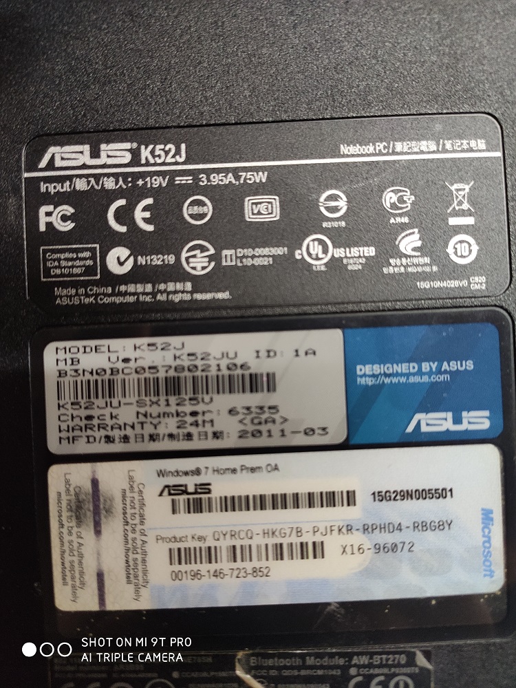

    Good day Sir any one have this bios for this pc

      good day i as doing a usb bios update and the power as cut in de end off the update i dont have any backup.

        Ok so the bios will be corrupt,you need to backup the corrupt bios and post it here. You will need an SPI bios programmer.If you can`t desolder the chip you also need a sop8 clip .

          a have fash this bios on the chip but isnt the original and have any luck.

            When you tried to flash it, hopefully it retained the DMI info ,serial number and the MAC address.If you post your bios backup as suggested the bios can be fixed.

              I made a dump off the data on the chip

                  this is the actual backup off the pc

                    read post #8 again.You have a bios programmer ? ,if so what model is it, have you desoldered the bios chip or are you using a sop8 clip ??????.

                      I am using a using a sop8 clip

                        good day is i have the bios programer that you mentioned in the previous post i dint have the backup bios the file i have put in the forum are from wen i try to prog the chip original bios tha i have take from asus support for my notebook.

                          The clips are not very good,its easy to lose the connection.You will get a better backup if you can desolder the chip. The first bios you posted is seriously corrupt,because you`re using a clip,you should get a better backup than that.Hold the clip down with your hand,make another 2 backups !!! ,post them .

                            Tanks for our help i found a bios and ist now working id the same fault , it shut down in bios do to overheat in the cpu.

                              Ok, you can`t fix them all. Can you post the bios you found,it might help someone else.

                                I found this bios and fix my bios problem.
