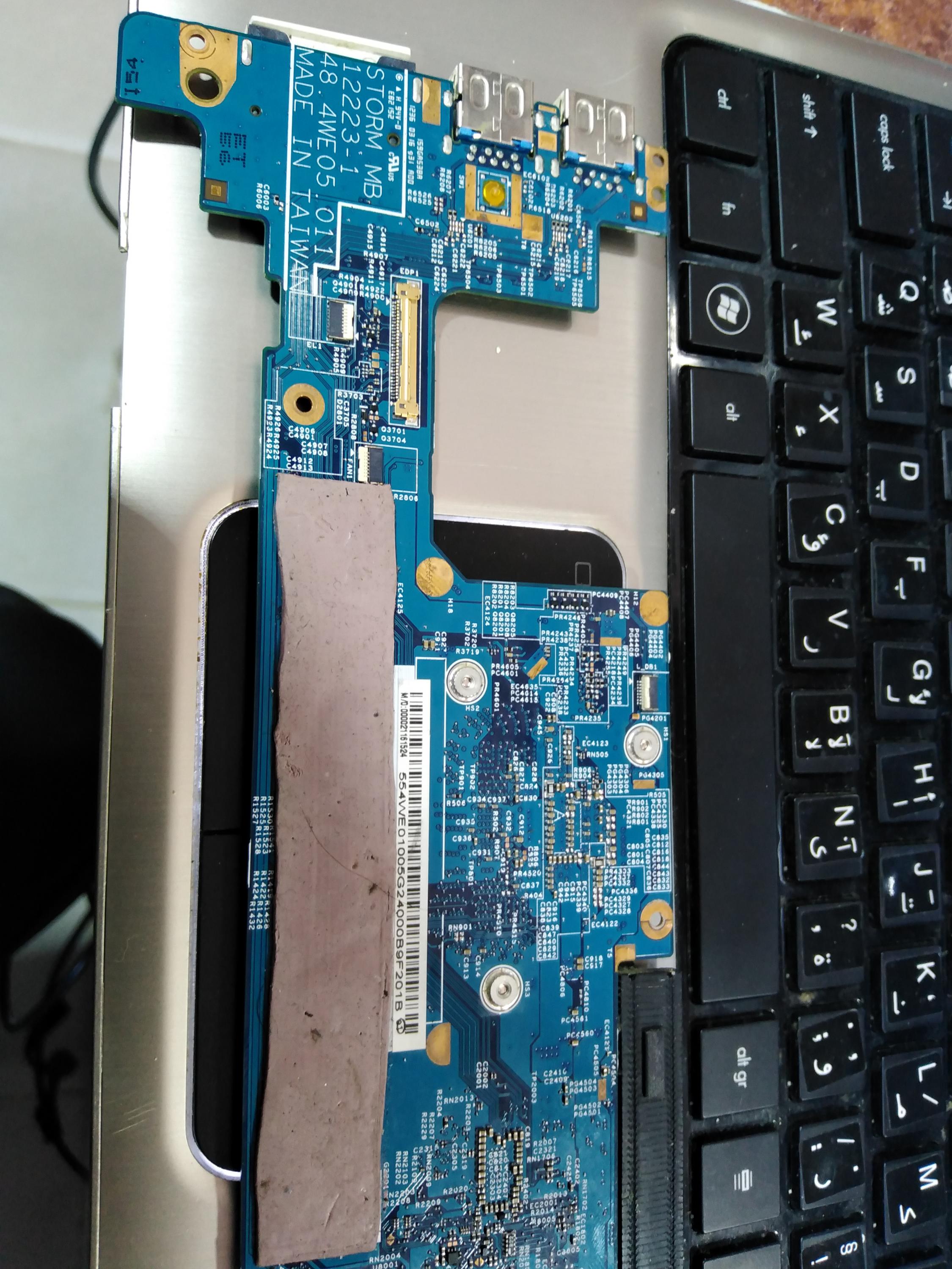

                      hello guys i need file bin
                      storm mb 12223-1 48.4we05.011
                      .. Thanks
                      • hardware1
                        • Sep 2021
                        • 2949
                        • N/A
                        Re: I need bios Acer s7-391-53334g12aws
                        .. Thanks
                        Upload your Original Backup, and write your Device Serial Number.
                          This BackUp
                          This Image And Serial Number
                            • 22120
                            This BackUp
                            write your Device Serial Number, the one on the case sticker
                            • hardware1
                              • Sep 2021
                              • 2949
                              • N/A
                              This BackUp
                              You should have another Bios Chip (2MB), upload it too.
                              Also confirm this Serial Number from your Laptop Back Cover: NXM3EEF001243097C32000.

                                  Use files attached in posts #2 and #6, replace DMI and Windows key (in 4MB dump) using offsets:
                                  DMI: 23000 - 230FF
                                  Windows key: 30C000 - 30C03F

                                    Can you explain me how to do that?
                                    • Vesko356
                                      VIP Moderator
                                      • Aug 2018
                                      • 4386
                                      • Bulgaria πŸ‡§πŸ‡¬
                                      Using simple hex editor like HxD for example, and offsets mentioned in my previous post.
