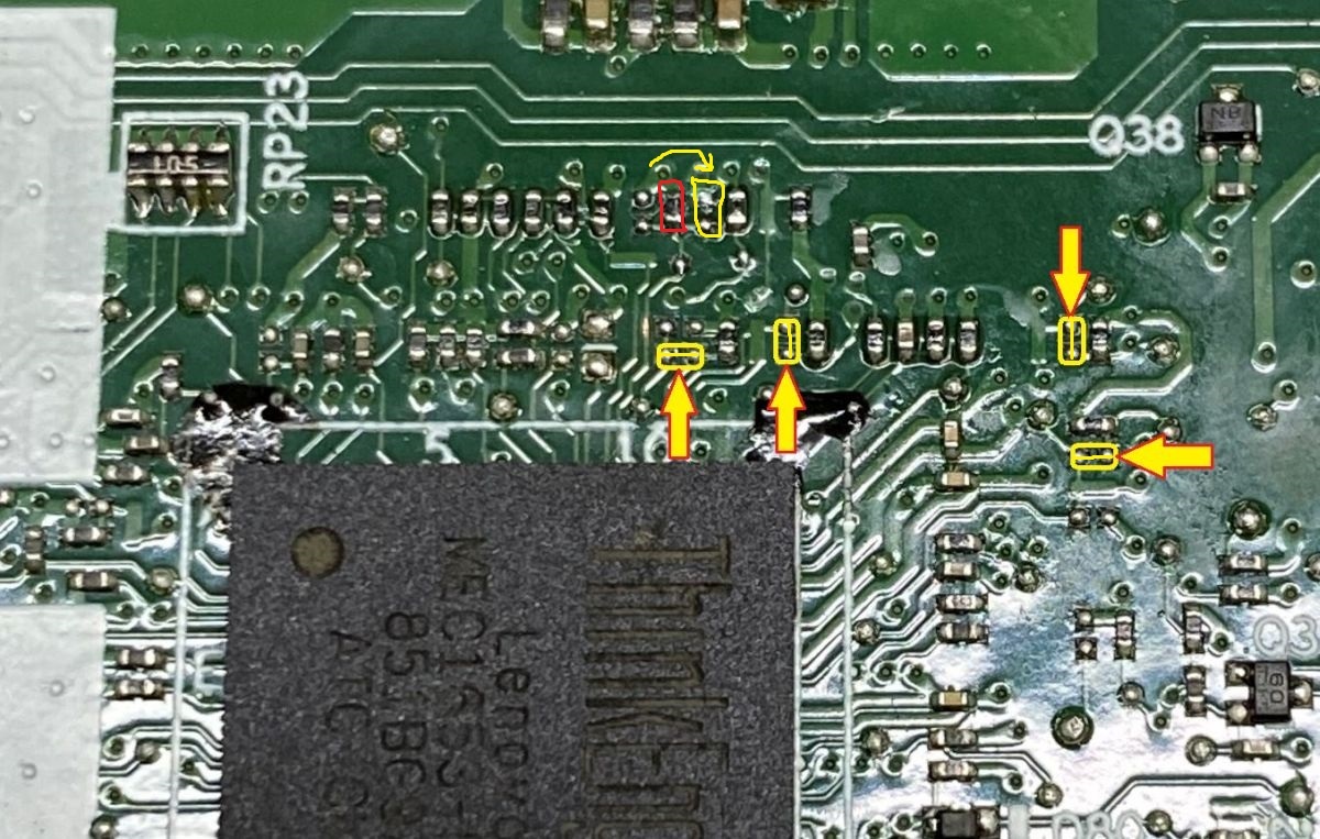

                        #31
                        ThinkPad P52 NM-B562
                        ​for someone who need information
                        32 mb bios you must read write mec1653. 1 resistor switch 4 jumper wire.

                          #32
                          How can you read and write MEC1653? Where is the JTAG ports? I have T580 LTS-2 17812-1 board and cannot find the JTAG to work with the MEC
