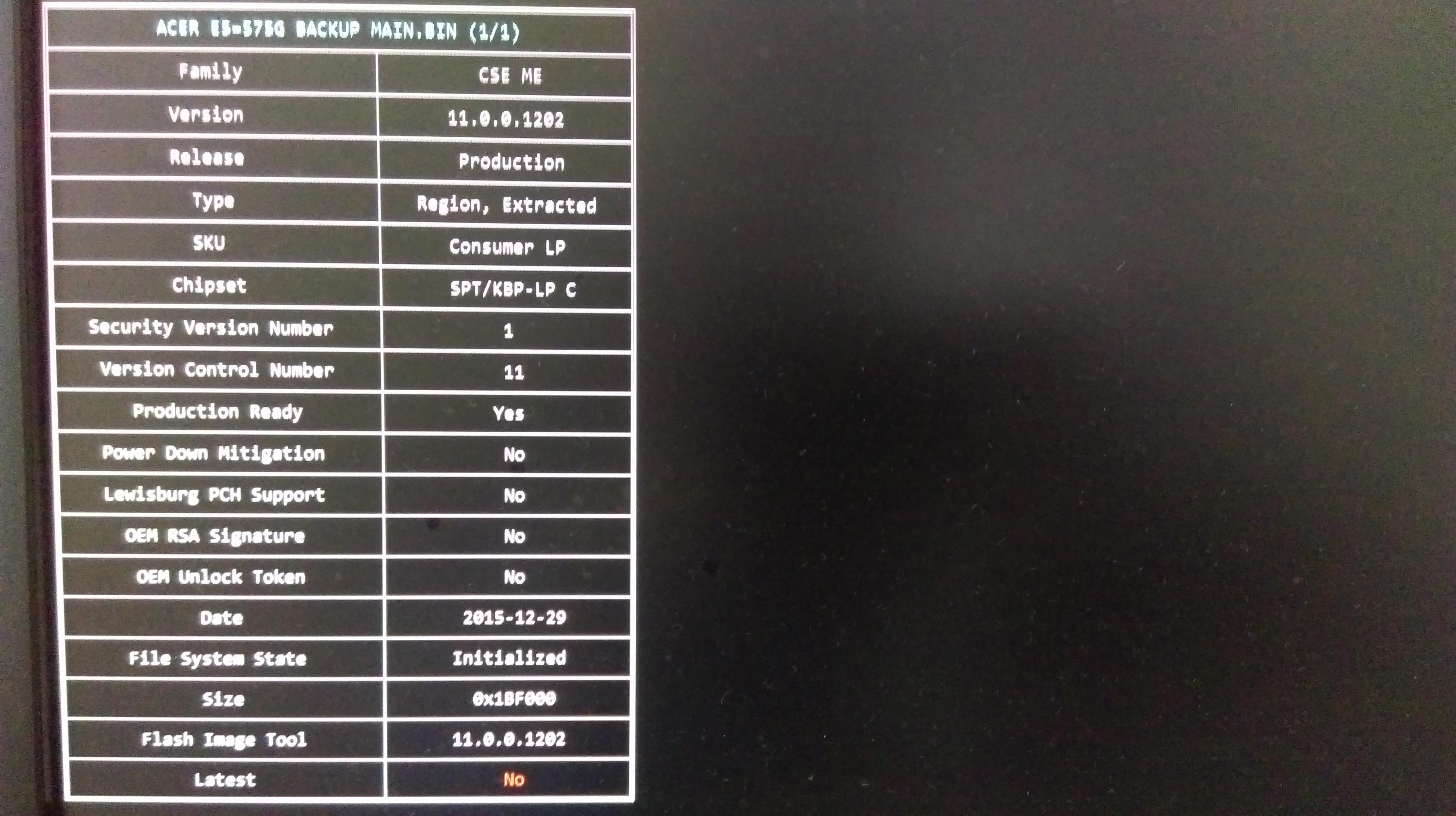

    I Have acer E5-575G DAZAAMB16E0 REV: E QUANTA ZAAA.The problem it takes 15seconds to display the acer logo and stock on logo, I have attached the backup dump, can someone please fix this

    Re: Acer e5-575g need to fix bios
    try...
      @peste i check you bios uploaded not the same ME on the original. original has 10 you uploaded has 11 please help
          thanks problem solved! flashed with your file
