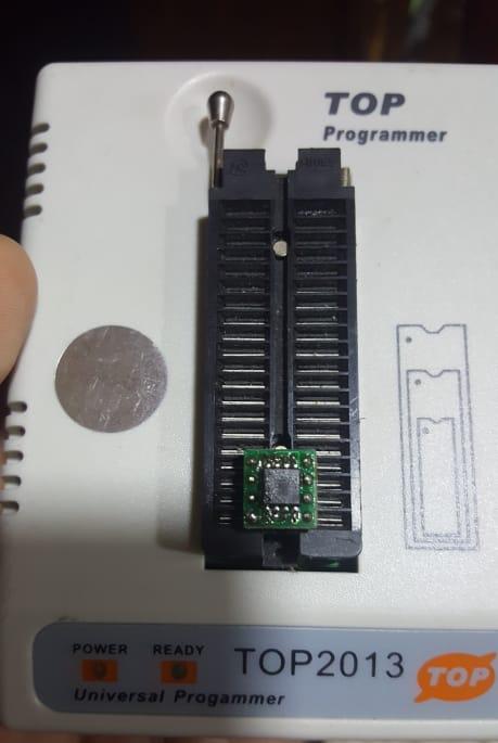

                      #30
                      Re: HP ZBook 17 G2 Locked BIOS Dump
                      hello.
                      i took time to order for a programmer and wait for the delivery.
                      i have used top programmer 2013.
                      the chip which i have is winbond 25Q16QVSIQ 1515 .
                      it is quite different from the other thread published here the 25Q128.
                      the thread is encripted twice.
                      here is the thread of the bios backup.
                      thank you for the help.

                          #32
                          Originally posted by Red Octopus
                          Hello I have posted the backup.
                          Originally posted by Vesko356
                          W25Q128XXXXX is 128 Megabits flash memory chip = 128 Megabits (Mb) = 16,384 KiloBytes (KB)
                          So the bios bin file for your machine must be 16,384 KB.
                          25Q16QVSIQ is not the right chip > Search the motherboard for the location of the correct (128 Mb) bios chip > dump (and verify) the content of the chip and upload the resulting file here > someone will edit the file to remove the password for you > you'll write back the edited file to the chip> password removed > happy end (of story).
                          Understand?
